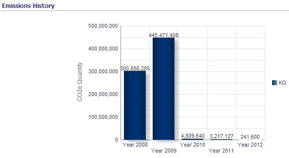

Emissions History is a graphical representation of the history of the carbon emissions by the organization.

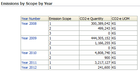

Emissions by Scope by Year report is a tabular representation of the emissions of the organization by scope for the selected year.
Year Number
Emission Scope is the scope of the emissions by the organization.
CO2-e Quantity is the quantity of emissions by the organization.
CO2-e UOM is the unit of measure in which the emissions are measured.

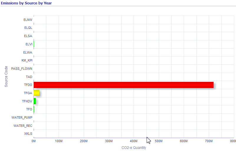

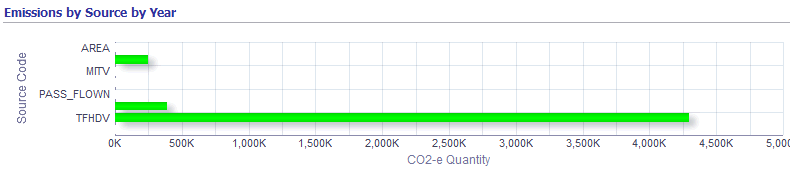

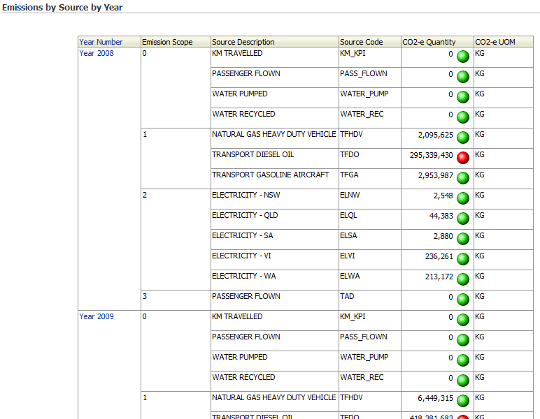

Emissions by Source by Year report is a tabular representation of the emissions of the organization by source for the selected year.
Year Number
Source Description is a brief description of the source of emissions.
Source Code is the code for the source of the emissions.

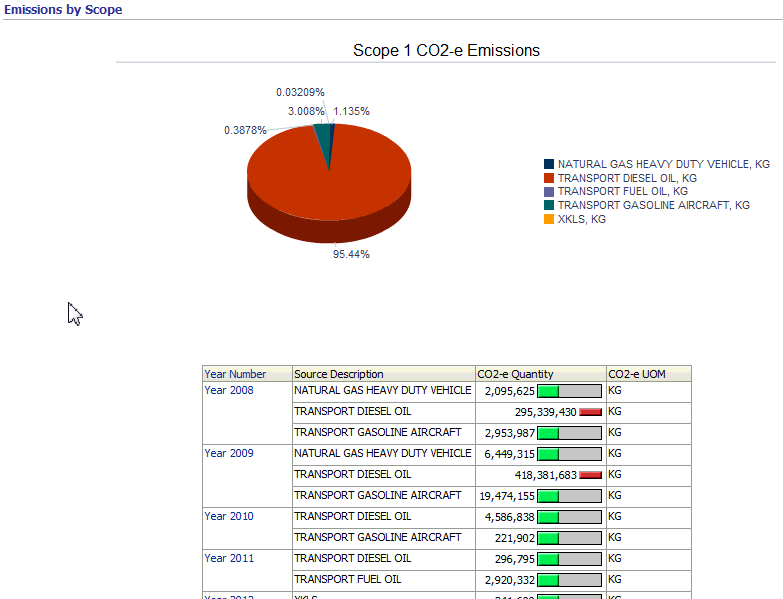

The following reports display in the Emissions by Scope Tab. These reports display 3 times total, once each for Levels 01, 02, and 03:
Emissions by Scope report is a graphical representation of the emissions of the organization by scope for the selected year.
The emission data also displays in a tabular report with the following fields:
Year Number

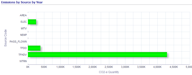

The following reports display in the Emissions by Source Tab:
Emissions by Source report is a graphical representation of the emissions of the organization by source. You can select the year and an emission for which you want to view the emissions. The emission data also displays in a table report with the following fields:
Year Number
Source Description is a brief description of the source of the emissions.
Source code is the code for the emission source.

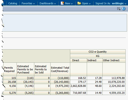

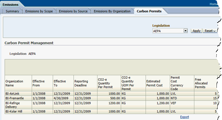

The Carbon Permits tab displays a table of environmental organizations with carbon permits listed by legislation. You can view the carbon permits for one or more legislations at a time by optionally selecting specific legislations. If you do not select a legislation, then the carbon permits for all legislations display.
Additional Information: For more information about carbon permits, see: Setting Up Carbon Permit Management.
The Carbon Permits tab is shown below, in two parts.

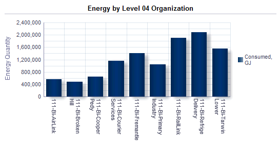

Use the Energy dashboard to assess the energy performance, water efficiency, and carbon emissions within your company's organization hierarchy. The following tabs displays the energy consumed in different ways:
Summary
Energy by Scope
Energy by Source
Energy by Organization
Energy by Organization Type

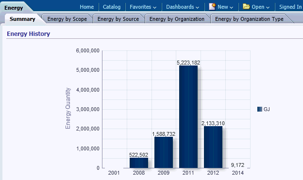

To view the Energy History, Energy by Scope by Year, and Energy by Source by Year reports
Navigate to OBIEE Dashboards. Click Energy. The Summary tab appears, displaying the Energy History, Energy by Scope by Year, and Energy by Source by Year reports.
The Energy History report displays the history of the energy consumed by the organization.
In the Year field, select one or more years to display. Click Apply.

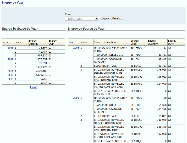

The Energy by Scope by Year report displays a tabular representation of the energy of the organization by scope for the selected years.
The Energy by Source by Year report displays a tabular representation of the energy of the organization by source for the selected years.

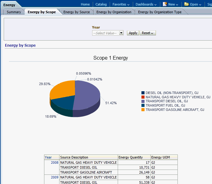

To view the Energy by Scope reports
Navigate to OBIEE Dashboards. Click Energy. Click the Energy by Scope tab. The Energy by Scope page appears.
In the Year field, select a year to display. Click Apply.

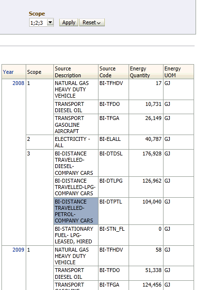

The following Energy by Scope graphs and tables display the energy of the organization by scope for the selected year:
Scope 1 Energy
Scope 2 Energy
Scope 3 Energy

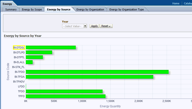

To view the Energy by Source reports
Navigate to OBIEE Dashboards. Click Energy. Click the Energy by Source tab. The Energy by Source by Year page appears.
In the Scope field, select one or more of the scopes to display. Click Apply.
The Energy by Source by Year graph displays the energy of the organization by source. The associated table displays the energy of the organization by source and scope..

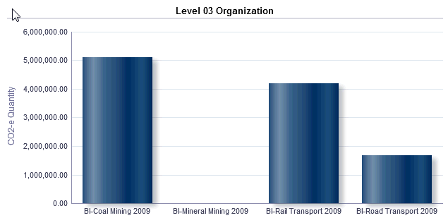

Energy by Level 01 Organization Type
Energy by Level 02 Organization Type
Energy by Level 03 Organization Type
Energy by Level 04 Organization Type
For each graph, click on a particular area of the stacked bar chart.
A drill-down report of that area displays in tabular format.

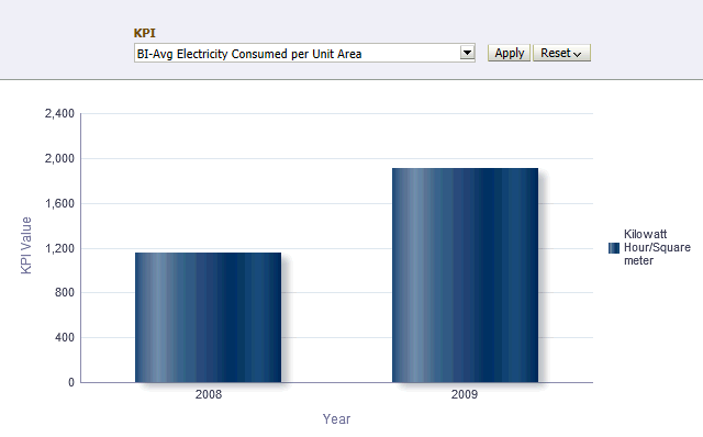

To view the KPI Metrics page
Navigate to the OBIEE Dashboards. Click Metrics. Click the KPI Metrics subtab. The KPI Metrics page appears.
Select the KPI and the Year for which you want to view the metrics. The following reports display:
A bar chart displays the KPI values for the organization for the selected year.

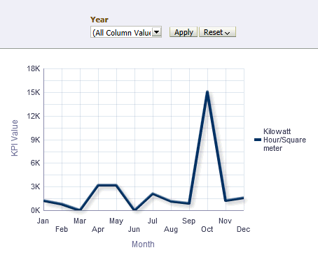

A graph displays the KPI values for the organization across the months of the selected year.

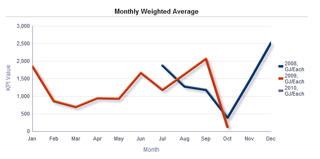

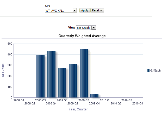

To view the KPI Metrics Weighted Average page
Navigate to the OBIEE Dashboards. Click Metrics. Click the KPI Metrics Weighted Average subtab. The KPI Metrics Weighted Average page appears.
A bar chart displays the yearly weighted average of the KPI value for the selected year.
A bar chart displays the quarterly weighted average of the KPI value for the selected year.
Tip: Alternatively, view the KPI quarterly weighted averages as a line graph by selecting Line Graph from the View field.
A line graph displays the monthly weighted average of the KPI value for the selected year.

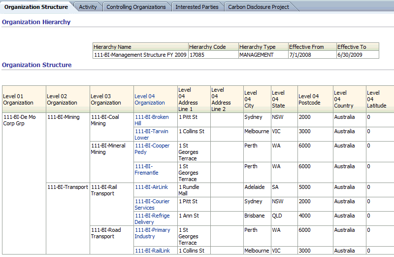

The following reports display for the organization in the Organization Structure tab:
Organization Hierarchy: The report displays the following fields:
Hierarchy Name is the name of the organizational hierarchy.
Tip: The default Hierarchy Name values are 01 Level Organization, 02 Level Organization, 03 Level Organization, and 04 Level Organization for the four levels of the Organization Structure, but you can rename these levels to meet your business needs.
Hierarchy Code is the code for the organizational hierarchy
Hierarchy is the type of the organizational hierarchy.
Effective From is the date from which the organizational hierarchy is effective.
Effective To is the date to which the organizational hierarchy is effective.
Organization Structure: The report displays the Name, Address, GPS co-ordinates, and the Industry Group Codes for the top four levels of the organization. You can click on the name of a level 4 organization to view details of further levels of the organization hierarchy.

The following report displays for the organization in the Interested Parties tab. Select the Year and the Interested Organization (facility) from the LOV for which you want to view activity details. The Interest Type displays. All organizations that are defined as Interested Parties in the organization setup display in the LOV.
Activities: The report displays a list of all activities of the facility that the Interested Organization has interest in depending on their effective dates of interest:
State is the name of the state in which the facility is located.
Month
Emission Scope is the scope for the emissions by the facility.
Source Code is the code for the emissions source.
Source Description is a brief description of the emissions source.
Activity Type Description is a description of the activity type.
Parent Source Description
Child Source Description
Measurement Criteria
Usage Quantity is the quantity of the source used by the facility.
Usage UOM is the unit of measure in which the source usage quantity is measured.

Emissions History is a graphical representation of the history of the carbon emissions by year for the organization.

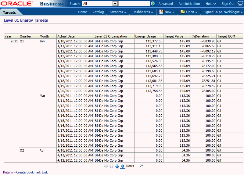

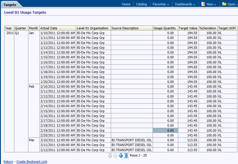

The Targets Dashboard provides reports that display environmental data versus targets established for the selected organizations. The actual results and targets display by month for the selected years. Organizations can use these reports to measure and track against their sustainability goals. Use the following tabs to view actual results versus targets:
Energy - displays actual energy used by organization level versus the targets established for the selected organizations in GJ. The energy usage and targets display by month for the selected years.
Emissions - displays actual emissions by organization level versus the targets set for the selected organizations in KG of CO2-e. The emissions and targets display by month for the selected years.
Usage - displays actual energy used by organization level versus the targets established for the selected organizations and parent source in the target unit of measure. The usage and targets display by month for the selected years and, if desired, parent source.
For more information about setting the energy, emission, and usage, refer to Setting Up Organizations.

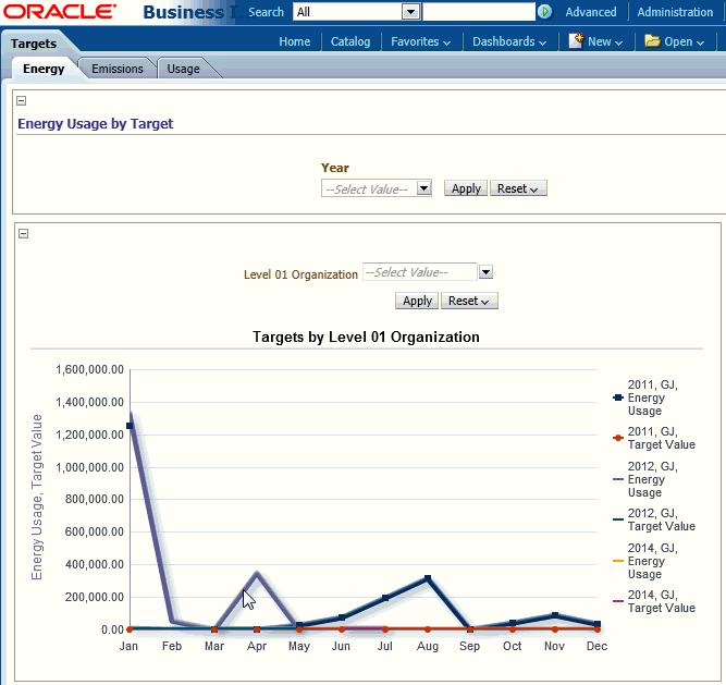

To view the Energy Usage by Target page
Navigate to OBIEE Dashboards. Click Targets. Click the Energy tab. The Energy Usage by Target page appears.
The following Energy Usage by Target graphs display energy usage in GJ:
Targets by Level 01 Organization
Targets by Level 02 Organization
Targets by Level 03 Organization
Targets by Level 04 Organization
For each graph, select one or more organizations to display. Click Apply.
Select Search to use search criteria to narrow the list of organizations available for selection.
Click on the data label for a graph to display the graph details in a table format.

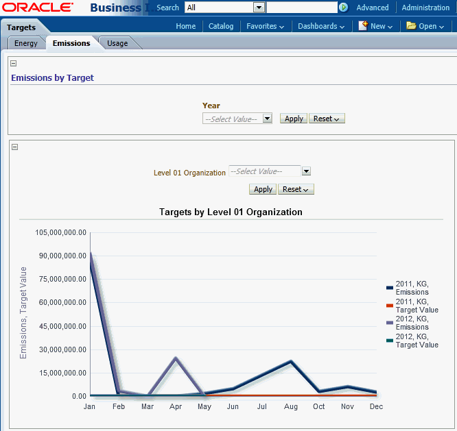

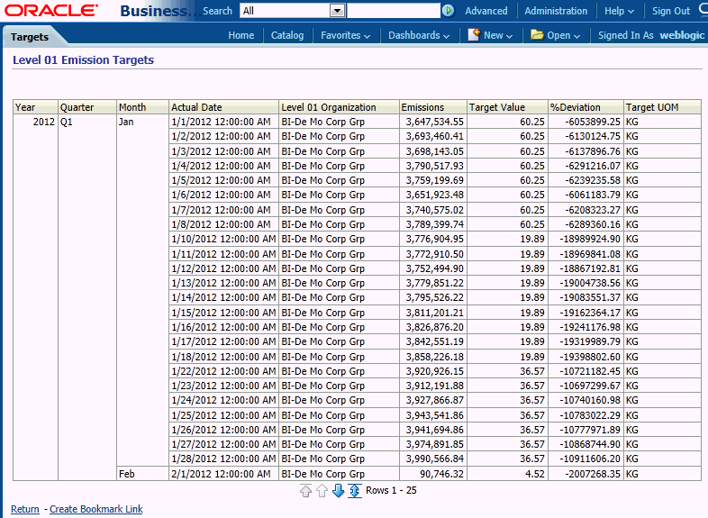

To view the Emissions by Target page
Navigate to OBIEE Dashboards. Click Targets. Click the Emissions tab. The Emissions by Target page appears.
The following Emissions by Target graphs display emissions in KG of CO2-e:

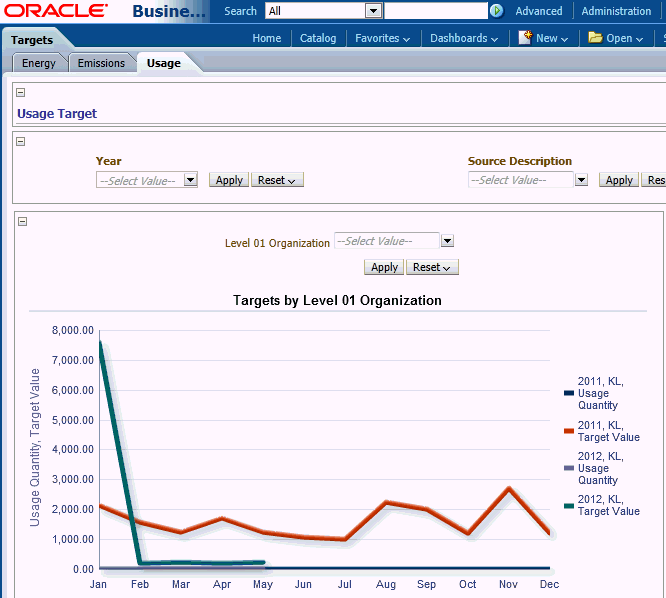

To view the Usage Target page
Navigate to OBIEE Dashboards. Click Targets. Click the Usage tab. The Usage Target page appears.
In the Parent Source field, select one or more parent sources to display. Click Apply.
The following Usage Target graphs display energy usage by parent source, year, and organization level in GJ:

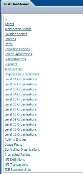

System Administrators use the Test dashboard to review the data collected from source systems and stored in the data warehouse. The Test dashboard provides reports for the following entities:
Assets
Transaction Details
Emission Scopes
Sources
Items
Reporting Periods
Source Applications
Subcontractors
Suppliers
Transactions
Organization Hierarchies
Level 01 Organizations
Level 02 Organizations
Level 03 Organizations
Level 04 Organizations
Level 05 Organizations
Level 06 Organizations
Level 07 Organizations
Level 08 Organizations
Level 09 Organizations
Level 10 Organizations
Level 11 Organizations
Level 12 Organizations
Activity Entities
Usage Facts
Controlling Organizations
Interested Parties
KPI Definitions
KPI Transactions
JDE Business Units

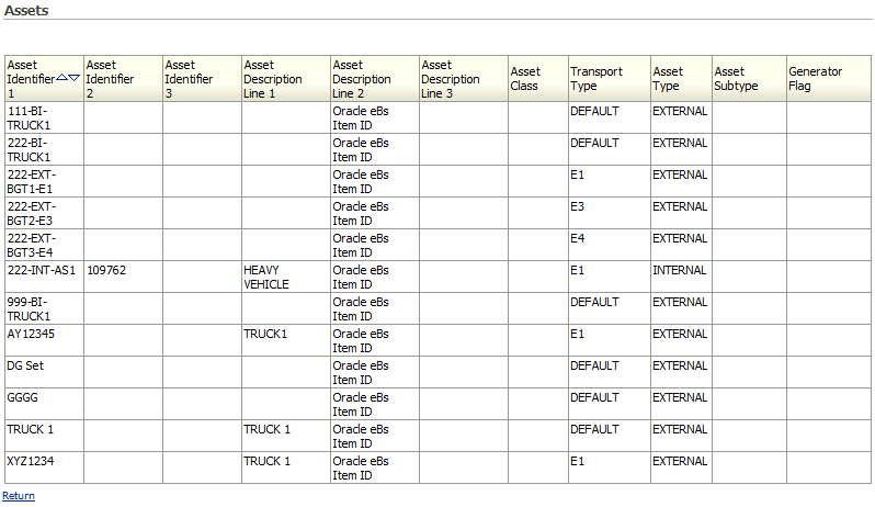

Clicking on the link for a data entity provided on the dashboard, such as Emission Scopes, displays the report for the data element in a new page. If the source for the data warehouse is Oracle E-Business Suite (EBS), then the following links on the Test dashboard, which are irrelevant for Oracle EBS, do not show results:
Source Application
Subcontractor
JDE Business Units
System Administrators can use the Test dashboard to verify the accuracy of the data, for debugging, and for troubleshooting.
To view the Test Dashboard page
Navigate to OBIEE Dashboards. Click Test Dashboard.
The Test Dashboard page appears.
Select one of the report links (Assets, Transaction Details, and so on).
The report displays the data for the entity selected in a new page.
Optionally, click Export and choose whether to export this report to Excel, PowerPoint, or PDF format.

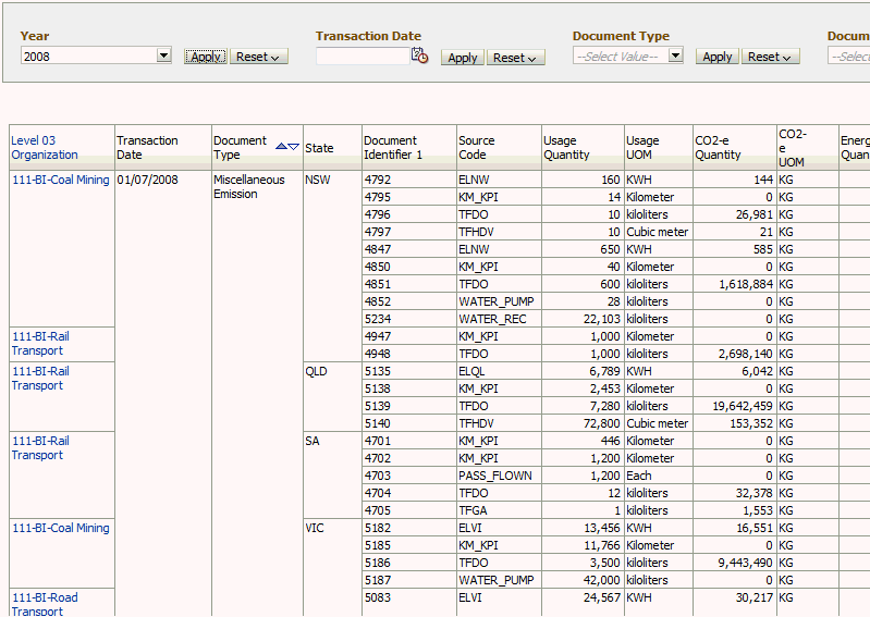

The Transactions dashboard lists the transactions of an organization by day and organization and also displays the usage and emissions data for each transaction
To view the Transactions dashboard
Navigate to the OBIEE Dashboards. Click Transactions. The Transactions page appears.
Select no criteria to display all the results. Select any of the following search criteria to narrow your results:
Year to display transactions in a specific year.
Transaction Date to display transactions on a specific date.
Document Type is the type of transaction document.
Document Identifier is the code for the transaction document.
State to display transactions in a specific state.
Source to display a particular, active environmental source.
Level 03 Organization to display a particular level 03 organization in the default organization hierarchy.
Click Go. The following fields display:
Level 03 Organization is the name of the organization at the level 3 of the organization hierarchy.
Transaction Date is the date of the transaction.
Document Type
State is the state in which the Level 03 Organization is located.
Document Identifier
Source code is the code for the emissions source.
Usage Quantity is the quantity of the source used in the transaction.
Usage UOM is the unit of measure in which the usage quantity is measured.
CO2-e Quantity is the quantity of carbon equivalent emissions due to the transaction.
CO2-e UOM is the unit of measure in which the CO2-e quantity is measured.
Energy Quantity is the amount of energy consumed in the transaction.
Source Type is type of source used in the transaction.
Energy UOM is the unit of measure in which the energy quantity is measured.

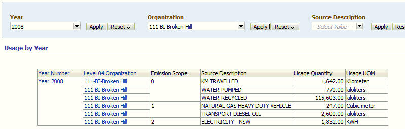

The Usage dashboard displays the source usages for a facility by year and by source.
To view the Usage dashboard
Navigate to the OBIEE Dashboards. Click Usage. The Usage page appears.
Year to display source usages for a facility in a specific year.
Level 04 Organization to display source usage for a specific facility.
Source Description to display usage for a specific source.
Year Number
Level 04 Organization is the name of the facility.
Emission
Source Description is a brief description of the source.

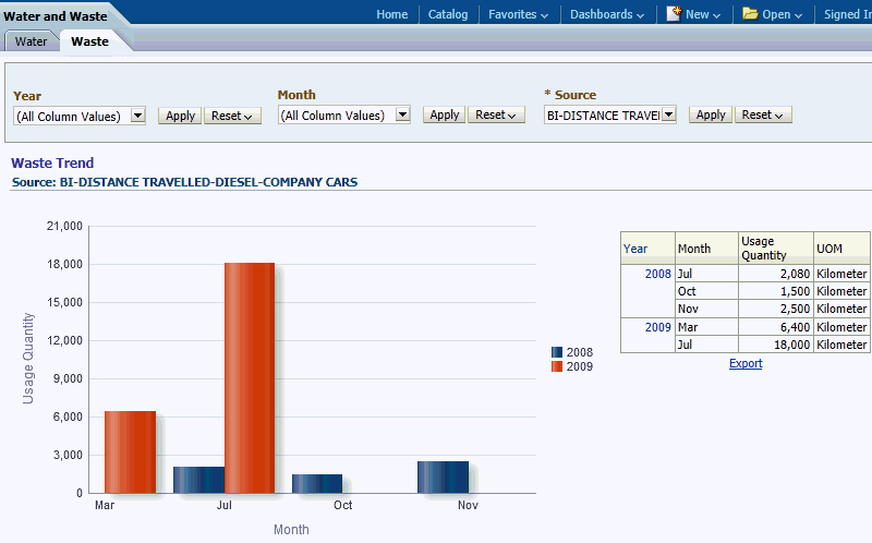

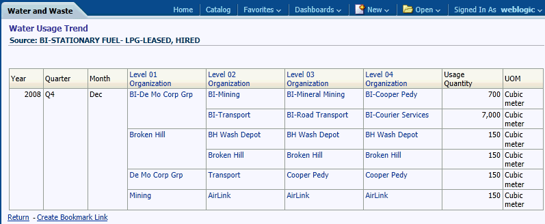

The Water and Waste Dashboard has two tabs, Water and Waste. Select one of the tabs to view charts and reports displaying the usage by year, month, and source.
Prerequisites
To view the Water and Waste Dashboard
Navigate to the OBIEE Dashboards. Click Water and Waste. The Water and Waste page appears.

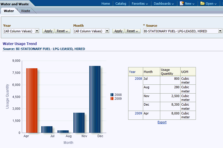

To view water usage
Select the Water tab to view the following reports:
Water Usage Trend bar chart
Water Usage Trend tabular report
Select no criteria to display all of the results. Select any of the following search criteria to narrow your results:
Year to display water usage in one or more specific years.
Month to display water usage for one or more specific months within one or more years.
Source to display water usage for one or more specific sources included in the Water source category.
Optionally, click Export and choose whether to export this report in Excel, PowerPoint, or PDF format.
Click on one of the bars in the Water Usage Trend bar chart to drill down to a detailed report of water usage quantity by month, source, and Level 01 - 04 organizations.

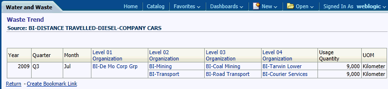

To view waste created and recycled
Select the Waste tab to view the following reports:
Waste Trend bar chart
Water Trend tabular report
Year to display waste generated in one or more specific years.
Month to display waste for one or more specific months within one or more years.
Source to display water usage for one or more specific sources included in the Waste source category.
Click on one of the bars in the Waste Trend bar chart to drill down to a detailed report of waste quantity by month, source, and Level 01 - 04 organizations.

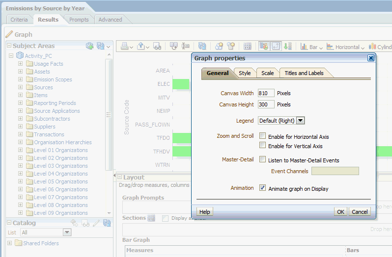

Depending on the number of data points, you may need to lengthen the axis of a Dashboard graph in order to read all data point titles along the axis. For example, in the Emissions Dashboard, select the Emissions by Source tab. The Emissions by Source by Year horizontal bar graph appears. If you have a large number of emissions sources, you may need to lengthen the vertical axis of the graph in order to read the name of each source.
Graph with a Short Vertical Axis
Same Graph with a Correctly Sized Vertical Axis
The following procedure explains how to lengthen the axis of a graph using the Emissions by Source by Year horizontal bar graph as an example. You can apply the same steps to any Dashboard graph, though.
To change the size of a graph
Navigate to OBIEE Dashboards. Click Emissions. The Emissions page appears.
Select the Emissions by Source tab.
Click the Page Options icon.
The Page Options icon appears in the upper right corner of the page, to the left of the Help icon.
Select Edit Dashboard from the Page Options list.
Hover over the Emissions by Source by Year Graph 1 box. Two buttons appear in the upper right corner of this box. Click Properties (the xyz icon).
Select Edit Analysis from the Properties list.
In the Views region in the lower left corner of the page, select Graph from the list of views.
Click Edit View (the pencil icon in the Views region).
The graph appears.
Select the Edit graph properties icon (the xyz icon) from the toolbar above the graph.
The Graph properties box opens.
Enter a new graph width or height in the Canvas Width or Canvas Height fields.
Click OK.
If the graph size appears correctly, go to the next step. If you need to change the graph size again, repeat the previous two steps over and over until the graph appears correctly.
Click Done in the upper right corner of the page.
Click the Save Analysis icon (upper right corner of the page, near the Help icon).
Navigate to the Dashboard and verify that the graph appears as expected.
