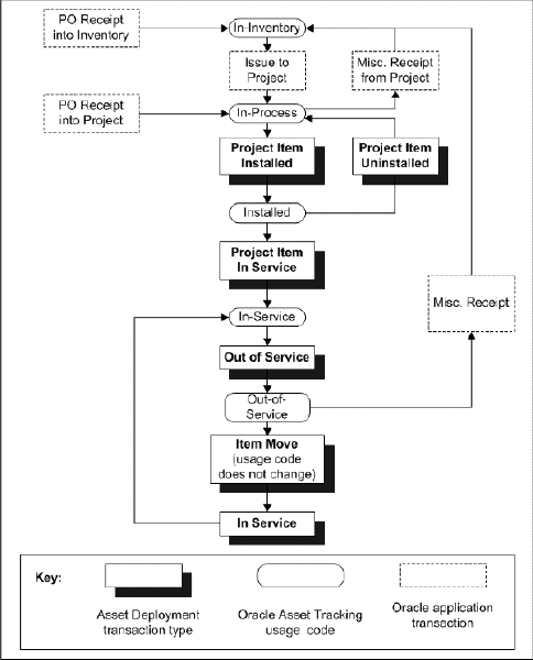

The following diagram illustrates the lifecycle flow of an item instance, indicating the asset deployment and Oracle application transactions that change the Oracle Asset Tracking operational status codes for the item instance.
Asset Deployment Actions in Item Instance Life Cycle Flow
