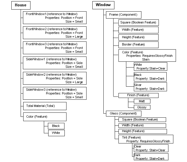

The parent Model is House and its child (referenced) Model is Window. The figure below shows structure diagrams of the House and the Window Models. The House Model contains a Total for Material, a Color Feature with the Options Black and White, and References to the Window Model for three FrontWindows and three SideWindows. The References each have a Position and a Size Property. The FrontWindows have Position = Front and the SideWindows have Position = Side. There are two small and one large Window in both positions, determined by the Size Property being set to small and large, respectively.
The Window Model contains two Components, Frame and Glass. The Frame Component contains numerous Features including Border, Color (with the Options White, Black, and Silver), and Finish (with the Options Matte and Glossy). The Glass Component contains several Features including Tint (with the Options Clear and Dark).
Example House Model shows the Model House as the parent Model, and a Model called Window is its child (referenced) Model. The Window Model contains a Frame Component and a Glass Component, and both Components have various types of Feature nodes.
