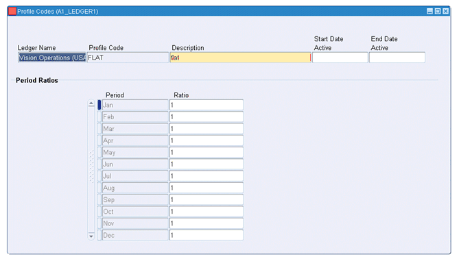

Profile codes define how an annual budget amount is automatically spread across the periods in the accounting calendar. In the Profile Code window, you create a profile and define the percentages (ratios) of the annual budget amount to be assigned to the periods. Profile Codes are also assigned a start and end date. Profile Codes defined here are made available in the Oracle General Ledger data entry windows such as reprofiling.
To define profile codes:
Navigate to the Profile Codes window.
Select a ledger.
The ledger name list is unique and displays the ledgers within the responsibility's Data Access Set that have Full Ledger read or write access with no restrictions on balancing segment values or management segment values.
Note: This window allows you to create unique profile code for each ledger accessible by the responsibility.
Enter a unique profile code.
Enter a profile code description.
Select the date that you want the profile code to be active.
If the Start Date Active field is left blank, the profile code is immediately activated.
Note: Once defined, you cannot delete or rename profile code.
To disable a profile code, select an end date.
In the Ratio field, enter a new value to change the period ratio.
