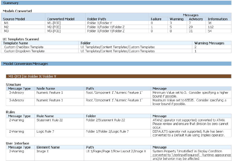

After the Model Conversion Utility completes successfully, the UI Definition for each of the converted Model's UIs refer to FCE-specific icons, Message Templates and Utility Templates. All custom and predefined UI Master Templates also refer to these icons and templates, and they contain additional settings for displaying BOM and non-BOM content.
For more information about these changes, see:
The Model Conversion Utility does not modify any other UI objects, but it does review all pages, elements and custom UI Content Templates for potential incompatibilities with the FCE. For example, the utility changes the Unsatisfied System Property to InputRequired. As a result, any runtime conditions in which InputRequired is used may appear or behave differently after conversion. All other incompatibilities are described in detail in the Model Conversion Utility Report.
The Model Conversion Utility generates this report each time you convert one or more Models to use the Fusion Configurator Engine. The report is in XML format and Oracle provides an XML Publisher template for formatting the output. You can optionally define additional XML Publisher templates if you want to customize the report format.
To learn how to run the Model Conversion Utility and view the Model Conversion Report, see Running the Model Conversion Utility.
For each Model that was converted, the report summarizes the conversion process by listing:
The names of the source and converted Model(s)
The path to the location of both the source and the converted Model(s)
How many messages of each type were generated during the conversion process
There are four types of messages that may appear in the Model Conversion Utility report. Following is a description of each type:
1 - Failure: The specified object could not be converted. To resolve this type of error, you must either modify or delete the object in Configurator Developer.
For example, when you convert a Model that has an invalid rule, the report contains a Failure message similar to the following:
Rule contains invalid syntax; not converted. Please review and correct, or delete.
2 - Warning: Converting the specified object may have introduced unexpected or undesirable behavior in the Model. Reviewing the object in Configurator Developer is strongly recommended.
For example, after converting a Defaults Logic Rule, the report contains a Warning message similar to the following:
DEFAULTS operator not supported; Rule has been converted to a Default Rule using Implies operator.
    3 - Advisory: The object converted successfully, but you may be able to improve performance by making additional changes in Configurator Developer. Reviewing the object is recommended.
For example, after converting a Numeric Feature, the report contains an Advisory message similar to the following:
Maximum Value set to 1000. Consider specifying a lower bound if possible.
In this example, the value is the default provided by the profile option CZ: Default Max Quantity Integer.
4 - Information: The object converted successfully with no issues, and reviewing the object in Configurator Developer is optional.
For example, after converting a Boolean Feature that has an Initial Value, the report contains an Information message similar to the following:
Initial Value removed; replaced by Default Rule RuleName If value is not required prior to completion of the configuration, consider changing Rule to a Search Decision for better performance.
Model Conversion Report: Example
