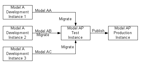

The illustration Migrating Models from Multiple Development Instances shows the migration of a Model from several development instances to a single test instance, before publishing to a production instance. In this scenario, several different areas of a Model are developed in isolation in separate development instances and then the Models are migrated and synchronized in the test instance before being published to the production instance.

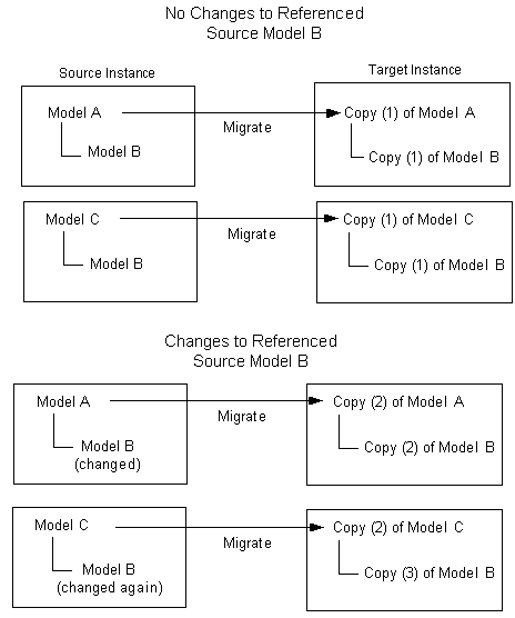

The illustration Migration of Referenced Models shows examples of Models with referenced Models that are migrated to another instance. When Model A is migrated, copies of both Model A and its child Model B are created on the target instance. You then migrate Model C, which also references Model B. Model B has not changed since the last migration, so the copy of Model C references the existing copy of Model B on the target.
Model B is then modified on the source instance (for example, new Model structure is added), so when you remigrate Model A, a new copy of both Model A and its child Model B are created. Model B is modified again on the source, so when you remigrate Model C, new copies of both Model C and its child Model B are created on the target.
The migration process does not create a new copy of a referenced Model if only the Model's name has changed.
