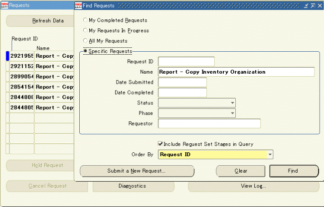

The Copy Organization report is run automatically, indicating results and highlighting errors.
Review the Copy Organization report and the Copy Organization concurrent log file to verify successful copying of all entities.

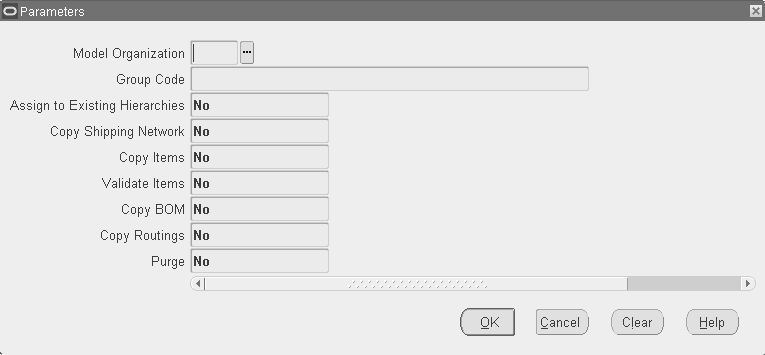

The Copy Organization concurrent program parameters include:
Model Organization: Organization code of the source inventory organization. You cannot choose an item master organization.
Assign to Existing Hierarchies: All established organization hierarchies from your model organization can be copied.
Copy Shipping Network: All shipping networks defined in the model organization.
Copy Items: All active items in the model organization.
Validate Items: Select Yes or No. When Yes is selected, item data is validated to find if any inconsistencies exist in the data, before it is copied to the new organization. When No is selected, the data is copied without performing any validations. Validating item data is performance intensive and it increases the time required for creating the new organization when a large number of items are involved. If you are certain that the item data in the model organization is free from any data inconsistencies, then select No for better performance.
Copy BOM: All BOMs and their parameters, if they have been defined in the model organization.
Copy Routings: All departments, resources, and routings if they have been defined in the model organization.
Purge: After running the copy inventory organization concurrent program, you can purge the group code.
Note: You can select the model organization attributes you want to copy to your new organization. You can specify which (if any) you want to copy. The default categories and all subinventories that are defined in the model organization are always copied into the new inventory organizations. If you copy organizations with shipping networks, then the program will copy the item-sourcing organizations and item-sourcing subinventories in the organization parameters and subinventory definitions.

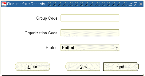

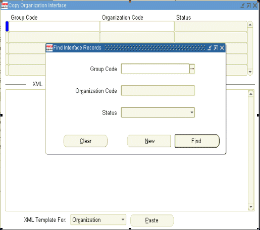

To create a new inventory organization definition record, you must first open the Copy Organization Interface window. The following table describes using the Copy Organization Interface window:
| Step | Action | Description | Navigation |
| 1 | Open the Organization Copy Interface window | Open the window from the Inventory main menu | Inventory > Setup > Organization > Organization Copy Interface |
| 2 | Create a new organization using the Find Interface Records window | Use the New button to create new organization records | Inventory > Setup > Organization > Organization Copy Interface > Find Interface Records |
| 3 | Enter organization details on the New Interface Records window | Enter the new organization details on the New Interface Records window | Inventory > Setup > Organization > Organization Copy Interface > New Interface Records |

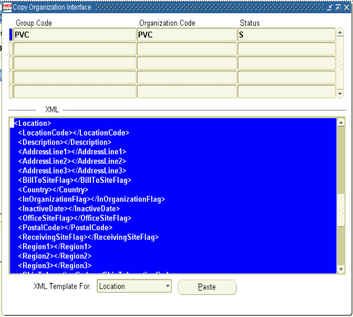

XML text is created when you save your new organization definition data in the interface table. Each organization you create using the New Interface Records window will have its own XML record created. Use the Organization Copy Interface window to both create and change information about your new inventory organizations.
When you define your new organizations, use the Extensible Markup Language (XML) template 'XML Template For'. There are two templates available, one for Organization and the other for Location. You can see the required XML tags in the templates to define organizations or locations. The complete XML code generation occurs in the background and does not require that you have a working knowledge of XML.
When you define new organizations in the Copy Organization Interface window, new inventory organization records are saved in the Copy Organization Interface table.

In the footer section you can select XML templates and paste them onto the XML section of this window.
When you paste an XML template, all the XML tags for your selection are included. Use the XML tags to change the parameters for your new inventory organization.
Note: All XML tags that do not contain data are interpreted by the system as null values and will overwrite the model organization values to null. If you do not want to change a value from the model organization, then you must delete the appropriate tag.
When you populate the interface table, the mandatory XML tags and the values for your inventory organization are created by default. The mandatory XML tags and values are:
Name: Your organization name
Organization Code
Location Code: The location code for your organization
For every new inventory organization that you create, a separate record with the mandatory XML tags and values is created. The Copy Inventory Interface window enables you to view the inventory organization information in XML format. The XML tags containing organization and location information can be modified, as necessary, on this window. If you do not enter data for any XML tag, you must delete that tag.

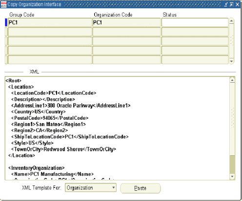

Examples of XML Data
The following examples show how XML tags are used to link a new organization to an existing location and then, to a new location:
New organization linked to an existing location.
<Root>
<InventoryOrganization>
<Name>PVC Manufacturing</Name>
<OrganizationCode>PVC</OrganizationCode>
<LocationCode>ExistingLocation</LocationCode>
</InventoryOrganization>
</Root> New organization linked to a new location.
<Root>
<LocationCode>NewLocation</LocationCode>
<Location>
<LocationCode>NewLocation </LocationCode>
<Description>New Location Created using CopyOrg</Description>
<AddressLine1>300 Oracle Parkway</AddressLine1>
<Country>US</Country>
<PostalCode>94065</PostalCode>
<Region1>San Mateo</Region1>
<Region2>CA</Region2>
<ShipToLocationCode>NewLocation </ShipToLocationCode>
<Style>US</Style>
<TownOrCity>Redwood Shores</TownOrCity>
</Location>
</Root>Execute the Copy Inventory Organization concurrent program to create the new inventory organizations that you previously defined.

Submit the Copy Inventory Organization concurrent program using the Standard Report Submission window. This concurrent program has the following parameters:
Model Organization
Group Code
Copy Shipping Networks
Copy Items
Validate Items
Copy BOM
Copy Routings
Purge
The following table lists the Copy Inventory organization parameters.
| Parameter | Description | Required? | Default Value |
| Model Organization | Choose an inventory organization from the list of values as your model organization. This organization is used to derive all inventory parameters that you wish to copy. | Yes | Null |
| Group Code | Choose a Group Code from the list of values. The group is a collection of individual inventory organization records that you wish to process in a single concurrent request. | Yes | Null |
| Assign to Existing Hierarchies | If yes, all new organizations will be assigned to the same hierarchies as the model organization. If no, the organizations will not be assigned to the model organization's hierarchies. You can run the Hierarchy Exceptions report to list organizations that have not been assigned to hierarchies. |
Yes | No |
| Copy Shipping Networks | If yes, all the model inventory organization's Shipping Network setup information will be copied to the new organization. If no, the shipping network setup will not be copied. |
Yes | No |
| Copy Items | If yes, all items activated in the model organization will be copied and activated in the new organizations If no, no items will be copied. Item assignment is a one time process and can not be undone. There is a separate concurrent program that can be run to assign items. |
Yes | No |
| Validate Items | If yes, then all items are validated during the copy. If no, then items are not validated during the copy. |
Yes | No |
| Copy BOMS | If yes and if Bills of Material have been created in the model organization, all BOMs will be copied to the new organizations If no, Bills of Material will not be copied. |
Yes | No |
| Copy Routings | If yes and if routings exist in the model organization, then all routings are copied to the new organizations. If no, then routings are not copied. |
Yes | No |
| Purge | If yes, all records from the interface table will be purged. If no, the records will not be purged. Records with Fail will not be purged even if you have selected yes. |
Yes | No |

To find a Copy Inventory Organization report, query it using the Find Requests window. Specify the Request Name as Report - Copy Inventory Organization and click Find.

If any organization data fails to process, locate these records in the Organization Copy Interface window, make appropriate changes, and resubmit them by running the concurrent program again.
All records that fail to process due to errors will have a status of Failed. As described in the Create New Inventory Records section of this implementation guide, make your corrections to the XML tags (if an XML tag or value error).
To display all records with a status of Failed, use the Find Interface Records window as shown.
| 2 | Enter the parameters to find your organization | Click Find to locate the organization records | Inventory > Setup > Organization > Organization Copy Interface > Find Interface Records |
| 3 | Enter Group Code | The Group Code for your data | You do not need to enter the Group Code to display FAILED records |
| 4 | Enter Organization Code | The Organization Code for your data | You do not need to enter the Organization Code to display FAILED records |
| 5 | Enter status | Enter FAILED in the Status field | You MUST enter FAILED status |
| 6 | Find | Click Find | (B) Find |
