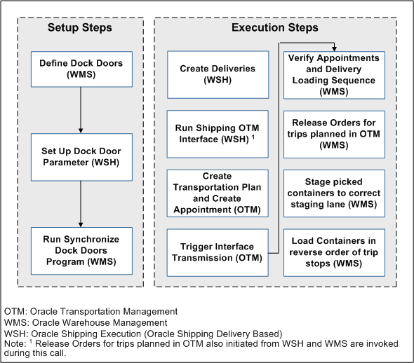

The following graphic shows the steps for integrating Oracle Warehouse Management with Oracle Transportation Management:
Integration Steps for Oracle Warehouse Management and Oracle Transportation Management
the picture is described in the document text
  1. Define dock doors (Oracle Warehouse Management).
  2. Enable dock door parameters (Oracle Shipping Execution).
    Select the Enabling the Dock Door Appointment Scheduling check box on the Shipping Parameters window for the organization. Even if the organization is enabled for Oracle Transportation Management, if this option is not selected, the dock door appointments from Oracle Transportation Management will not be synchronized with the Oracle E-Business Suite.
  3. Run the Synchronize Dock Doors with Transportation Management concurrent program (Oracle Warehouse Management).

The following steps outline the process for synchronizing dock door appointments with Oracle Transportation Management:
Step Number Step Set Up/Run This Step in Following Oracle Application
1 Create deliveries.
Create deliveries and view delivery information associated with the trip in the Shipping Transactions window.
Important: Delivery lines must be in the status of Ready to Release.
2 Run the Shipping-Transportation Outbound Interface program to send the delivery information to Oracle Transportation Management. Oracle Shipping Execution
3 Create appointments in Oracle Transportation Management.
After the appointment is created, you can view the available appointment in the Manage Appoints page.
4 Running the interface transmission.
Oracle Transportation Management maintains all dock door appointments and sends the trip-related appointments to Oracle Warehouse Management.
5 View or change dock door appointments.
You can use Oracle Warehouse Management to modify the dock appointments at any time. If the material has been loaded to the dock door or staging lane, you will have to manually modify the dock appointments. This may include changes to Dock Door.
6 Load Sequencing: Verify appointments and delivery load sequencing
Load Sequencing is the order in which the LPNs are loaded onto a carrier's truck or vehicle. Usually, the LPNs that need to be dropped off first are loaded last onto the vehicle (last-in first-out method). As part of the existing integration between Oracle Shipping Execution and Oracle Transportation Management, the stop sequence numbers are sent from Oracle Transportation Management to create the trip stops in shipping. The same sequence will be used as the Loading Sequence (in reverse).
7 Load Sequencing: Release the trip for pick release execution.
After the load sequence is determined and the trip stops are returned to Oracle Shipping Execution, you can then release the order for picking.
8 Load Sequencing: Associate the staging lane to dock door. Oracle Warehouse Management
9 Load Sequencing: Stage the delivery. Oracle Warehouse Management

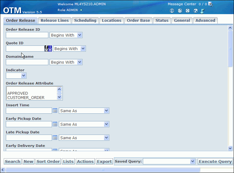

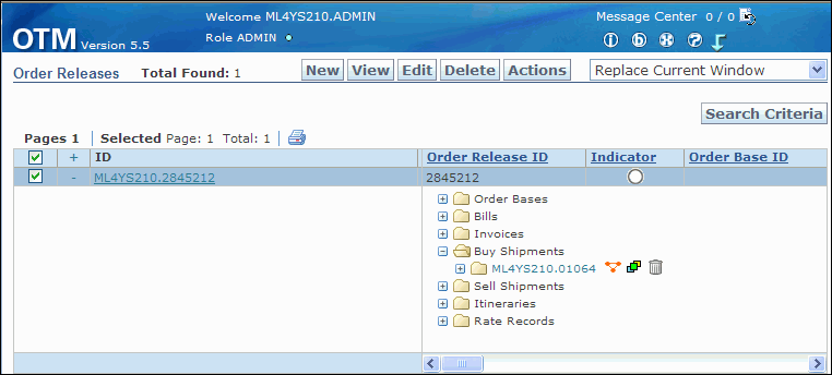

  1. Navigate to the Order Release page in Oracle Transportation Management.
    Order Release Search page
  2. Enter your delivery number in the Order Release ID field and click Search to display the search results.
  3. Select the ID from the navigation tree, and then expand the Order Release ID.
    Order Releases page

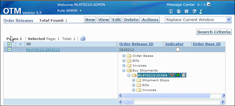

  4. Select one of the following:
    • To build a shipment: From the Actions menu, select Create Buy Shipment, then select Build Buy Shipment on Primary Leg.
    • If you have already built a shipment, select Buy Shipments and select the buy shipment number. Alternatively, to maintain an appointment for a particular stop, expand the Shipment Stops tab to select a shipment stop.
    Order Releases-Buy Shipments

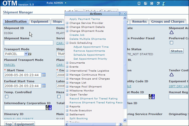

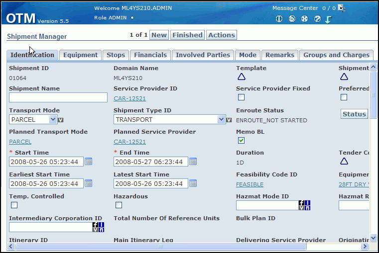

  5. Double-click the buy shipments ID to display the shipment in the Shipment Manager page.
  6. To schedule dock appointments for the shipment: From the Actions menu, select Dock Scheduling, then select Schedule Appointment.

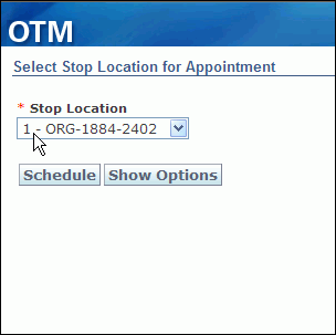

  7. Select the stop location for the appointment. You can define additional search options by clicking Show Options.
    Select Stop Location for Appointment page

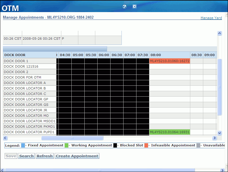

  8. Click Schedule to schedule the dock door appointment. You can then click View Appointment to view the appointment details.
    After the dock door information is sent Oracle Warehouse Management (by running the Send Interface Transmission program), you can modify the dock appointments at any time from Oracle Warehouse Management. If the material has been loaded to the dock door or staging lane, you will have to manually modify the dock appointments.

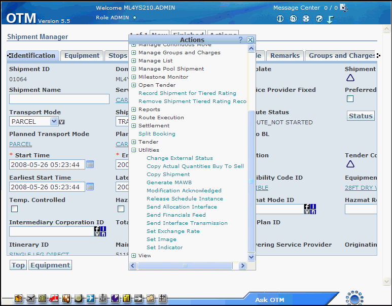

  9. Oracle Transportation Management maintains all dock door appointments and sends the trip-related appointments to Oracle Warehouse Management. These appointments are sent as part of the existing planned shipment updates to Oracle Warehouse Management at the pickup stop(s).
    To send the information from Oracle Transportation Management to Oracle Warehouse Management, run the Send Interface Transmission program. On the Shipment Manager page, from the Actions menu, select Utilities, then select Send Interface Transmission.
    Shipment Manager page-Send Utilities

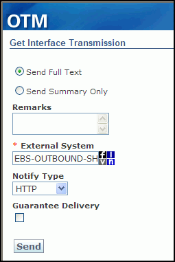

  10. Select your interface transmission criteria in the Get Interface Transmission page.
    Use the interface page to send delivery information to external systems such as Oracle Warehouse Management. The stop sequence numbers are sent from Oracle Transportation Management to create the trip stops in Oracle Shipping Execution (this information is mapped to the Inbound Trip XML).
  11. Click Send to run the interface transmission.
