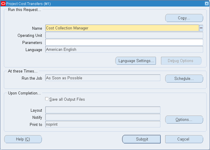

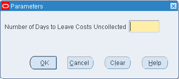

You can cost all project-related manufacturing transactions, then capture these costs and transfer them to Oracle Projects. You can associate items and manufacturing business processes with specific projects, and optionally tasks, to track quantity and cost information through these business processes. Project Manufacturing costing enables you to process and cost material, labor, and associated overheads against a specific project or a group of projects for a specific customer.
Define projects and tasks in Oracle Projects. Project tasks make up the Work Breakdown Structure of a project. Projects and tasks can be referenced throughout Oracle Manufacturing Applications.
See: Work Breakdown Structure, Oracle Projects User's Guide and Overview of Projects and Tasks, Oracle Projects User's Guide.
You can use the Cost Collector to pass project-related costs from Oracle Manufacturing Applications to the Transaction Import Interface table in Oracle Projects. These transactions can then be imported from the interface table into Oracle Projects.
The Cost Collector collects costs by project, task, expenditure type, expenditure organization, and expenditure date. See: Project Cost Collector.
Task auto assignment assures that each project transaction has a task, if one has not already been assigned. Task Auto Assignment enables you to manage your manufacturing activities by project and collect manufacturing costs by different tasks.
See: Task Auto Assignment Process, Oracle Project Manufacturing User's Guide.
The cost collection manager updates the transaction information with a specified project, if required. See: Common Project Assignment, Oracle Project Management User's Guide.

To collect project related cost
Navigate to the Project Cost Transfer window. Submit a request for the Cost Collection Manager. The Parameters window appears.
Specify the project cost collection time fence, the Number of Days to Leave Costs Uncollected, by entering a whole number of days.
For example, suppose today is Thursday and project costs were collected up through Friday of the previous week. If you enter 4 as the Number of Days, costs will be collected for Saturday and Sunday.
If there are uncosted transaction records in the MTL_MATERIAL_TRANSACTIONS table within the specified time fence, then project costs for these transactions are not collected. You can check to see if transactions are uncosted, as indicated by the costed indicator, through the Material Transactions window. See: Viewing Material Transactions, Oracle Inventory User's Guide.
Uncosted transactions and transactions that lack complete information are flagged Error.
Choose Submit to run the request.
