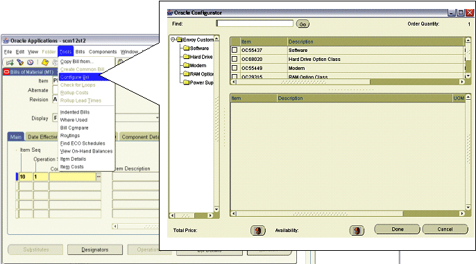

BOM: Configurator URL for UI Manager
In order to preconfigure items using BOM, this profile must be set to the proper URL for the configurator in your instance. See Preconfiguring Items

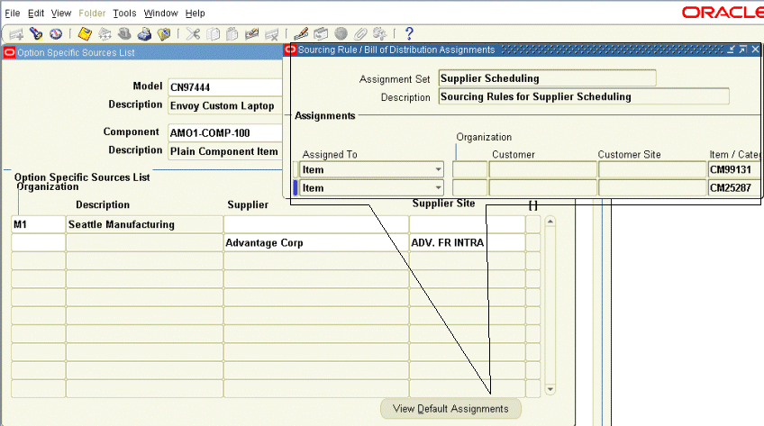

MRP: Default Sourcing Assignment Set
This profile option determines the sourcing assignment set that CTO will use to assign sources to models. This must be set if models need to be sourced. This assignment set must also be assigned to the supply chain plans in all sourcing organizations.
Any sourcing rules and assignments on models will be ignored if this profile is not set.

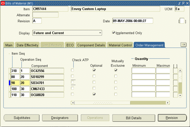

This section describes the setup of item, bills of material, and routing for models and option classes. It also describes the features of cataloging configurations and configuration rules.
Several key item attributes are central to ensure correct processing of a configure-to-order sales order. The following table highlights these attributes and their typical setting.
| Attribute | PTO Model | PTO Option Class | ATO Model | Option Class | ATO Item | Option (Component) |
| BOM Item Type | Model | Option Class | Model | Option Class | Standard | Standard |
| BOM Allowed | Yes | Yes | Yes | Yes | Yes | Yes |
| Planning Method | Not Planned | Not Planned | MPS Planning | MRP Planning | MRP | MRP |
| Forecast Control | Consume | Consume & Derive | Consume or Consume & Derive | Consume and derive if manufacturing the model. Null if it belongs to a purchase model. | Consume | Consume & Derive if manufacturing model, Null if purchasing model |
| Build in WIP | No | No | No | No | Yes, if using the autocreate program to generate supply—even if it is a buy item. Otherwise, it depends. | (depends) |
| OE Transactable | Yes | Yes | Yes | Yes | Yes | Yes |
| Check ATP | No | No | No | No | (depends) | (depends) |
| ATP Components | (depends) | (depends) | (depends) | (depends) | (depends) | (depends) |
| Assemble to Order | No | No | Yes | Yes | Yes. This value should be the same in all organizations | No |
| Pick Components | Yes | Yes | No | No | No | No |
| Ship Model Complete | Yes or No (only applicable for PTO model) | n/a | n/a | n/a | n/a | n/a |
| Purchased / purchasable | No | No | Yes if you will be purchasing the model | Yes if you will be purchasing the model | Yes if you will be purchasing the ATO item | Yes if you will be purchasing the model |
| Lot/Serial Control | No | No | Yes, if you want the configuration to be lot/serial controlled. Note: Serial Control of "Unique within Item" will mean "Unique within base Model" for configurations. | No, unless you want to set the default serialization starting operation sequence number for the configuration based on the option class routing. | Depends | Depends |
| Match Configuration | N/A | N/A | Null if you want to default from profile, Standard if you want a standard match, Custom if you need a custom match. See Match Configurations | N/A | N/A | N/A |
| AutoCreated Configuration | N/A | N/A | N/A | N/A | N/A if no base model exists. Not enabled if base model exists and you want it treated as a preconfigured item. See Preconfiguring Items. | N/A |
| Create Configuration Item, BOM | N/A | N/A | Depends on attribute settings. See: Create Configuration Item, BOM Attribute. | N/A | N/A | N/A |
| Base Model | N/A | N/A | N/A | N/A | The model the configured item is generated from. Null if the ATO item is not configured. This must be the same in all organizations. | N/A |

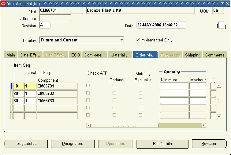

Model bills of material: An ATO model bill lists the option classes, options, and standard items that exist for a model. The bill of material for a PTO model lists the option classes, options, and included items that exist for that mode
Option class bills of material: Option class bills can contain standard components, options, other option classes, or models

The following BOM attributes are important for model or option class bills of material:
Maximum and Minimum Quantity: For each option, you can specify a quantity range that limits the quantity of the option you can order during Order Management.
Optional: The Optional attribute is applicable only to component items on model and option class bills of material. If this attribute is not selected for an option, the option will not appear in the configurator, or in the OM options window. However, it will l be chosen automatically when you choose an optional item from the same model or option class. If this attribute is not selected for an option class, you are required to select at least one of the options from its bill of material.
Mutually Exclusive: The Mutually Exclusive attribute is only applicable to option class items. If this box is selected, you are allowed to select only one option from the option class bill of material.
Planning Percent: (Component Details tab) Planning percent is used in forecast explosion. The planning percent for mandatory components is default to 100 percent. You can enter a planning percent for all the optional items and it can exceed 100 percent.
Note: If a sub model can be multiply instantiated in the configurator, the planning percentage on its parent should represent the average expected number of instantiations, multiplied by 100 percent. See: Oracle Configurator Developer User's Guide for more information on multiple instantiation.

Invoke Oracle Configurator from within Oracle Bills of Material to create a configured bill of material and routings for a predefined ATO item. This is useful in a business to business environment where the same configuration is ordered repeatedly. Preconfigured items can be built to forecast and kept on hand. Customers can order the preconfigured items directly, as they would a standard ATO item.
Preconfigure BOM respects the new organization level BOM parameter Create Configuration BOM. An error message displays if you try to preconfigure in an organization where this parameter is set to No.
You can preconfigure multilevel structures within BOM in a manner similar to that done in Order Management. The configurator uses the item validation organization defined in the OM parameters form for the current organization to determine the BOM to present during the configuration session. Once the options are chosen, the sourcing rules on the models, the setting of the Create Configuration Item, BOM, and Routing attribute, and any Option Specific Source definition are used to determine the organizations in which to create the BOM and routings.

Option specific sourcing allows you to restrict the sourcing of a configuration based on a specific option or options that are ordered. For example, you may have a model that can be manufactured in three organizations. But if a specific option is chosen, it can be made only in one of the three, as they have the specialized machinery to build it.
If you have restricted options, specify the list of valid organizations and vendors where the model can be manufactured, stocked, transferred or procured, if that option is chosen. This list of organizations is overlaid with the model sourcing chain, during the ATP and Autocreate configurations processes, to restrict the sourcing of a specific configuration based on the options that were chosen. See: Impact of Option Specific Sources for more information.
This section is intended to give you a feel for situations in which you may need to setup option specific sourcing for your models:
OSS setup is not required
There are three organizations, set according to regions of the world:
Japan Org
US Org
Europe Org
The model is a Make item in all three, but the BOM in each is different, and contains only options pertinent to its respective region.
For previous releases, you manually chose the warehouse on the sales order based on where the order originated (or used OM defaulting rules to do so). In this case, CTO creates the BOM only in the org against which the order is placed. This is still true if the model's Create Configuration Item, BOM attribute is set to Based on Sourcing (the default). No further set up is required.
You can use this attribute even if you are doing PDS based ATP with matching, because the ship from organization is always defaulted, and there is no variation in sourcing once that organization is picked. No OSS setup is required.
OSS setupis required
The ATO model can be made in any of six manufacturing organizations, and you want the choice of the manufacturing organization to be based on GOP, rather then simple defaulting rules. However, if the customer chooses a specific option (for example a specific specialty coating for the product) it can only be made in Org1. Match is used on this model.
For 12.0, if you want to use GOP to pick the warehouse or want to match during ATP, the model's Create Configuration Item, BOM attribute must be set to Based on Model so that the item, BOM, and routing are created in all six manufacturing organizations, and future matches to the configuration item are valid and ATPable in all six manufacturing organizations.
If you do not set up OSS for the model with the specialty coating, CTO attempts to create the bill for these configurations in all six organizations no matter which one is shipping the material. Because the speciality coating option does not exist on the model BOMs in organizations 2-5, autocreate configuration completes with a warning and puts the order on hold for all sales orders with this option.
To avoid this, set up OSS for the Model with the specialty coating as a component to restrict ATP to choose only Org 1, and to restrict the BOM creation for that item to Org1.
This is required even if you are not using ATP or APS.
To set up option specific sourcing
Navigate to Advanced Planning, Source Instance Setup, Sourcing, CTO Option specific sourcing.
In the header, enter the following:
Model Name: List of values contains all ATO models in your item master
Component Name:List of values that contains all active items in the system. You should pick only options, options classes or sub-models that are components of the parent model specified
If an option is specified, the sourcing chain for a configuration with that option will be limited to the organizations and suppliers listed in the setup
If an option class is specified, the sourcing chain for a configuration with that option class chosen is limited to the organizations and suppliers listed in the setup. If there is setup for both an option class and an option underneath it, an intersection of the specified sources is taken to determine the valid sources for the configuration.
If a sub model is specified as a component, any configuration that has that sub model is restricted to the organizations specified in the setup.
Note: If the sub model is phantom on the parent models bill in the OM validation organization, it is treated as an option class for the purposes of OSS processing.
In the child form, enter list of organizations and supplier/supplier sites that are valid parts of the sourcing chain for this model and component combination. Valid parts of the chain are anywhere this model with this option can be can be manufactured, stocked, transferred or procured:
Organization: List of values contains all organizations in your system in which the model is enabled
Supplier:List of values contains all vendors in all operating units
Supplier Site:List of values contains all vendor site code. Note that the LOV displays the vendor code (name) and not the vendor ID, as vendor ID is operating unit specific. This enables you to set up a vendor site once and have it apply to all operating units that use that vendor.
Selecting View Model Assignments opens the assignments form with MRP: Default assignment set data. If the profile is set to Null then the Assignment form opens with no specific assignment in it.
Note: Option specific source lists setup for a model are ignored in cases where that model appears as a phantom on a parent model bill in the OM Validation Organization.
Note: An option specific list defined for a submodel will affect the parent model's available sources if the model appears as a nonphantom in the parent model's bill in the OM validation organization.

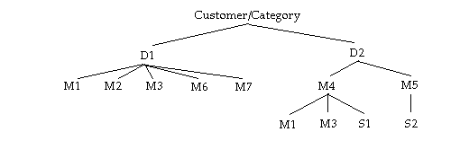

Option Specific Sourcing Example
Model BOM in the item validation org is:
Model1
OC1
O1
O2
O3
O4
Model2
OC2
O5
O6
Model1 sourcing:
Model2 sourcing:
| Sourcing rule | Org / Global | Type | Org | Supplier | Alloc% | Rank |
| SR11 | Item | Transfer | D1 | - | 40% | 1 |
| - | - | Transfer | D2 | - | 60% | 1 |
| SR12 | Org D1 | Transfer | M1 | - | 30% | 1 |
| - | - | Transfer | M2 | - | 30% | 1 |
| - | - | Transfer | M3 | - | 30% | 1 |
| - | - | Transfer | M6 | - | 40% | 1 |
| - | - | Transfer | M7 | - | 100% | 2 |
| SR13 | Org D2 | Transfer | M4 | - | 50% | 1 |
| - | - | Transfer | M5 | - | 50% | 1 |
| SR14 | Org M4 | Transfer | M1 | - | 50% | 1 |
| - | - | Transfer | M3 | - | 25% | 1 |
| - | - | Buy | - | S1 | 25% | 1 |
| SR15 | Org M5 | Buy | - | S2 | 100% | 1 |
| SR16 | Item | Transfer | M4 | - | 40% | 1 |
| - | - | Transfer | M5 | - | 60% | 1 |
| Assigned to | Org | Item/ | BOD/SR |
| Customer | - | Model1 | SR11 |
| Model-Org | D1 | Model1 | SR12 |
| Model-Org | D2 | Model1 | SR13 |
| Model-Org | M4 | Model1 | SR14 |
| Model-Org | M5 | Model1 | SR15 |
| Item | - | Model2 | SR16 |

Set up the option specific source lists listed in Table 2–17.
| Model | Component | Org | Vendor | Vendor Site |
| Model1 | O1 | D1 | - | - |
| - | - | D2 | - | - |
| - | - | M4 | - | - |
| - | - | M1 | - | - |
| - | - | M3 | - | - |
| - | - | M6 | - | - |
| Model1 | O2 | D1 | - | - |
| - | - | M2 | - | - |
| Model1 | O3 | D2 | - | - |
| - | - | - | S1 | Ste1 |
| Model1 | O4 | D1 | - | - |
| - | - | M7 | - | - |
| Model2 | O5 | M4 | - | - |
