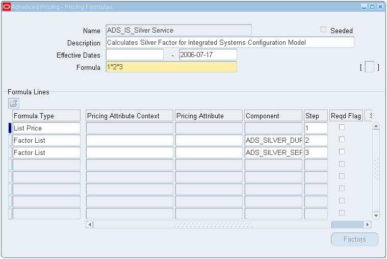

Navigate to the Advanced Pricing - Pricing Formulas window.
Enter a Name and Description for the formula.
Enter the Effective Dates range.
Enter a Formula expression. A formula consists of step numbers (such as 1, 2, 3) used in an arithmetic equation such as 1*2.
A step number such as 1 in the formula expression corresponds to the formula line with the same step number in the Formula Lines region.
The Seeded box identifies if the selected formula is seeded.
Every time a new formula expression is created, the concurrent program Build Formula Package must be run to generate the formula package.
From the Tools menu, select Build Formula Package to run the program. Alternately, you can also run the Build Formula Package concurrent program. A Dialog box displays a message if the formula package generation was successful.
Save your work.
In the Formula Lines region, you create formula lines and assign a Step number that can be used in the Formula expression. Complete the following steps for each formula line to be created.
Select one of the following Formula Types:
Function: The Component field displays GET_CUSTOM_PRICE. You must write the function in this PL/SQL package and it must return a number. For more information, see Oracle Advanced Pricing Implementation Guide.
List Price: The price of the item in a specific price list to which you have attached a formula.
Factor List: Select an existing factor list in Component field. Alternately, to create a new factor list, type a new name in the Component field, and press the Enter key. When you complete your entries for the formula line, click Factors to create the factor criteria in the Factors window.
Modifier Value: A formula that has a Modifier Value as a component can be attached to a price list line.
Numeric Constant: Enter the numeric constant in Component.
Price List Line: A formula that has List Price as a component and is attached to a price list line gets the list price from the Value entered in a price list line.
Pricing Attribute: Select the Pricing Attribute Context and Pricing Attribute.
Enter the Step number for the formula expression. Step numbers cannot be repeated in the Formula Lines region even though they can be repeated in the Formula expression.
The Seeded box is selected for seeded formula lines.
The Reqd Flag check box is currently not used by the pricing engine unless you are using custom code for tracking formula line information. If you are using custom code for this purpose, then select the Reqd Flag check box.
Save your work.

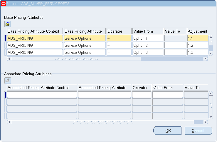

To Define Factor List Details
If the Formula Type is Factor List, click Factors in the Advanced Pricing - Pricing Formulas window to display the Factors window.
Factors window
In the Base Pricing Attributes region, complete steps 2-9 for each base pricing attribute factor. For information on searching for formula factor lines, see Finding Formula Factor Lines.
Select a value for Base Pricing Attribute Context.
If you have multiple entries, you must use the same base pricing attribute context in this region (to create an OR condition); the pricing engine chooses one of the entries. Use the Associate Pricing Attributes region to associate additional contexts with the base context (to create an AND condition where both attributes must be present to qualify).
Note: In the Base Pricing Attribute region, it is possible to enter duplicate values for any attribute such as entering the same Item Number of AS54888.
If matching base pricing attributes exist, then their ranking order determines the adjustment factor selected. For example, if base pricing attributes PA 1 and PA 2 match, then the pricing engine selects the PA 1 adjustment factor because it is defined first.
Select a value for Base Pricing Attribute.
Select a comparison Operator and enter a Value From and a Value To:
If you select the operator BETWEEN, then you must enter a Value From and Value To. If you do not enter a value for either, then the application displays an error when it evaluates a sales order line for pricing with a dynamic formula.
If you select the operator =, you must enter Value From and you cannot enter Value To. Enter Value To only when the Operator is BETWEEN.
Enter the Adjustment Factor. An adjustment factor enables you to adjust the price based on the options selected. For example, if you are selling cars, you could use adjustment factors to adjust the price based on the car options the customer chooses:
If the car options are Standard, then the price is multiplied by 1 (factor=1).
If the car options are Business, then the price is multiplied by 1.5 (factor=1.5).
If the car options are Deluxe, then the price is multiplied by 2 (factor=2).
If the cars you are selling are second hand, you probably want to adjust the price further based on the age of the car. For example:
If the car is between 0.0 and 1.0 years old, the price is multiplied by 1.
If the car is between 1.1 and 3.0 years old, the price is multiplied by 0.8.
If the car is older than 3.0 years, the price is multiplied by 0.6.
Enter a Start Date and an End Date range for this attribute in this factor list.
Note: The effectivity of this pricing attribute in this factor list also applies in all other formulas that use this factor list.
Enter a number in the Factor Rank field for the factor. This number determines which factor is evaluated first and avoids the need to delete or add factors each time when processing an order. The rank is displayed in the Factors List window. By default all factor lists have a default value of 0. When you enter 1 for a factor, the application processes it first. If no value is specified for the Factor Rank field, then the application considers the row id for the entered order while processing the order.
Note: The factor number represents the ranking of factors and not the precedence evaluation of the pricing list.
Complete the following steps for each associated pricing attribute:
In the Associate Pricing Attributes region, select an Associated Pricing Attribute Context and Associated Pricing Attribute to associate with the base pricing attribute context and base pricing attribute values (to create an AND condition).
Select a comparison Operator and enter the Value From and Value To:
If you select the operator BETWEEN, you must enter a value for Value From. If you do not enter a value for Value To, the default is unlimited.
If you select =, you must enter Value From and you cannot enter Value To.
Save your work.

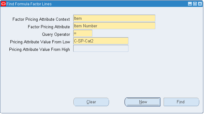

A factor list can consist of hundreds of factor lines and associated base pricing attributes. If your business requirements require you to change the values of certain pricing attributes, it is time consuming to scroll through the entire factor list to find a required record. Instead, use the Find Formula Factor Lines window to selectively retrieve the records you want.
You can narrow your search by selecting search criteria that defines the factor line you want to retrieve. You can query by Pricing Context, Pricing Attribute, Query Operator, and Pricing Attribute Value.
The query returns all those factors in the factor list that have either a base or an associated pricing attribute that meets the query criteria. The results are sorted by the Pricing Attribute Value From of the Base Pricing Attribute of the factor lines that are returned by the query.
To find formula factor lines
Navigate to the Find Formula Factor Lines window.
Enter the Factor Pricing Attribute Context for the query, such as Item.
Enter the Factor Pricing Attribute, such as or Item Category or Customer Item.
Enter the Query Operator, such as = or Between. The = operator returns an exact match while the Between operator returns a range of values. If the Pricing Context on the Query Find window is Item and the Pricing Attribute is either Item Number or Item Category, then the Query Operator is restricted to the value =.
Enter a Pricing Attribute Value From High/Low to define the range of values you want queried; for example, to restrict a query to a range of item numbers from 23456 to 45674. However, if the = operator is selected, you can only enter a value for Pricing Attribute Value From Low.
Click Find to return the query results.
Alternately, to start a new query, click Clear to clear the current query criteria and enter your query criteria.
Click New to create a new Base Pricing Attribute.

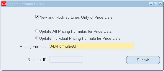

Use this process to use static formulas to set list prices. When you attach a formula to a price list line, you can select from the following calculation methods:
Dynamic calculation: When you enter an order, the pricing engine uses the formula to calculate the list price.
Static calculation: Before order entry, you run a concurrent process that calculates the list price.
To update formula prices for static calculation
Navigate to the Update Formula Prices window.
Update Rule Prices window
To calculate formula-based prices:
For price list lines whose formulas have been added or changed from when they were last updated by this concurrent program, select New and Modified Lines Only of Price Lists.
For all price list lines, clear New and Modified Lines Only of Price Lists.
To consider price list lines that have:
Any formula, select Update All Pricing Formulas for Price Lists.
A certain formula, select Update Individual Pricing Formula for Price Lists, and select the specific pricing formula.
The process applies this choice after it selects the price list lines according to the criteria for Step 2.
Click Submit to display the Request ID.
