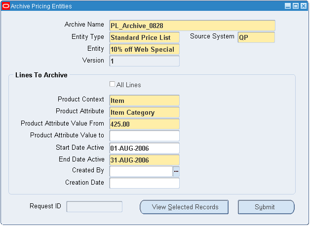

To archive pricing entities
Navigate to the Archive Pricing Entities window.
In the Archive Name field, enter a name that uniquely identifies the entity to be archived.
In the Entity Type field, select the type to be archived; in the adjacent field, select the source system (such as Pricing) associated with the entity type.
In the Entity field, select the entity to be archived, such as the price list or modifier list name. If pricing security is ON, you cannot view or select view-only price lists and modifier lists.
Note: Modifier lists with header limits are restricted from being archived when the archive request is submitted. In addition, the following pricing entities are not archived nor do they appear if you click View Selected Records before submitting the archive:
Lines with limits
Coupon/ benefit lines
Formula lines
In the Lines To Archive region, select one of the following:
Note: If you do not select product criteria in the Lines To Archive region, then all the end-dated lines falling within the date range that do not have product specified in the price list or modifier list are archived.
To archive all lines for the selected entity, you must first clear the Active check box on the list header. Once the list is inactive, you can select All Lines. If All Lines is selected, then the remaining fields in the Line To Archive region are grayed out because all of the lines are archived.
Additional Information: The All Lines check box appears if the value of the Entity Type field is Agreement Price List because you cannot inactivate an Agreement Price List.
To select specific archiving criteria, complete the remaining steps:
Note: For entity types of Standard Price List or Agreement Price List, your criteria should include Product Context, Product Attribute, Product Attribute Value From, and End Date Active (provided the All Lines check box is not selected).
A value for the Product Context of Item field automatically defaults; however, you can clear the field if you do not want to enter any product information.
Select a value in the Product Attribute field.
Select the Product Attribute Value From and Product Attribute Value To to specify a range of product attribute values for Item Number and Item Category. For all other product attributes, you cannot specify ranges. You must select the exact product attribute value.
Select a date range in the Start Date Active and End Date Active field to include modifier or price list lines that are active only within this date range. If you enter a Start Date Active and End Date Active, only lines equal to or less than the Start Date Active and End Date Active are archived. This is useful, for example, to archive lines for a specific date range, for example, from June to September.
If you do not enter an active start date, the range is from infinity to the value that you enter in the End Date Active field.
Note: You must enter a date in the End Date Active field (unless you selected the All Lines check box).
Select Created By to archive records created by a particular system user.
Select Creation Date to archive records that were created on a particular system date.
After selecting the archive criteria, click View Selected Records to display the Price list or Modifier list window in query mode and review the records that meet the selected archive criteria.
Click Submit to archive the records. The archive is saved using the name specified in the Archive Name field.

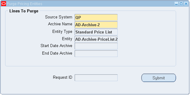

To purge pricing entities
Navigate to the QP Purge Entity window.
In the Source System field, select the system associated with the pricing data to be purged.
Select one of the following combination methods to purge the archives, then complete the fields for the selected combination:
Archive Name, Entity Type, Entity: Purges a named archive.
Entity Type, Entity: Purges all archives of a selected entity type and entity name.
Archive Start, End Date: Removes all archives falling within the specified range of system archive dates. Also purges all the archives of a specified system archive date using only the End Date Archive value.
Click Submit to purge the data.
