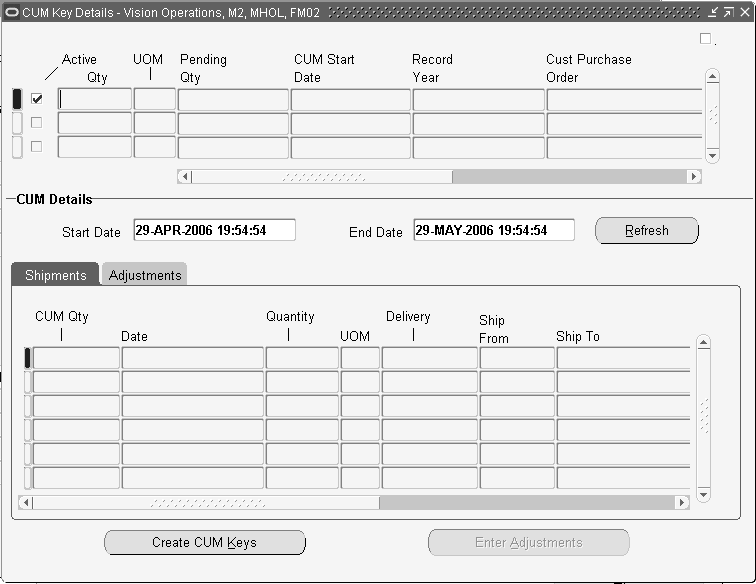

The CUM Key Details window displays CUM Key information including all associated shipment details and adjustment information relevant for the current business entity.
CUM Key Details Window
The title bar of the CUM Key Details window displays the name of the operating unit, ship-to location code, ship-from organization code, and customer item code. This window is separated into two regions:
At the top of the CUM key Details window, you will see information relating to the current CUM Key, including the following:
CUM key Active flag
CUM Quantity
UOM
Pending Quantity
CUM Start Date
Record Year
Customer Purchase Order
Last CUM Update Date
Creation Date
Comments
The lower portion of the CUM Key Details window contains the following tabs:
Shipments: Displays CUM Quantity, Date, Quantity, UOM, Delivery, Ship From location code, Ship To location, Intermediate Ship To, Bill To, and Last Shipped by user.
Adjustments: Displays Date, Quantity, UOM, adjustment Reason, Reference, and Last Adjusted By user.
Create CUM Keys: Opens the Create CUM Keys window.
Enter Adjustments: Opens the Enter a CUM Adjustment window.
Note: The total CUM is composed of shipments and adjustments. If an adjustment was made between one shipment and another, the running CUM on the shipments window will not appear to be consecutive, that is, the previous running CUM quantity plus the quantity on the current shipment line will not equal the new running quantity.
Active and Inactive CUM Key
The CUM Key Details Key window enables you to inactivate CUM keys. This window enables you to inactivate CUM keys that were created in error and to inactivate CUM keys you no longer need. If shipment or adjustment transactions exist for the CUM key, the system will issue a warning before it inactivates the CUM key and will ask for verification that you still want to inactivate this CUM key.
Inactive CUM keys are not considered for the following:
CUM processing by Demand Processor
CUM key adjustment program
CUM calculation at Ship Confirm
A new CUM key is active by default.
Navigate to the CUM Workbench.
Within the Find CUM Details window, enter your search criteria and click Find.
Click CUM Key to open the CUM Key Details window.
Click the Active Flag check box.
Add appropriate comments.
Save your work to change the CUM Key status and continue.

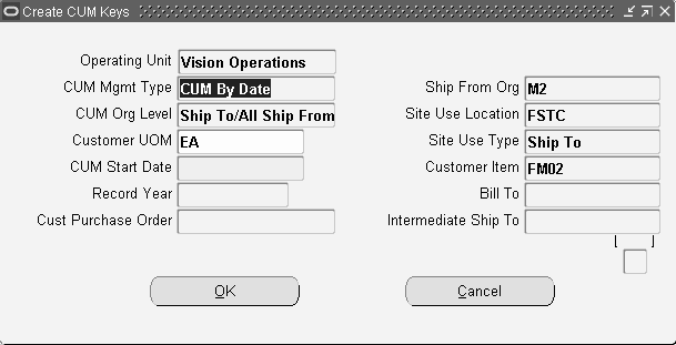

The Create CUM Key window enables you to create and define CUM keys for specific business entities. For example, you will create a CUM key when you need to enter a CUM Adjustment transaction to record the starting CUM Quantity before the first shipment of Oracle Release Management demand.
Navigate to the CUM Workbench window.
Click Create CUM Keys.
Create CUM Keys Window
Verify and change billing and shipping address values in the Create CUM Keys window.
Click OK to create a CUM key and continue.
Note: You cannot open this window if the CUM Management Type of the current ship-from/ship-to business entity is No CUM.

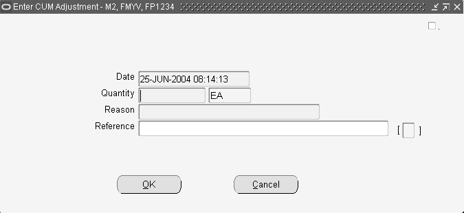

The Enter CUM Adjustment window enables you to create a CUM Adjustment Transaction associated with the current CUM key for the current ship-from customer item of the current business entity. You can enter only one CUM adjustment at a time for the current record in the CUM keys block.
Click Enter Adjustments to open the Enter CUM Adjustment window.
Enter CUM Adjustment Window
Enter the CUM Adjustment transaction date or accept the default.
This field defaults to the current system date and time. Enter the time if the customer's CUM Management Shipment Calculation rule has an associated cut-off time.
Note: If the CUM Management Type for this business entity is CUM By Date, CUM By Date/Record-keeping year, or CUM By Date/PO, this date cannot be earlier than the cumulative period start date for the CUM Key.
Enter the CUM adjustment Quantity in the unit of measure that appears.
This quantity cannot be zero. If you want to reduce the cumulative shipped quantity, enter a negative number.
Enter the reason code for this CUM Adjustment.
In the Reference field, enter any additional text to describe this CUM Adjustment.
Click OK to enter the CUM Adjustment and continue.
