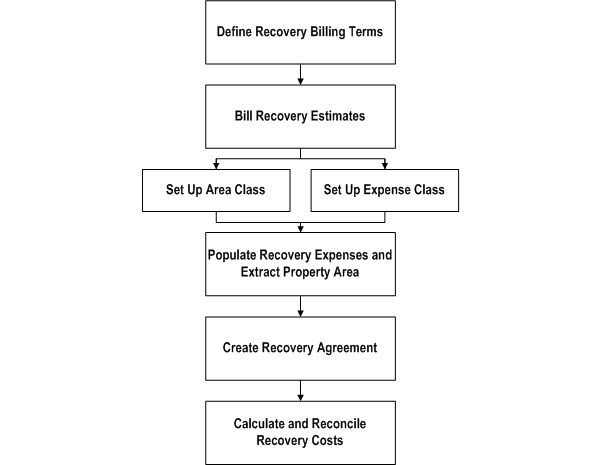

In the typical recovery process, landlords estimate annual recovery costs and distribute it between the tenants based on the tenants' occupied area. The tenants are billed accordingly throughout the year.
Landlords bill tenants for each type of expense to be recovered. For example, if a lease between a landlord and tenant includes terms for the tenant to pay a share of CAM expenses and taxes, then the landlord would enter two billing terms expense types: CAM and Taxes. A billing term is entered for each expense type. For each recoverable billing term, the Recoverable check box in the Billing tabbed region of the Leases window must be checked.
For information on entering billing terms, see: Entering Billing Information.
The landlord approves authorized schedules for the recovery calculation and exports the recovery amount to Oracle Receivables. In recoveries, the billed recovery amount is the total of expenditure items exported from the main lease for the recovery calculation period.
For example, if the authorized schedule for recovery costs is $1,000 per month and the billing items for the past twelve months have been exported to AR, then the billed recovery amount for that year will be $12,000.
For information on creating recovery schedules and exporting billed recovery amounts, see: Payment and Billing Events and Schedules.
In Property Manager, recovery costs are calculated by dividing the total expense incurred on a property by the area of the property and prorating the result by the tenant's occupied area. The expense class definition drives total expense, and the area class definition drives total area, used in the recovery calculation. Recovery setup involves the creation of the area and expense classes. The following diagram represents the recovery setup and extraction process.
The recovery setup process begins with the creation of area and expense classes. After area and expense classes are created, a concurrent program is run to extract recoverable expenses. You can use the concurrent program to populate the area and expense class details, or allocate expenses and modify the area and expense classes, and populate class details later. After the area and expense class details are created, it can be used in the recovery calculation.

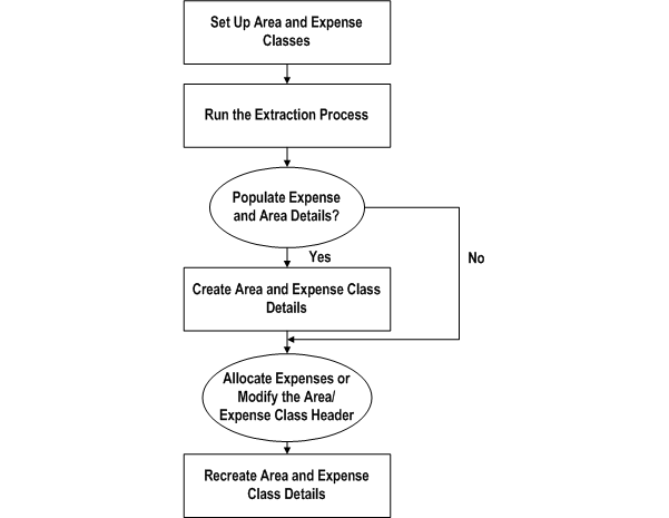

You can extract selected expense amounts from Oracle General Ledger and load them into the Expense Lines interface table using the Extract Expenses from GL concurrent program. For details, see Extract Expenses from GL.
The Extract Expenses from GL concurrent program uses an intersection or mapping table to map selected ranges of General Ledger accounts to a location and expense type. This table contains the following information:
The definition of the location to which the expenses are mapped.
The expense accounts that are mapped to the location.
The expense types that are assigned to expense accounts.
The flag indicating whether or not the expense amount is recoverable.
To create a General Ledger expense account mapping:
Navigate to the Expense Account Mapping window by choosing Setup: Expense Account Mapping.
Fill in the required fields.
Choose Save to save your mapping.
Mapping Name: Enter a name for the General Ledger expense account mapping. This field is required.
Property Name: Choose a valid value from the list of values. This field is optional.
Location Type: Choose a valid value from the list of values. This field is optional.
Location Code: Choose a valid value from the list of values. This field is optional.
GL Account From: Enter the beginning account segment values of the account range to include in the account mapping.
GL Account To: Enter the ending account segment values of the account range to include in the account mapping.
Expense Type: Enter the expense type to associate with the General Ledger accounts and location.
Effective From: The beginning date from which the mapping is effective.
Effective To: The ending date to which the mapping is effective.
Recoverable: Check the check box to mark the expense as recoverable when it is imported to expense details.
After you extract the selected expense amounts from Oracle General Ledger and load them into the Expense Lines interface table, use the Recovery Module Expense Lines Extraction concurrent program to import the selected recovery expense lines into the Recovery Expense Lines table. See: Recovery Module Expense Line Extraction.
Tip: You can set the Recovery Module Expense Line Extraction program to run automatically when you run the Extract Expenses from GL program. See: Extract Expenses from GL.
Related Topics
PN_REC_EXP_ITF, Oracle Property Manager Implementation Guide
Use the Recovery Module Expense Lines Interface Table Purge concurrent program to purge the records contained in the PN_REC_EXP_ITF open interface table. See: Recovery Module Expense Lines Interface Table Purge.
When you extract expenses using the Extract Expenses from GL concurrent program or the Expense Lines interface table, you can also populate the area and expense class details. If you populate the details, Oracle Property Manager generates area and expense class details through the expense extraction concurrent programs. If any changes are made to the area and expense class setup, or if expenses are to be allocated, then class details must be regenerated.
If you choose not to populate the area and expense class details, you can allocate expenses, change the area and expense class setup, and modify the extracted recovery expenses. You can populate the class details at a later time.
For information on the Populate Recoveries with Expenses concurrent program, see: Recovery Module Expense Line Extraction and Extract Expenses from GL.
The table below is a representation of the Recovery Expenses window after the successful completion of the extraction program. The key for the table is:

The expense class details must be recreated in the following scenarios:
The expense amount of any expense line is updated.
The expense amounts are further allocated.
See: Expense Allocation Example.

Recovery agreements define how recovery amounts are calculated and adjustments for recoveries billed over a given period. Generally, the recovery is done once a year after the year end. Recovery can be calculated more often if needed, such as in the case of new property developments, or when a new tenant is added in the middle of a year.
There are two steps involved in creating a recovery agreement. The first step includes entering the agreement details, such as tenant name, lease terms, and specifying recovery lines for all or part of the recovery agreement duration. The second step includes entering recovery lines details for the duration of a recovery agreement time period or less.
After the recovery agreement is set up, recovery can be calculated for specific periods. The recovery lines and line details of the specified periods are available for review after specifying the start date, end date, and the as of date of the period that needs to be calculated. One or more lines can be calculated simultaneously, and the Calculate Recovery concurrent program is available to calculate recovery for multiple agreements.
When the Calculate Recovery concurrent program completes, the recovery terms are populated. If subsequent changes are made to the recovery agreement or lines, you must recalculate to update the calculated data and recreate the recovery terms. By default, the recalculation process displays the last period calculated.
Note: If you recalculate an approved agreement line, a term for the adjustment amount will be created.
The Review Terms process is also period specific. The terms for the last calculated period are displayed by default.
Based on the Consolidate Recovery Terms system option, a term is created for each recovery line, or a consolidated term is created for all recovery lines for a period. All recovery lines must be successfully calculated in order to view consolidated term. Individual recovery terms or a consolidated term can be reviewed, and the associated amount can be approved. The diagram below illustrates the landlord recovery process.
