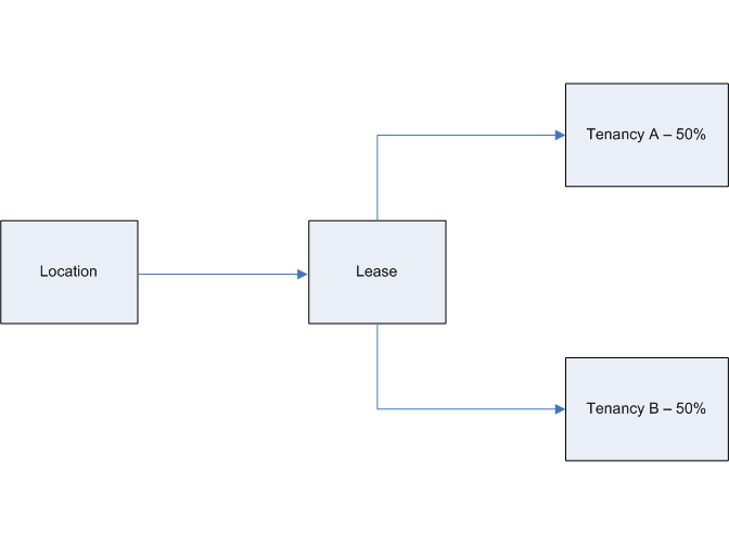

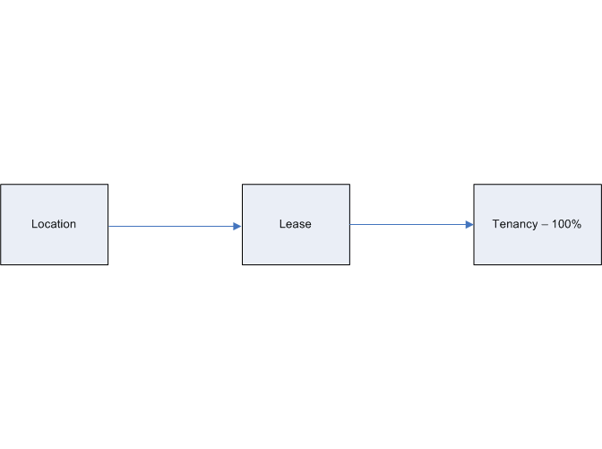

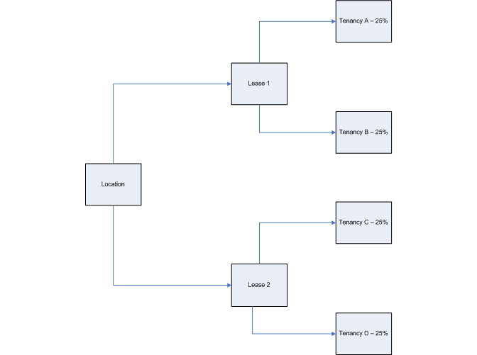

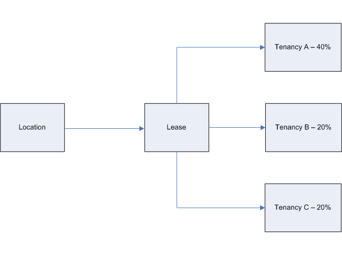

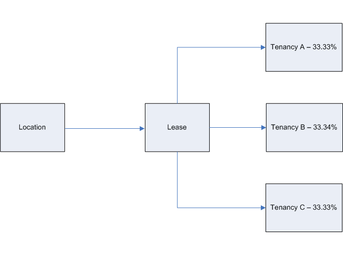

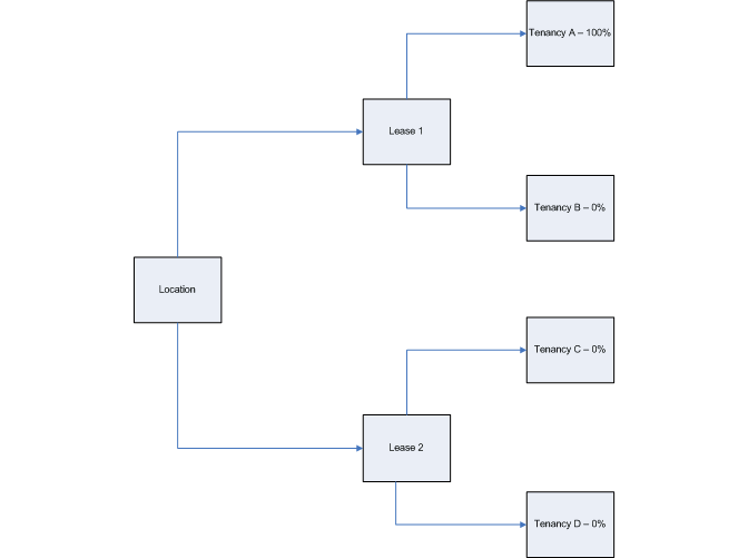

You can set the Allow Tenancy Overlap Within Lease system option to Yes if you want to allow users to assign a location to two tenants on the same lease.
Note: The combined percentage area assigned to the two tenants should be less than or equal to 100 percent.
If you set this system option to No, users will not be able to assign a location to two tenants using the same lease.

You can set the system options using varying combinations. With different system options combinations, the customer space assignment changes. The expected behavior of customer space assignments for varying system options combinations is as follows:
Allow Tenancy overlap within Lease: Yes
Multiple Tenancy Lease: Yes
Automatic Space Distribution: Yes
For this combination of system options, the following diagram describes the expected behavior of customer space assignments:
Multiple Tenancy Lease: No

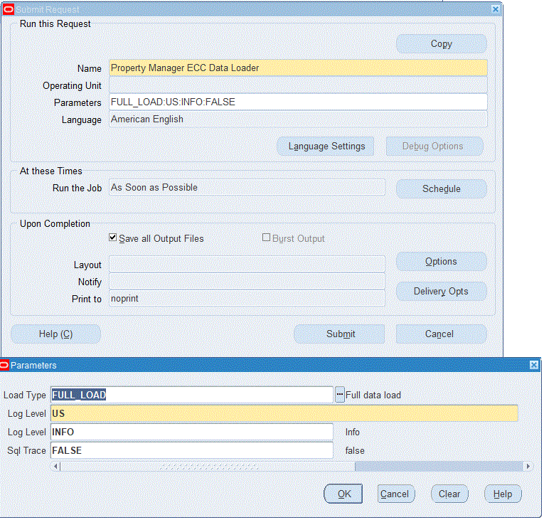

Run the concurrent program Property Manager ECC Data Loader to load Oracle E-Business Suite data into the Lease Contracts Command Center. You can find this concurrent program from the Submit Request window.
Note: Before you load data from Oracle E-Business Suite into the Lease Contracts Command Center, ensure that your EBS data is accurate and current by running any concurrent programs that impact attributes used in the command center.
Run the concurrent program from the Submit Request window.
To load Property Manager ECC data
In the Name field, enter Property Manager ECC Data Loader.
Select the appropriate load type:
Full Load: Loads all Lease Contracts data and is required to be run for the first data load. If you select and run full load for subsequent requests, then this program clears all Lease Contracts data from ECC and loads fresh data.
Incremental Load: Loads the data modified and updated from the previous load only. Incremental load should be scheduled to run as often as required to keep the ECC dashboard current.
Metadata Load: You must initially run the Metadata Load concurrent program to load Descriptive Flexfield (DFF) setup information to Enterprise Command Center. After the DFF setup is initially loaded, running Incremental or Full Load concurrent programs on a regular basis will maintain the DFF attributes. In this process, the application waits for other tasks such as consolidation, data entry, or other load processes to finish before proceeding to load the files.
Enter one or more language codes in the Languages field for the output. For multiple language codes, use the format AA,BB,NN. For example, enter US,AR,KO. If the field is blank, then the data will be loaded for the base language only (usually US).
Select the Log Level that you want the program to report. The default value is Error.
Select True to enable SQL trace. Otherwise, select False.
Submit the concurrent request.
Review your request using the Requests page.
Monitor data loading using the Data Load Tracking page of the ECC Developer responsibility.
