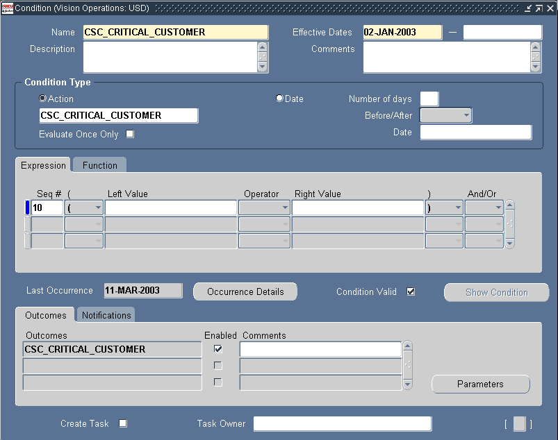

A relationship plan can take different actions on subsets of the qualifying customers. Now that you have assigned customers to the plan, you are ready to determine what actions you wish the plan to take for which customers.
You must define the actions and conditions separately.
For Plan B, create two conditions:
Condition B1: If a customer has orders of less than $1 million
Condition B2: If a customer has orders of more than $1 million
Then create two actions:
Action B1: Display alert.
Action B2: Display Script

When you create conditions of your relationship plan, you cannot directly specify the alert messages and scripts that the conditions are to launch. First, you must indirectly make this link by defining an "Outcome" for each script and message. Secondly, to create an outcome, you must define the script or message as a Process Definition of the type Outcome and then use the name of this process definition to create the link with the condition that triggers it.

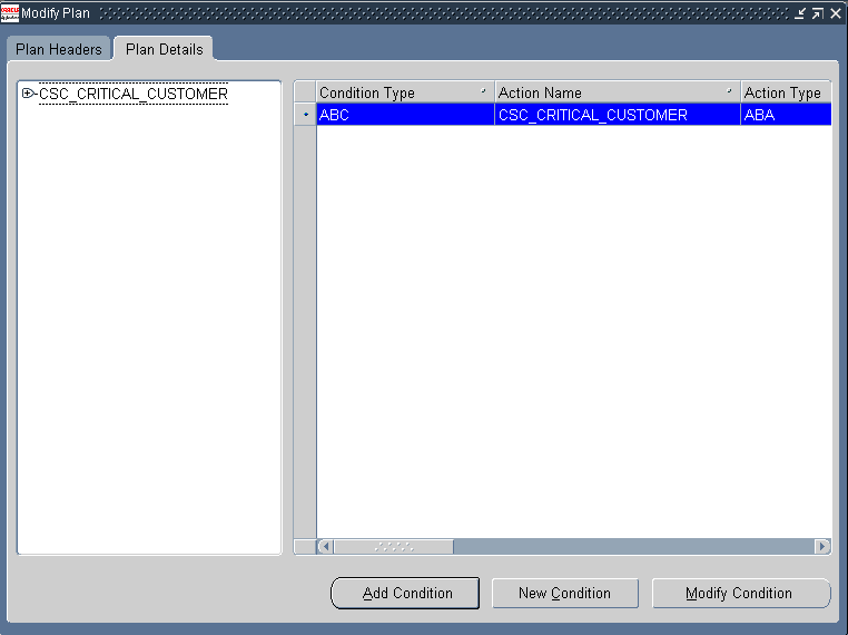

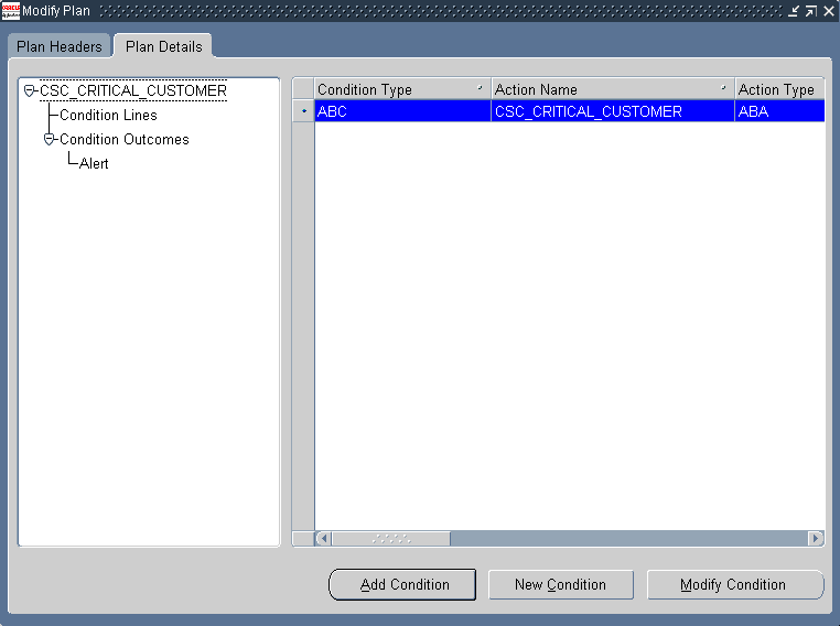

Switch to the Service responsibility and navigate to Setup, Relationship Plans, Events, Define Process Definition.
Create the outcomes for the conditions according to the steps outlined in Setting Up Messages and Scripts for Association with Relationship Plans.
To organize your relationship plans in categories, navigate to Setup, then Relationship Plans, and select Define Plan Groups, and define these categories as described in Defining Plan Groups.
You are now ready to create the relationship plan itself which ties together all of the setups you have done so far. In this step you enter both the condition that determines, which customers qualify for the plan and the other conditions that decide the action to be taken. The setup is done in the New Plan window (Setup, then Relationship Plans, and select Define Relationship Plans). For details, see:

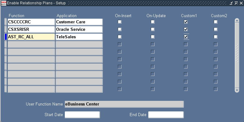

You must enable your plan for any of the forms where you wish the actions to appear. Navigate to Setup, then Relationship Plans, and select Enable Relationship Plans) and enable forms as described in Enabling Relationship Plans. The options are: Contact Center, Service Request, and the E-Business Center from Oracle TeleSales.

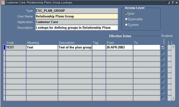

Use this procedure to organize your relationship plans into logical groups. Defining plan groups is optional.
Prerequisites:
None.
To define relationship plan groups
Under the Service responsibility, navigate to Setup, then Relationship Plans, and select Define Plan Groups.
The Relationship Plans Group Lookup window appears.
In a new row, enter a value in the Code field.
Enter the Meaning.
Enter the Description.
The Tag field is not used in Oracle Support.
Optionally enter dates in the From and To fields.
Save your plan group.

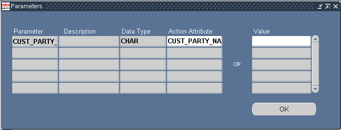

To display an alert message for agents as your action, you must define any tokens you wish to use in the message text in the Element Name field of the Basic tab. For example, to include the customer's name in the alert message, you must enter CUST_PARTY_NAME.
Note: You must enter the same token name when you set up condition to trigger this action. See Creating a Condition for the Relationship Plan.

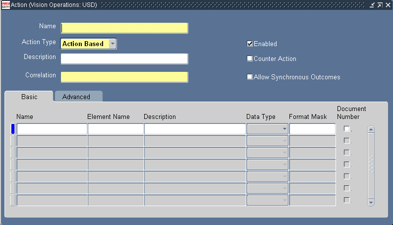

To define an action
Under the Service responsibility, navigate to Setup, then Relationship Plans, and select Events, Define Action.
The Action window appears.
Enter a name for your action in the Name field.
Select Action Based from the Action Type list. Date Based is not supported.
Optionally enter a description of your action in the Description field.
In the Correlation field, enter CSC_CONTACT_CENTER. This is the only valid name you can use for relationship plans.
Select the Enabled check box to make this action available for use.
Select the Allow Synchronous Outcomes check box to allow a real-time alert or script to pop up.
If your action displays an alert message, then in the Basic tab, enter any tokens you want to use in the message:
Note: You need not define any tokens for generic messages that apply to all customers.
In Element Name, enter a valid variable name.
You can obtain the list of valid Contact Center header variable names by querying up the Customer Care - Generic Action or from Appendix B of this guide.
For example, to display the full name of the customer in the alert message, enter CUST_PARTY_NAME.
You must also enter the same value in two other places: in the text of the message when you define the message in the Messages window and in the Parameters window when defining the condition that uses this action.
You can enter the same value in the Name field as in the Element Name field.
Optionally, enter a description in the Description field.
Select a data type of CHAR, NUMBER, or DATE in the Data Type field.
Select a format mask, if appropriate.
If your action is triggered by a condition that evaluates a variable, then define the variable in the Basic tab in the same manner as the message tokens above.
Save your action.

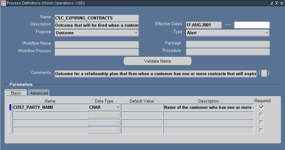

To define process definitions of type outcome
Under the Service responsibility, navigate to Setup, then Relationship Plans, then Events, and select Define Process Definitions.
The Process Definitions window opens.
In the Name field, enter the name of the script or message.
Select Outcome from the Purpose list. This is the only permitted value.
From the Type list, select either Alert or Script. The other types are not supported.
Optionally enter comments in the Comments field.
If you are creating the outcome for a message, then in the Name fields of the Basic tab of the Parameters region, enter the same values you entered for Element Name fields on the Basic tab of the Action window.
The Data Type field defaults to the data type of the Element Name.
Save your process definition.

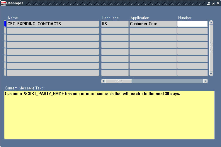

Messages are defined for use in displaying messages about customers in real-time alerts. Use the procedure given below to define alert messages the agents will see.
Prerequisites:
None
To define messages
Under the Application Developer Responsibility, navigate to Application, and select Messages.
The Messages window opens.
Enter a name for your message in the Name field. The name of the message must be identical (including capitalization) to the name of the action as this is the only link between the two. You must also use the same name when you create a Process Definition.
Select a language from the Language LOV.
Select Customer Care from the Application LOV to display the message in the Contact Center or Service to display it in the Service Request window, Customer Support, and Service Desk.
Entry in the remaining fields, Number, Type, Maximum Length and Description, are optional.
In the Current Message Text field, enter the message to display as a real time alert.
To display the value of a token, for example, the customer name CUST_PARTY_NAME, you must enter the token preceded with an ampersand symbol, for example, &CUST_PARTY_NAME.
You are restricted to using only the tokens that you have entered in the Element Name fields in the Action window. See Defining an Action.
Save your message.

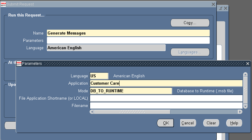

Use this procedure to generate the messages you have created.
To generate messages
Under the Application Developer Responsibility, navigate to Other, then Requests, and select Run.
Select the Single Request option in the Submit a New Request window and click OK.
Select Generate Messages from the Name list of values.
In the Parameters window enter:
Language: US or another message language
Application: Customer Care
Mode: DB_TO_RUNTIME
Click OK to close the Parameters window.
Click Submit.
Click No to submit another request.

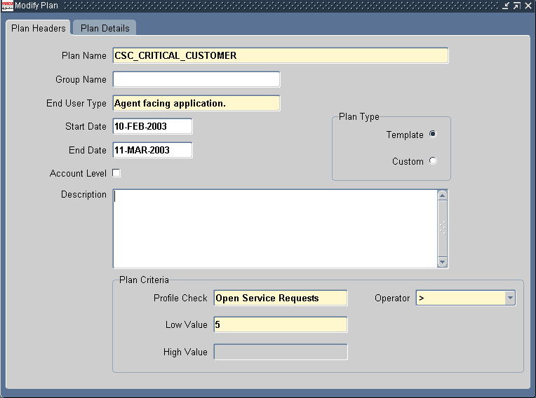

Under the Service responsibility, navigate to Setup, then Relationship Plans, and select Define Relationship Plans.
The New Plan window appears. (When you are modifying the plan, the name of this window changes to Modify Plan, but the functionality is the same.)
In the Plan Headers tab, enter a name for the plan in the Name field.
Select a group name from the LOV to group the relationship using relationship plan categories.
Optionally, enter start and end dates for the relationship plan.
Unless you want to create a plan for individual accounts rather than for customers, do not select the Account Level check box. For example, an account relationship plan can track customers who generate a significant amount of revenue in one account.
All relationship plans are initially created from a template, so the Template option is selected by default in the Plan Type section. The Custom option can be used only from the Inquiry tab when you customize a relationship plan for one specific customer.
Enter a description of the Relationship Plan in the Description field.
In the Plan Criteria section, you define the criteria to be used by the Relationship Plan Assignment Engine to decide which customers qualify for the plan:
Using the Profile Check list of values, select the profile check that summarizes the customer information you wish to evaluate. This window displays predefined profile checks as well as those you have defined.
Select an operator from the Operator LOV. The choices are =, <, >, >=. <=, Between, and Not Between.
Enter the constant in the Low Value field.
The high value is available only if you previously selected an operator value of Between or Not Between.
Save your relationship plan.

Select the Plan Details tab.
Click New Condition to create a new condition to trigger one of the actions as described in Creating a Condition for the Relationship Plan.

To create a condition for a relationship plan
Display the relationship plan where you want to create a condition.
Click New Condition
The Condition window appears.
Enter a name for the condition in the Name field.
Optionally, enter effective dates, description, and comments for the condition.
In the Condition Type region, select the Action option. The Date condition type is not supported in relationship plans.
Select an action from the Action LOV. The list of values contains actions that you previously defined. You must use a unique action for every relationship plan.
Don not select the Evaluate Only Once check box unless you want to evaluate your condition only once.
In the Outcomes region, use the Outcomes LOV to select the outcome, which represents the message or script you wantto display for customers matching this condition.
A relationship plan can display a message, a script, or both.
Outcomes, are the intermediaries which permit you to associate scripts and messages with relationship plans. They are defined in the Process Definitions window as described in Setting Up Messages and Scripts for Association with Relationship Plans.
If the outcome is a message that displays the value of one or more tokens, such as the customer's name, then you must reenter the same message tokens:
Click Parameters.
The Parameters window appears.
Note: If you have defined more than one outcome for this condition, then the application displays a different window. In this case you must first:
Select the parameter you wish to define.
Right click and select Populate selected rows in PARAMETERS from the menu.
Select the token from the Action Attribute list of values.
For example, if you are displaying the customer name in the body of the message then you must select CUST_PARTY_NAME in the Action Attribute.
Note: You may want the value in the Parameter and Action Attributes fields to be the same. But you are permitted to assign different values to the token in your message provided they are of the same data type. For example, to display the customer name in the message, you can map the full customer name, the first name, or the last name to that token using this window.
Click OK to return to the Conditions window.
Enter the condition that triggers the action, in the Expression tab. You can use the parameters you have just mapped.
Save the condition.

Select the Plan Details tab in the Modify Plan window.
Click Add Condition.
Select a condition and click OK to attach it to the plan header.

Use this procedure to enable relationship plans in different application modules: in the Contact Center and the Service Request and in the E-Business Center of Oracle TeleSales.
Prerequisites:
None.
To enable relationship plans
Under the Service responsibility, navigate to Setup, then Relationship Plans, and select Enable Relationship Plans.
The Enable Relationship Plans - Setup window appears.
The Function list of values displays all forms, but you must select one of the three following forms:
CSCCCCRC for Contact Center
CSXSRIXSR for Service Request
AST_RC_ALL for E-Business Center
Save your settings.
Note: Please see the appendix, Enabling Relationship Plans, for additional information.

The lookups described in this section make it possible for you to modify different lists of values for relationship plan setup.
Group Names for relationship plans
You can modify any of the meaning fields in the lookup described in the following table. It controls the list of values for the Group Name field.
| Lookup Type | Meaning | Lookup Codes | Meaning | Level |
| CSC_PLAN_GROUP | Relationship Plans Group | GROUP1 GROUP2 GROUP3 |
Plan Group1 Plan Group2 Plan Group3 |
User |
