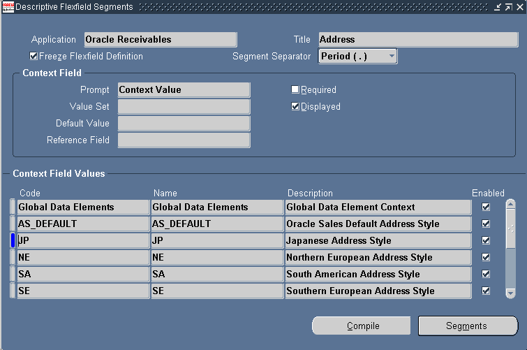

Under the Application Developer Responsibility, navigate to Flexfield, then select Descriptive, Segments.
The Descriptive Flexfield Segments window appears.
Search for Address in the Title field using the Query Enter / Query Run search method available from the View menu.
The Descriptive Flexfield Segments window lists the available address styles.
Create a record in the Context Field Values region but do not select the Freeze Flexfield Definition check box.
Enter the name of the style in the Code and Name fields.
Enter an optional description.

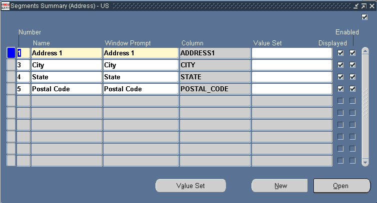

Click Segments.
The Segments Summary window appears.
Enter each element of your address style:
Enter a number that determines the order of the address element. The address elements appear in ascending order.
Enter the element Name and Window Prompt.
Select one of the available address components using the Column LOV.
Select the Displayed and Enabled check boxes.
Click Save.

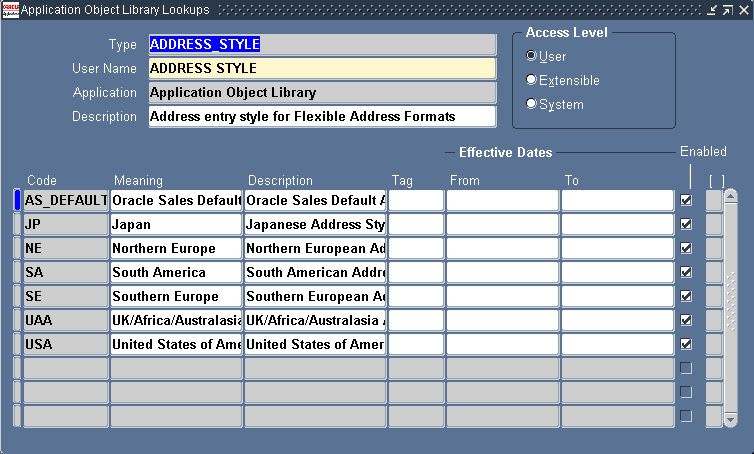

Navigate to Application, then Lookups, and select Application Object Library.
The Application Object Library Lookups window appears.
Search for ADDRESS_STYLE in the Type field using the Query Enter or Query Run search method available from the View menu.
The Application Object Library Lookups window lists the available address styles.
Enter the code for the address style. The value you enter in the Code field must match the code you have entered in the Context Field Values.
Enter the meaning.
Select the Enabled check box.
Click Save.
