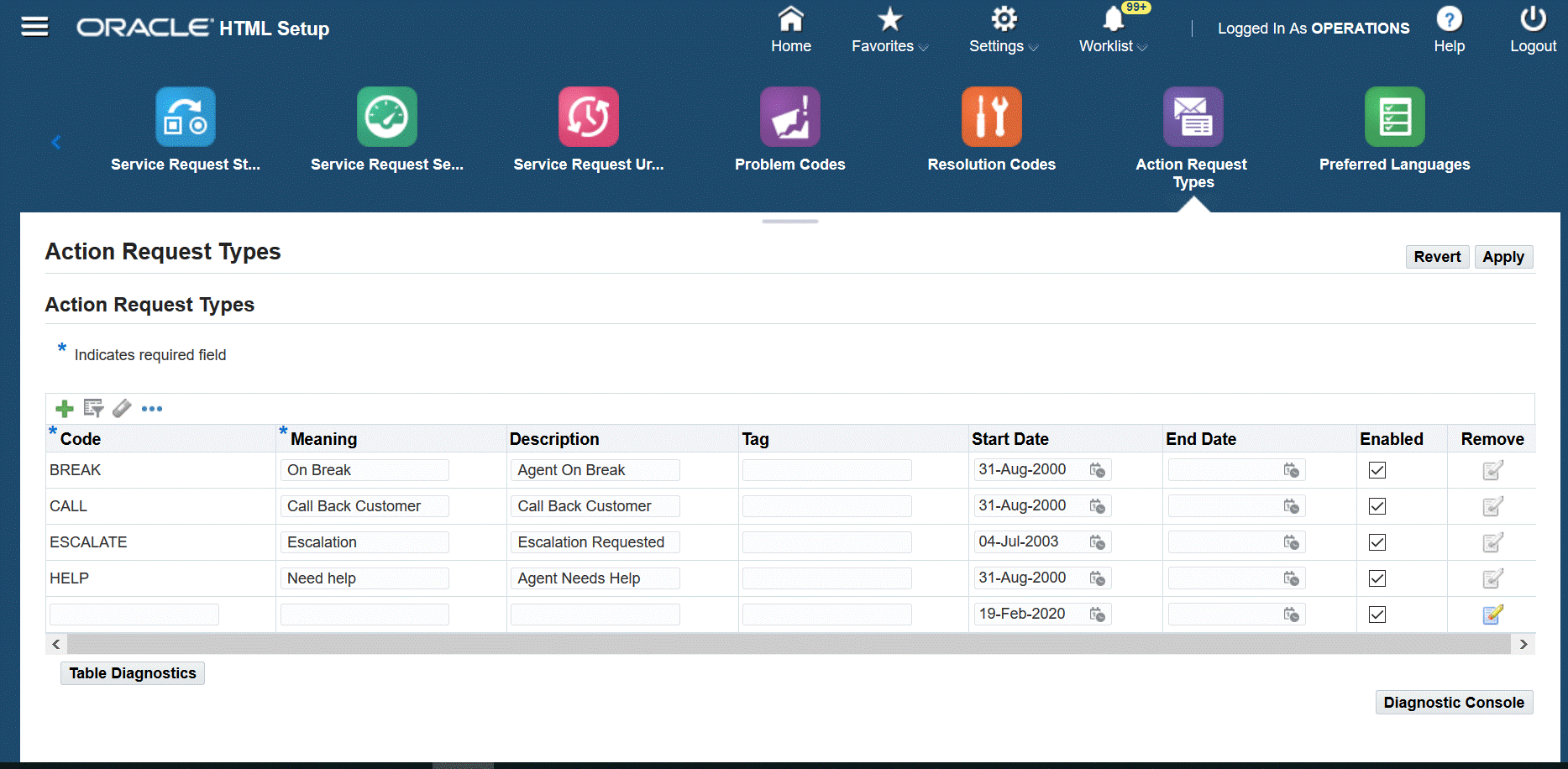

To setup a message action code
Navigate to the Service responsibility, Setup, Definitions, HTML Setup, and then Action Request Types.
The Action Request Types page appears.
Click the + icon. A row appears at the bottom of the table where you can enter the required details.
Enter a message action code in the Code field.
Enter a brief description of the code in the Meaning field.
Enter a full description of the code in the Description field.
Enter the start and end dates.
Select the Enabled check box to make the code available for use.
Click Apply to save the message action request code.
