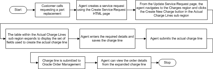

Shipping Replacement Parts to Customer
the picture is described in the document text
In the above diagram when a call center receives a customer call requesting for a part replacement, the agent creates a service request using the Create Service Request HTML page. The agent navigates to the Update Service Request page and then to the Charges region to create a charge for the part replaced. The agent enters all details regarding the charge and saves it. After the part has been replaced the agent submits the actual charge. The charge details are submitted to Oracle Order Management and the agent can view the corresponding order details in the Charges page.

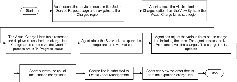

Agent Adjusts Price of a Debrief Created Charge Line
In the above diagram the agent adjusts the price for a Debrief created charge line. Agents can adjust the net price for a Debrief created charge line and submit these charge lines from the Charges page. After the charges lines are submitted to Oracle Order Management an invoice is created for it. The invoice details can be viewed in the Charges region under the Order sub region.
