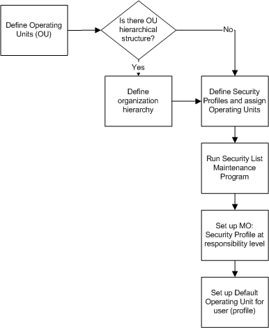

Setting Up Multi-Org Access Control (MOAC)
The Multi-Org Access Control (MOAC) feature, also known as Security by Operating Unit, enables you to access secured data in one or more operating units, within one responsibility. You can author contracts and contract templates in multiple operating units without switching responsibilities. The application maintains data security using security profiles that you define for a list of operating units and then determines the data access privileges for users. You can search and update contracts associated with your security profile from the Service Contracts Authoring form, the Mass Change form, Contracts Search form, as well as the Contract Navigator and Launchpad. Many reports include operating unit as a parameter.
Note: Entitlement search lists contracts information in the search results across all operating units. However, it restricts users from opening contracts to which they do not have access.
The following diagram shows the high level setups necessary to enable MOAC. For detailed information about implementing MOAC, refer to the Oracle E-Business Suite Multiple Organizations Implementation Guide.
the picture is described in the document text
The following describes the preceding diagram:
  1. Define operating units.
  2. Determine if an operating unit hierarchical structure exists.
  3. If yes, define the organization hierarchy. This setup must be done in Oracle Human Resource Management System applications.
    If no, skip to the next step.
  4. Define security profiles and assign operating units. This setup must be done in Oracle Human Resource Management System applications.
  5. Run the Security List Maintenance program.
  6. Set up MO: Security Profile at the responsibility level.
  7. Set up the default operating unit for the user (profile).
