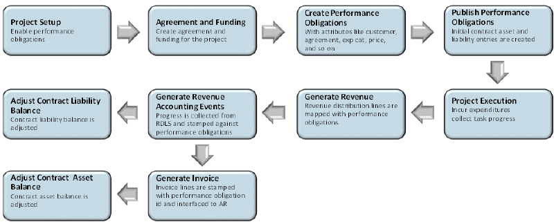

The preceding flow chart shows the revenue recognition for the IFRS-15 process.

IFRS 15 Business Process
The preceding flow chart shows the IFRS 15 business process.
Identify the contract with the customer.
Identify all individual performance obligations within the contract.
Determine the transaction price.
Allocate the transaction price to the individual performance obligations.
Recognize the revenue when the performance obligations are fulfilled.
This section details the processes for non-SOV projects.
Non-SOV Project with RMCS Disabled
The preceding flow chart shows the process for a non-SOV project with RMCS disabled.
Create a project.
Baseline funding.
Define performance obligation.
Publish performance obligation.
Collect task progress.
Generate revenue.
Generate revenue accounting events, go to Step 8 or Step 9.
Generate contract liability.
Generate invoice, go to Step 10.
Adjust contract asset balance.

The Enable Integration with Revenue Management in Cloud Service flag can be selected during project setup. Projects with this flag enabled may be integrated with Revenue Management in Cloud Service. For such projects, the performance obligations and the corresponding progress against them are sent to RMCS for further revenue reallocation and revenue recognition. When this flag is enabled, the field End Date for Interfacing Accounting entries to SLA can be updated. You can specify a date and post the contract asset, contract liability and revenue accounting entries that shall not be interfaced to SLA. This flexibility allows you to control when to cut off the flow of accounting information from Projects to SLA.
The following describes system requirements and behaviors:
Enable integration with RMCS flag appears when performance obligations are enabled.
Enable integration with RMCS flag can be checked anytime during the project.
Once performance obligations have been interfaced to RMCS this flag cannot be disabled.
Integrating Performance Obligations and Progress with RMCS
For the projects with the Enable Integration with RMCS flag checked, the published performance obligation lines are pulled into RMCS. From the OA page navigate to the Structures section in the Setup page. The contract in RMCS is created for a combination of the project and the agreement. The performance obligation lines with same combination of project and agreement from Projects are placed under that contract.
Changes to the published performance obligations are automatically recognized by RMCS.
Progress populated against performance obligations are pulled by RMCS in the form of satisfaction events.
Progress is sent to RMCS in terms of quantity for the quantity based performance obligations, and percentage for the currency based performance obligations.
The performance obligations must be in Published status to be pulled into RMCS.

First, run the program in Create mode. The program creates performance obligations for existing projects based on the funding summary of the project. These performance obligations will have currency as their UOM. After the performance obligations are created you can edit them in the Performance Obligations page.
For upgraded projects you cannot publish the performance obligation from the performance obligation page. You must resubmit the UPG: Enable Projects for Performance Obligation Accounting program in publish mode in order for the performance obligations to be published and for the accounting entries to be created. This launches the PRC: Generate Initial Performance Obligation Accounting Events program and the PRC: Create Accounting Events program.
If any of the programs have an error, the following message appears, "Performance Obligations could not be published due to error. You can rectify the error and publish the performance obligations." You can select View Concurrent Process to view the status of the process. You must fix the error condition and resubmit the UPG: Enable Projects for Performance Obligation Accounting program set to Publish and the Rerun for Accounting Errors value set to Yes, which will launch the accounting programs.
The program maps the existing revenue distribution lines to performance obligations and stamps the performance obligation id on the RDL to derive progress against the performance obligations posted within the Progress Percentage column. It also creates accounting entries. For projects without funding, the program simply enables the performance obligations flag. After a project has successfully completed by the upgrade program, it will not be picked up again in subsequent runs.
