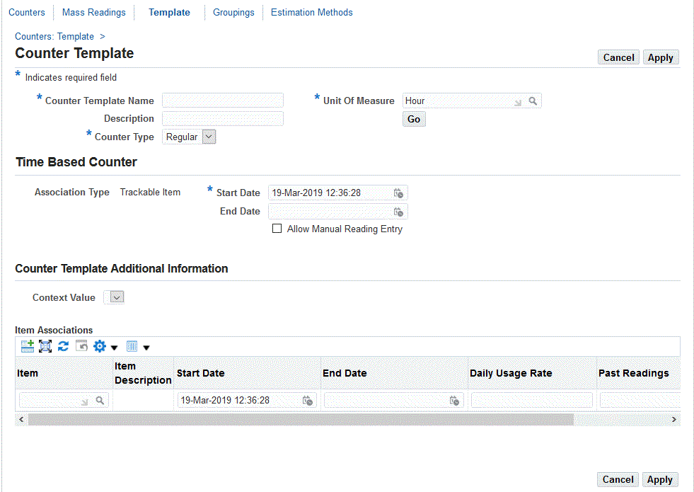

Creating and Updating Estimation Methods
The process of creating and updating estimation methods are similar.
Prerequisites
Oracle Installed Base Agent User > Counters > Estimation Methods > Create or Update button

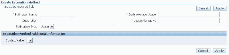

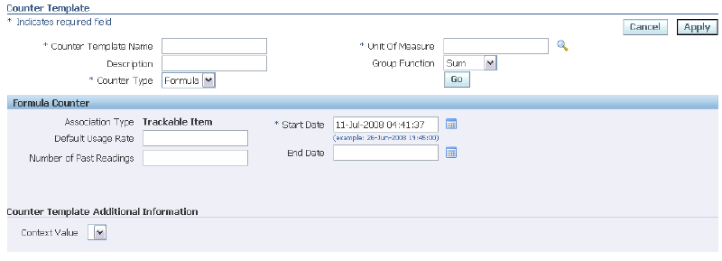

General Information
Apart from specifying a name for the estimation method, the main choice you have is to select the Estimation Type and fields associated with your choice of Estimation Type.
the picture is described in the document text
Estimation Type
Select either Usage or Fixed.
Daily Average Usage and Usage Markup%
These fields appear only if Estimation Type is Usage.
Both of these fields are used in the situation where there has been only one previous reading. In this case, they are used to calculate the estimated reading for a particular date, say, date X, as follows:
  1. Multiply the number of days from the previous reading date to date X by Daily Average Usage; increase the result by (Usage Markup%)/100.
  2. Add the final result to the previous reading.
For example:
The calculation for the estimated reading is as follows:
Usage Markup% is also used where there are several previous readings, and the date for which you want to calculate an estimated reading, say, date Y, is after the latest reading.
The calculation depends on a number of factors, but the general principle is that the system calculates an average daily usage based on the previous readings. This calculated average daily value is then multiplied by the number of days from the latest reading to date Y. The result is then added to the latest reading to give the estimated reading for date Y.
For example:
Fixed Multiplier Value
This field is used only if Estimation Type is Fixed, and there has been only one previous reading.
It is used to calculate the estimated reading for a particular date, say, date X, as follows:
  1. Multiply the number of days from the previous reading date to date X by Fixed Multiplier Value.
  2. Add the result to the previous reading.

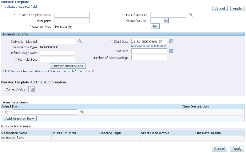

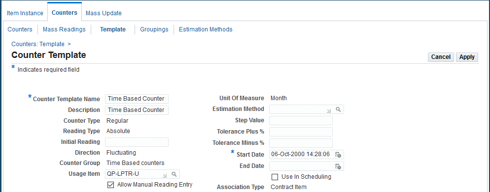

Counters Setup Overview
In Oracle Installed Base:
There are two main stages in setting up counters to enable the automatic creation of counter instances by Oracle applications:
  1. You must set up a counter template, and for contract item counters, a counter group as well.
    Note: A counter template that does not belong to a counter group is called a standalone counter template.
  2. You must associate the counter with either a contract item or a trackable item - you do this by associating items either to a counter group or to a counter template. For details, see the sections that follow.
    For contract item counters, you must specify a usage item for the counter template.
    Note: If an item has been associated with a counter group, it cannot be associated with any other counter group nor any standalone counter template.
    Note: If an item has been associated with a standalone counter template, it can be associated with other standalone counter templates, but cannot be associated with any counter group.

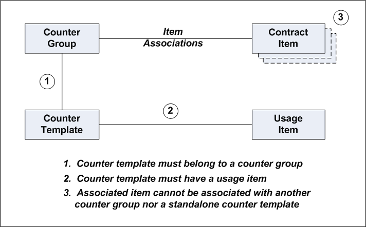

Contract Item Counter Setup Overview
The diagram following shows an overview of the main elements involved in setting up a counter for contract items.
In general, you can create multiple counter templates in the same counter group. Each counter template requires a usage item.
For contract item counters, item association to the counter template is always via the counter group. All counter templates in a counter group have the same item associations.

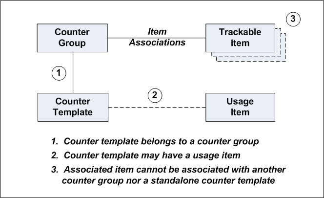

When you are setting up counters for contract items, you must first create a counter group with Association Type = Contract Item, and associate contract items to the counter group.
Then for each counter template that you want to add to the counter group, perform the following operations:
See Also

Setup Using Grouped Counter Templates
The following diagram shows an overview of the main elements involved in setting up a counter for trackable items, where the counter template belongs to a counter group.

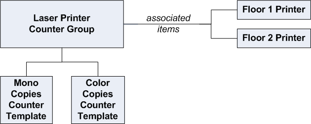

When you are setting up counters for trackable items using counter groups, you must first create a counter group with Association Type = Trackable Item, and associate trackable items to the counter group.
Where counter templates belong to a counter group, item association to the counter template is always via the counter group. All counter templates in a counter group have the same item associations.
Note: After an item has been associated with a counter group, it cannot be associated with any other counter group nor any standalone counter template.

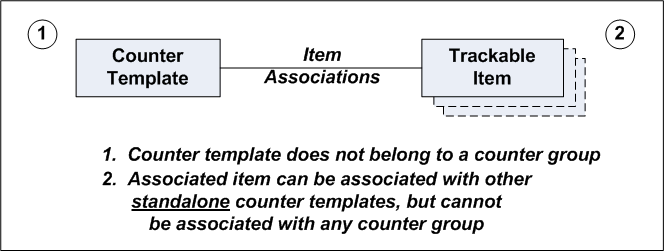

Setup Using Standalone Counter Templates
The diagram following shows an overview of the main elements involved in setting up a counter for trackable items, using standalone counter templates.
When you are creating standalone counter templates, by default you can only associate trackable items to the counter template.
Note: After an item has been associated with a standalone counter template, it can be associated with other standalone counter templates, but cannot be associated with any counter group.

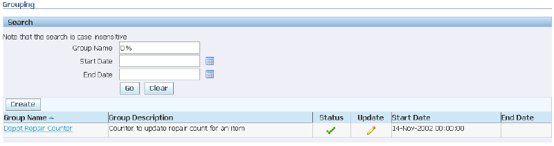

Searching for Counter Groups
In the Search Grouping page, the main operation you perform is to search for existing counter groups. You can then view or update the details of existing counter groups.
In this page, you can also start the process of creating a new counter group.
Prerequisites
Oracle Installed Base Agent User > Counters > Groupings
Steps
  1. Enter search values as required into one or more of the following fields: Group Name, Group Description, Start Date, and End Date.
  2. Click Go.
    The results area displays a list of the found counter groups.
Comments
In the results area, you can perform the following operations:

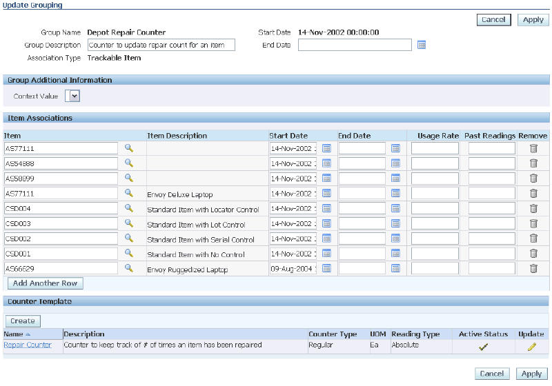

Creating Counter Groups
The Create Grouping page is for creating a counter group, with an Association Type of either Contract Item or Trackable Item.
Either at creation time, or subsequently, you must add item associations of the correct association type to the counter group.
When you are setting up counters for contract items, you must first create a counter group with Association Type = Contract Item, and associate contract items to the counter group. Then you must create a counter template that belongs to the counter group - you can do this either when you create or when you update the counter group.
Prerequisites
From the Search Groupings page, click Create.
If you want to add item associations, the items must be trackable items or contract items, as set up in the Master Item list in inventory.
Steps
General Fields
  1. You must enter a Group Name, and you must select a Start Date.
  2. Select an Association Type - either Contract Item or Trackable Item.
Item Associations
The types of fields you associate with the counter group depend on the Association Type.
For each item that you want to associate:
Counter Template
  1. Click Create to start the process of creating a counter template.
    The counter template that you create from this page will belong to the counter group.
    In the Counter Template page, enter the counter template details. For more information, see Creating Counter Templates.
  2. When you finish, and click Apply, you return to the Create or Update Grouping page.
    Note: You can create several counter templates for the counter group. For each counter template, repeat steps 1 to 2.
  3. Click Apply to complete the creation process, or Cancel to abandon the process.
See Also
Viewing Counter Groups
The View Groupings page is a read-only page that allows you to view details of a counter group, such as its association type, item associations, and counter templates.
Prerequisites
From the Search Groupings page, you must have clicked a Group Name link.
Comments
To update counter group details, you must first return to the Search Grouping page, then click the Update icon for the counter group.
See Also
Updating Counter Groups
The process of updating a counter group is similar to the counter group creation process. You cannot change the Group Name nor the Association Type.
From the Update Grouping page, you can perform the following operations:
For more details, see Creating Counter Groups.

Creating Standard Regular Counters (Templates and Instances)
Use this procedure to define counter types that are described as physical or standard regular counters, which typically are found in tangible objects such as automobiles, gas meters, and photocopier machines.
A standard regular counter can also be classified as a logical counter. For example, a service agent wants to track the number of support calls that he receives each day. The agent can set up a standard regular counter, and manually increment this counter at the completion of every support call.
Prerequisites
For counter templates: Oracle Installed Base Agent User > Counters > Templates > Create
For counter instances: Oracle Installed Base Agent User > Counters > Counter Instances > Create
Steps
  1. Select Regular for the Counter Type.
  2. Select Ea for the UOM (Unit of Measure).
  3. Click Go.
    The Regular Counter area appears.
    The page layouts for counter templates and counter instances are similar. For the differences, see Differences between the Counter Template and Create Counter pages
    Regular Counter
  4. Enter the Counter Template Name.
  5. Optionally enter the Description.
  6. Select the Reading Type, either Absolute or Change.
    • Absolute (Meter) - Meter counters allow you to enter meter type of readings such as odometers and electricity meters.
    • Change (Usage) - Usage readings allow you to enter the usage of a counter. An example of change readings is the number of minutes used on a prepaid telephone calling card, such as 12, 10, 6, 15, which represent calling card usage.
  7. Select the Usage Item.
    This is mandatory for contract item counters, optional for trackable item counters.
  8. Select the Direction - Ascending, Descending, or Bi-directional.
  9. If the Direction is Ascending or Descending, you can optionally check Automatic Rollover; if you do, then you must specify appropriate values for Rollover From and Rollover To.
  10. The Association Type appears as a read-only field. For standalone templates, the value is Trackable Item. For grouped counter templates, the value is derived from the counter group.
    Note: The Association Type does not appear in the Create Counter page.
  11. Optionally, enter the counter Step Value.
    For example, if you want the counter to be incremented by 1 for each reading, then enter 1 for the Step Value.
  12. Optionally, select an Estimation Method.
    You can only associate or map an estimation method for counters whose Direction is Ascending or Descending.
    If the counter's Direction is Bi-directional, the Estimation field remains protected and no list of values is available for association.
    Note: Estimation methods are mapped only to regular counters. When a counter is instantiated, the estimation method defaults from the counter template. You can modify and select a different Estimation Method prior to entering counter readings for this instance.
  13. If the counter is service contract related, enter the Tolerance Plus% and Tolerance Minus%.
    Tolerance is used by Oracle Service Contracts events to determine the range in which the counter should be updated.
  14. Select the Start Date, and optionally the End Date.
  15. Optionally, enter the Initial Reading of the counter.
    For example, a new automobile may have an initial reading on the odometer of 000022 miles accrued during testing and delivery.
  16. Optionally, select the check box Use in Scheduling if the counter is to be used in Oracle Enterprise Asset Management. If you do this, then you must specify the Default Usage Rate and Number of Past Readings.
    Source Counter (Create Counter page only)
    Use this screen area only if you want the counter instance that you are creating to be a target counter instance.
  17. Enter the Source Counter Name.
    This is the source counter instance from which the target counter instance derives its values.
  18. Enter a Factor.
    This is the multiplier value to apply to the source counter instance readings.
  19. Enter a Start Date, and optionally an End Date.
    Counter Properties
    Counter properties are optional attributes whose values you want to attach to counter readings. You can either set up counter properties in advance, or enter them directly in this page without any previous setups. For more details of setting up counter properties, see Overview of Setup and Usage of Counter Properties and Example of Setup and Usage of Counter Properties.
    Perform the steps in this section for each counter property that you want to add to the counter template:
  20. Enter a Property Name.
    Property Name is a free-form text field, that you specify for the particular counter.
  21. Select a Data Type of Character, Date, or Number.
  22. Check the Null Allowed check box if you want the column property to be optional for counter readings; uncheck the field, or leave it blank, to make the column property mandatory for counter readings.
    Note: The initial setting of Null Allowed is not checked.
  23. Optionally, select a Unit of Measure.
  24. If you want to have a predefined property value type for this counter, select from the list of values in the Property Value Type field, else leave the field blank.
  25. Optionally, enter a Default Value, if you want this value to appear initially when you capture counter readings.
    The following is an example of the fields to enter for a free-form counter property:
    • Property Name = Reader Name
    • Data Type = Character
    • Default Value = Dan Wong
    The following is an example of the fields to enter for a predefined counter property:
    • Property Name = Reading Method
    • Property Value Type = MR_MTHD
    • Default Value = EMP_READ
  26. Optionally, enter Minimum and Maximum Values for Number counter properties.
  27. Enter an effective Start Date on which to enable the property type, and optionally an End Date from which to disable the property type.
    Item Associations (Counter Template) or Associations (Counter Instance)
  28. Create the associations for the counter template or counter instance.
    For details, see Associating Objects to Counters (Templates and Instances).
    Completing the Process
  29. Click Apply.

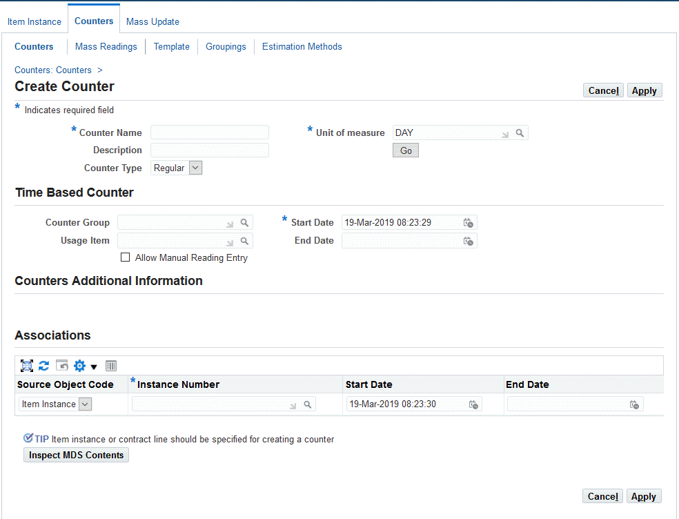

For both counter templates and counter instances, you must associate the counter to one or more real-world objects.
Item Associations Area (Counter Templates)
Grouped counter templates are automatically associated to contract items or trackable items - through the item associations of the counter group. The Item Associations area is read-only in this case.
For standalone counter templates, you must explicitly create the associations between the template and trackable items, in the Item Associations area.
Associations Area (Counter Instances)
For counter instances, you must create the associations between the counter instance and either service contract lines or item instances, in the Associations area.
Steps
Perform the steps in this section for each association that you want to add to the standalone counter template or counter instance.
  1. For a counter template, select the Item - contract or trackable.
    Continue at step 3.
    Note: Only trackable items are available for standalone counter templates.
  2. For a counter instance, select the Source Object Code - item instance or service line - and the appropriate Instance Number or Service Item and Contract Line Details.
  3. Enter the Start Date.
  4. Optionally, select an End Date.

Creating Time-Based Regular Counters (Templates and Instances)
A time-based counter is a regular counter with a time-based unit of measure, such as hours, days, weeks, months, or years, designed to keep track of events that occur in time. Time-based counters can be used to track such events as a contract expiration or preventive maintenance service that is due on an item instance.
Time-based counters can be updated periodically by running a concurrent program called Time Based Counters Engine to increment each counter and automatically expire a counter that has passed its expiration date.
In addition, you can manually enter readings for time-based regular counters.
For more information, see Setting Up Visit Work Package in Oracle Installed Base Implementation Guide.
Prerequisites
Steps
  1. Enter the Counter Template Name.
  2. Optionally enter the Description.
  3. Select Regular for the Counter Type.
  4. For the UOM (Unit of Measure), select a unit that has a UOM class of Time.
  5. Click Go.
    The Time Based Counter area appears.
    The page layouts for counter templates and counter instances are similar. See Differences between the Counter Template and Create Counter pages.
  6. Select the Allow Manual Reading Entry check box if you want to enable users to manually enter time-based readings. The default value is not selected.
  7. The Association Type appears as a read-only field. For standalone templates, the value is Trackable Item. For grouped counter templates, the value is derived from the counter group.
  8. Select the Usage Item.
  9. Select the Start Date, and optionally the End Date.
  10. Create the associations for the counter template or counter instance.
  11. Click Apply.

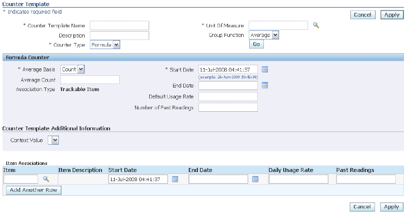

Creating Formula Counters (Templates and Instances)
Use this procedure to define a counter of the type Formula, where you explicitly enter a simple or complex mathematical formula to derive a new counter value. This procedure is stated in the context of a specific business case and example steps that include standard regular counters.
The formula text for a formula can only refer to counters that are standard regular counters.

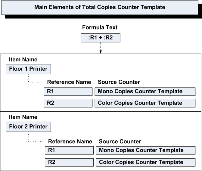

Business Case
A service provider sells and leases laser printers and wants to track the copy usage for each printer residing in Oracle Depot Repair. The service provider creates a counter group with individual counters to track the usage for each item to determine how often to perform his PM service tasks, and also to determine how often to ship out consumables such as toner kits and paper.
The counter group, its associated items, and the counter templates in the counter group are illustrated in the following diagram.
Example Task
The objective is to define a formula counter template named Total Copies Counter Template, that for each associated item of the counter group, sums the copy counts from the two standard regular counters.
Assume that the following elements have already been created:
  1. The counter group named Laser Printer Counter Group.
  2. The standard regular counter template named Mono Copies Counter Template.
  3. The standard regular counter template named Color Copies Counter Template.
Prerequisites
Steps
  1. Select Formula for the Counter Type.
    Note: Do not select a Group Function.
  2. Click Go.
    The Formula Counter area appears.
    Formula Counter
  3. Enter the Counter Template Name.
  4. Optionally enter the Description.
  5. Select the Usage Item.
  6. The Association Type appears as a read-only field. For standalone templates, the value is Trackable Item. For grouped counter templates, the value is derived from the counter group.
  7. Optionally, select an Estimation Method.
  8. Select the Start Date, and optionally the End Date.
  9. For Oracle Enterprise Asset Management meters, specify the Default Usage Rate and Number of Past Readings.
  10. Enter the Formula Text that you wish to use for the counter, with each formula reference name immediately preceded by the ":" symbol. The syntax is any valid expression in standard SQL.
    For example, to create a formula that sums the values of two counters, you can enter the formula :R1+:R2.
    An example of a more complex formula is:
    decode (sign((:P1+(2*:P2))-:PTOTAL),-1,0,((:P1+(2*:P2))-:PTOTAL))
  11. Click Validate Formula Text.
    The system scans the Formula Text and detects each reference name. These reference names appear in the Reference area for each selected item.
    The steps that follow describe in general how to complete the definition of the formula-related fields in the Item Associations, Associations, and Reference areas.
    For a diagrammatic overview of how to use the Item Associations and Reference areas for a counter template, and how to map counters to reference names, see Entering Formula Details.
    To view the formula-related fields for the Total Copies Counter Template example, see Entering Formula Details Example.

When an active formula counter template references one or more standard regular counter templates, and one of the associated trackable or contract item instances is created, then all the counters are instantiated for that item instance, that is, the formula counter instance and all the standard regular counter instances.
See Also
The following diagram illustrates the process of entering the formula-related fields in the Item Associations and Reference areas, for a counter template, and how they relate to the formula text
To view the formula-related fields for the Total Copies Counter Template example, seeEntering Formula Details Example.
The following diagram illustrates the main elements in the business case example described in the topic Creating Formula Counters.
In this example, both the items, Floor 1 Printer and Floor 2 Printer, that are associated to the Laser Printer Counter Group are shown, together with their source counter mappings to both of the reference names, R1 and R2.
  2. Select Average for the Group Function.
  3. Click Go.
    The Formula Counter area appears, with some fields specific to average counters.
    The page layouts for counter templates and counter instances are similar. For the differences, see Differences between the Counter Template and Create Counter pages.
    Formula Counter (Average)
  6. Select the Source Counter.
    This is the standard regular counter from which the average is calculated.
  7. Select the Average Basis, either Count or Time.
  8. If you selected Count for Average Basis, enter Average Count. This is the number of previous readings of the source counter to select for average calculation.
    If you selected Time for Average Basis, select the Average UOM. The difference between the first and last readings is taken, and the average value per day, month, year - whatever you selected for Average UOM - is calculated.
  9. Select the Usage Item.
  11. Select the Start Date, and optionally the End Date.
  12. For Oracle Enterprise Asset Management meters, specify the Default Usage Rate and Number of Past Readings.
  13. Create the associations for the counter template or counter instance.
  14. Click Apply.
See Also

Sum counters provide an accumulated total of the counter readings for a standard regular counter. Count counters provide a count of the total number of readings that have occurred prior to resetting a counter. For example, consider a counter that had three readings and was reset after the last reading. If the three readings are 100, 100, 100, then the sum counters returns 300, and the count counter returns 3.
You can also filter the data for count and sum counters which satisfy counter property conditions. The counter properties and values must have been defined in the standard regular counter from which the count or sum counter is derived.
Prerequisites
Steps
  2. Select Sum or Count for the Group Function.
  3. Click Go.
    The Formula Counter area appears, with some fields specific to sum and count counters.
    Formula Counter (Count and Sum)
    This is the standard regular counter from which the sum or count is calculated.
  8. The Association Type appears as a read-only field. For standalone templates, the value is Trackable Item. For grouped counter templates, the value is derived from the counter group.
  10. For Oracle Enterprise Asset Management meters, specify the Default Usage Rate and Number of Past Readings.
    Filters
  11. Optionally, enter and select information for any filters that you want to add to the count or sum counter template.
    • The properties and values must have been defined as counter properties and values in the source counter.
    • You can add extra rows for multiple conditions. Select AND or OR for the Logical Operator in all rows except the last row. The columns headed "(" and ")" allow you to select different parenthesis options for complex conditions.
      Note: Multiple conditions are evaluated according to standard SQL rules. For example, if explicit grouping using parentheses is not specified, AND conditions are evaluated first, then OR conditions.
  12. Create the associations for the counter template or counter instance.
  13. Click Apply.
See Also

Updating Counter Templates
Use the Counter Template page to update any available fields that are not read-only. The process of updating a counter template is similar to the counter template creation process. For more details, see Creating Counter Templates.
  1. Navigate to the Counter Template page (Oracle Installed Base Agent User > Template < [search for counter template] > Update button).
    The Counter Template page appears.
  2. Select the Allow Manual Reading Entry checkbox to enable users to manually enter time-based readings.
  3. Revise other available fields as necessary.
See Also
