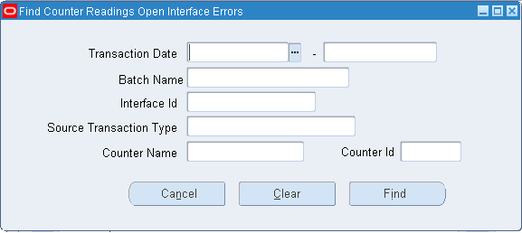

After you run the program, failed records go to the Open Interface error table.
To review and edit failed records, select the Open Interface Error Details from the Oracle Installed Base Administrator menu options.
Select values to filter the error rows, and click Find.
The Counter Readings Open Interface Error Details page displays the error records in the interface tables.
Select a row in the Readings area to see associated records in the Property Readings area.
In this page, scroll across to see all the fields, and edit the records that you want to change.
