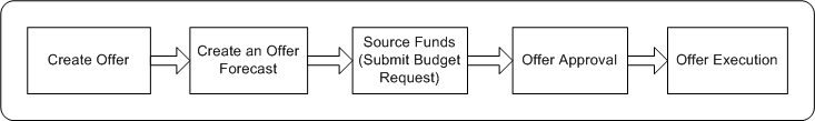

The following figure illustrates the process flow for offers:
Process Flow for Offers
Create Offer
Offers are created to offer discounts and promote sales. You can create different kinds of offers based on the sales objectives. You can also specify the discount levels, date qualifiers, and market eligibility for the offer.
Create Offer Forecast
Creating an offer forecast enables you to predict the performance of new offers by utilizing base sales data (sales data of the previous year). You can optionally create Offer Creation offer forecasts at any time irrespective of the offer status. You cannot modify, update, or delete a forecast after it is frozen.
Request Funds
An offer must source funds from a budget or a campaign to offer discounts to the retailers and customers. An offer can source funds from multiple budgets, and a budget can fund multiple offers.
Approval
An offer must go through the offer approval process to become active. The offer approval process involves offer theme approval and budget approval. In offer theme approval the offer plan gets approved while in budget approval the budget owners approve the request to source funds from the budgets. An offer will only go 'Active' after the budget approval.
Execute Offer
After an offer becomes active the offer is available to customers and they can place orders against it. Discounts are applied when customers place orders depending on the offer eligibility. Orders are created in Order Management.
The budgets from which the offer funds have been sourced are updated booked and the discounts applied on the orders. Customers may claim the discounts offered by submitting claims or by short paying invoices. The Claims module in Oracle Channel Revenue Management handles the creation and research of these claims and deductions.

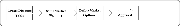

The following figure shows the Volume Offer process flow:
Create Volume Offer Process Flow
When you create a discount table you must define the following:
Define discount tables (one or many). A discount table can contain one or many tiers and the tiers use continuous breaks. This means that the "To" value of one tier will be the "From" value of the next tier. The following example contains 3 tiers:

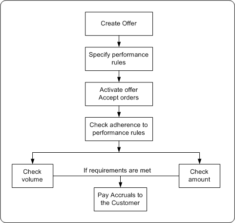

Performance rules are the conditions that a retailer or a customer must comply with to qualify for the discounts that are defined in an offer. Performance dates determine the time period within which retailers or customers must execute activities that are assigned to them to qualify for the discount. Performance dates are used to ensure that customers meet the performance criteria before a claim can be settled. Performance dates are not related to sales orders or product sales.
For performance requirements such as end-aisle display or poster display, you can attach digital photographs of the display to the offer. During claim settlement, the claims user can use this information as performance proof.
Note that while volume performance is validated automatically, any other types of performance requirements must be updated manually by the account representatives.

By specifying volume-based performance requirements, you can create incentives that have a quantifiable objective to increase the predictability of an offer. Volume-based performance requirements are applicable to Accrual, Lump sum, Trade Deal, and Volume offers.
The accrual engine tracks performance requirements against the orders placed. It checks for volume or value, based on the requirement type. After you specify performance requirements, the accrual engine calculates and stores the value and quantity of ordered products on an everyday basis. The payment will not be made until the accruals that are created between the start date and the end date for the product specified is greater or equal to the value or volume entered as a part of performance requirement specifications. If the volume requirement fails, then an alert is sent to the offer owner indicating that the volume check has failed. If the performance requirements are met, then the funds that are accrued over a period of time are paid to retailers or customers.
However, automatic checks do not work for certain trade promotion activities related to advertising and marketing where the retailers are required to perform actions such as poster display or product display, and so on. These performance activities can be defined for each item, item category, or for all items. In such cases you may attach the digital photographs of the store display to the offer as proof of performance. A performance verified check box is available in the claims page to imply that the customer has met the performance specified in the offer. The claims user makes use of this as performance proof while settling the claim. The claims user can access all the details of the performance requirements before associating an offer and settling the claim.
The following figure illustrates the process by which customers get paid based on the volume-based performance requirements.
The Volume-based Performance Requirements flow involves the following steps:
Create offer.
Specify performance rules.
Activate offer and accept orders.
Check adherence to performance rules.
Check volume and amount to verify requirements are met.
Pay accruals to the customer.
Volume-based Performance Requirements Flow
Before funds are paid to the retailer or customer, the system verifies whether the retailer or customer has adhered to performance rules specifications. If the retailer has not adhered to performance requirements, the system sends notifications to the offer owner. The offer owner can skip the performance rule and make payments only if a site level profile option has been implemented to override performance requirements. See the Oracle Channel Revenue Management Implementation Guide for more information on setting up this option.

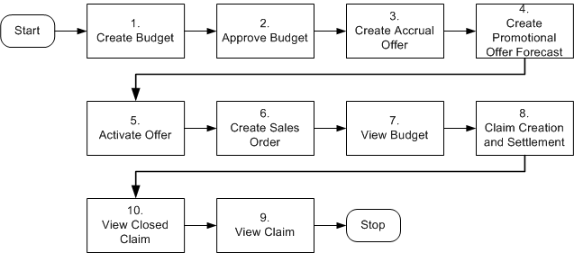

The following figure illustrates the Oracle Channel Revenue Management application process flow from forecasting product sales for an offer to a customer, to settling the claim.
Trade Promotion Forecasting to Execution
Follow the steps in this section to complete this flow.
Step 1: Create a Budget
A Budget is a pool of money, which you can use to fund trade promotion activities such as offers and campaigns. As the first step, you create a budget for $500,000 to be used for general sales and trade promotion purpose. You can use this budget to source an accrual offer to offer delayed discounts to your customers.
Step 2: Approve the Budget
The budget must go through the budget approval process to become active. You can source funds for sales and trade promotion activities from a budget only if it is active.
Step 3: Create an Accrual Offer
In this step, you will create an accrual offer to provide 10% discount on each unit of the product, which customers purchase. An accrual offer enables you to give delayed discounts on items that the customer or distributor purchases. The discounts get accrued over a period of time, and customers can later claim this amount. You can also enter the minimum quantity or amount that the customer must purchase to get the discount.
Step 4: Create Promotional Offer Forecast
You can create an offer forecast for the customer and product to find out how well the offer may perform. It enables you to determine whether the offer will provide the required promotional lift and yield the desired results. A forecast is created based on historical data. The offer must be in Draft status in order to create the forecast.
Note: The concurrent program Refresh Materialized Views for Order Sales must be run to update Base Sales and Actual Sales. This concurrent program can be automated by scheduling it to run regularly. It updates the forecasting information to show the historical purchase of the product for the customer from the previous year period. You will use this information to create a forecast for your offer.
Step 5: Activate Offer
You must activate an offer to make it available for customers. Discounts are applied to the offer when customers place orders against the offer.
Step 6: Create a Sales Order
After an offer is active, customers can start placing orders against the offer. Orders are created in Order Management by the Order Management clerk. Discounts are applied when orders are created. To create a sales order, log into Order Management as ebusiness/welcome. This user has the Order Management Super User responsibility.
Navigation: Orders, Returns > Sales Orders.
Notes:
Order Type: Enter Mixed.
Line Items: Enter details as appropriate.
Actions: Use this tab to create Promotion Pricing Attributes for Oracle Channel Revenue Management. Complete the following for a request only offer, for an automatic offer skip to view adjustments:
Select Promotion/Pricing Attributes and click OK.
Select Promotion Number and click Apply.
Click Actions to view adjustments:
Save your work and make a note of the order number.
Click Book Order.
The Pick Release Process concurrent program picks and packs the order. The Interface Trip Stop concurrent program ships the sales order to the customer location.
Step 7: View Budget Utilization
The Funds Accrual Engine updates the budget that is related to the offer and the order. The utilized and the earned columns in the budget get updated according to the discounts that are offered against the orders that the customers have placed. The budget shows the utilized amount based on the discount applied to the order. The earned column shows the amount utilized based on the orders that have been shipped. To view the budget utilization details, log into Oracle Channel Revenue Management as trademgr/welcome. This user has the Oracle Trade Management Super User responsibility.
Navigation: Budget > Budgets.
Notes:
Look for the New Product Promotion budget. Optionally, click the amount under the Utilized column to view the order number.
Step 8: Claim Creation and Settlement
The concurrent program Claims Autopay automatically creates a claim for the customer if Autopay is enabled in the customer's Trade Profile. To enable Autopay for the customer, navigate to Administration > Trade Management > Trade Profile, and select Autopay.
After the claim is automatically created, the following processes occur in the background:
The AutoInvoice concurrent program validates and imports records as completed transactions into Oracle Receivables. If there are any errors in the process, they are listed in the output report.
The Claims Settlement Fetcher concurrent program closes the claim that you have prepared to settle.
The workflow background process with the parameter Claim Settlement closes the claim.
Step 9: View Credit Memos
Review the credit memo that is created from Oracle Receivables. Log into Oracle Channel Revenue Management as trademgr/ welcome. This user has the Oracle Trade Management Super User responsibility.
Navigation: Claim > Claims.
Look for the credit memo in Receipts.
Step 10: View Closed Claim
Review that the claim has been closed. This concludes the claim settlement process. The claim will be closed when the Claims Settlement Fetcher concurrent program is complete.
Notes:
Look for the claim that you created and settled. Verify that the claim status has changed to Closed. The Claim Report shows the Receipt, Settlement, Vendor, Payment Detail, and other information.
