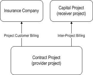

During an auto accident, a telephone pole owned by the local telephone company is knocked down. A contract project is set up to track the cost of the repair. These costs will be billed to an insurance company. While the repair is under way, the telephone company decides to replace the old transformer at the top of the downed pole. These costs will need to be capitalized and will be billed internally to a capital project. The contract project will bill the insurance company for repair work performed on the pole, and, using inter-project billing, will bill a receiver project for work performed on the transformer. The receiver project can exist at any organization level in the enterprise, regardless of operating unit or ledger.

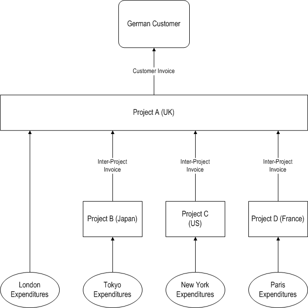

Company ABC is an advertising company with a multiple organization structure. The London operating unit, ABC's headquarters, received a contract from a German customer. The customer wants ABC to produce and air live shows in Paris, New York, and Tokyo to launch its new line of high-end women's apparel. ABC will plan and design the show using resources from the London operating unit. The Paris, New York, and Tokyo operating units are each responsible for the successful execution of these live shows with their local resources.
Using the structure shown above, the customer project is divided into several related contract projects. The London operating unit owns the primary customer project, or receiver project, and bills the external customer. The related projects, or provider projects, are subcontracted to their respective internal organizations and internally bill the London organization to recover their project costs.

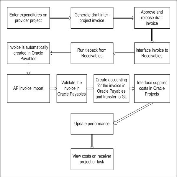

The processing flow for inter-project billing as detailed in the following diagram is the same as for any contract project, with the following exception: After you interface draft inter-project billing invoices to Oracle Receivables, the tieback process copies them into the Payables system of the receiver operating unit.
Processing Flow
The inter-project billing processing flow consists of the following steps:
Enter transactions and distribute costs on your provider project.
Generate a draft inter-project invoice by running the Generate Draft Invoice process. See: Generate Draft Invoices, Oracle Projects Fundamentals.
Approve and release the draft inter-project invoice.
Review, approve, and release the draft inter-project invoice using the standard functionality of Oracle Project Billing.
Interface the draft inter-project invoice to Oracle Receivables.
Interface the draft inter-project invoice to Oracle Payables.
Interface the draft inter-project invoice to Oracle Projects.
To record work performed by a provider resource, expenditures are entered in the provider project. The expenditures are charged to the receiver project and tasks. The expenditure organization is the resource owning organization. The expenditure type can be any type that is defined in the provider project. When the expenditure is interfaced to the receiver project via a Payables invoice, the expenditure type and expenditure organization are overridden by the Provider Controls defined in the receiver's operating unit.
You submit a streamline process (choose the XI: Interface Draft Invoice to AR parameter) to execute the processes Interface Invoices to Receivables, AutoInvoice, and Tieback Invoices from Receivables.
Inter-project invoices are interfaced to Oracle Receivables with the invoice batch source "PA Internal Invoices." Inter-project invoices and intercompany invoices share this batch source. (See: Interface Intercompany Invoices to Receivables, Oracle Projects Fundamentals) The streamline process executes AutoInvoice twice, once for inter-project invoices and once for customer invoices. The tieback process automatically interfaces the inter-project invoices to the receiver operating unit's payables.
You can also execute each of these processes separately. To generate invoices in Oracle Receivables for both inter-project invoices and customer invoices, you must run AutoInvoice twice, identifying the appropriate batch source each time.
When the provider operating unit runs the Tieback Invoices from Receivables process, the successfully interfaced inter-project invoices are automatically interfaced to the interface table of the receiver operating unit's Oracle Payables. Inter-project invoices interfaced to Oracle Payables have the following attributes:
