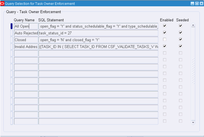

Use this procedure to execute the Auto Commit Tasks concurrent program.
Navigate to Auto Commit Schedule window. The Parameters window appears.
Select a Task Source value of Task List Query or Territories. Enter the values in the Parameters window.
Click OK. The Auto Commit Schedule window appears.
The Parameters field contains the entered task list query.
Click Schedule. The Schedule window appears.
Define how often you want to commit the schedules for the time frame defined previously.
Click Apply a Saved Schedule to use the settings of a previous saved schedule.
Choose one of the options at Run the Job.
Click OK when finished.
Click Submit.

Dispatchers sometimes oversee tasks owned by other dispatchers (schedule technicians, manage exceptions, and so on) to assume the responsibilities of dispatchers who are on leave. The Dispatch Center window enables dispatchers to select the task owners dynamically, and then view and manage tasks owned by other dispatchers. Dispatchers can interactively select multiple task owners.
Navigate to the Query Selection for Task Owner Enforcement window.
Task List Queries can be flagged to enable, or activate, the enforcement of task owner selections. Task Queries set up with the 'Enabled' check box selected are candidates for enforcing the task owner selection. All Queries, both seeded and custom queries, are available for task owner selection enforcement, except the 'My Inbox' query. The seeded 'My Inbox' query already enforces and implies the task owner as the current Dispatcher logged-in and hence, is not available for selection in the user interface.
Select Navigate from the Dispatch Center window menu bar, and then choose Select Territories and Task Owners from the Navigate menu.
The Task Owner region has several check boxes for selecting the 'Candidate Owner':
My Self: The Dispatcher currently logged in.
My Groups: All the Resource Groups the dispatcher is a member of.
My Group Members: All members in the Resource Groups that the dispatcher is a member of.
All Groups: Displays all resource groups set up, no restrictions applied.
You can select or unselect Task Owners by using the shuttle buttons provided between the 'Unselected' and 'Selected' regions.
Click OK to save your work.
