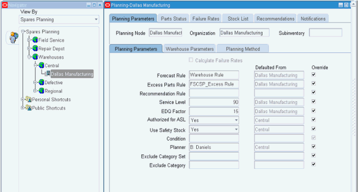

To select a Forecast Rule:
Steps
Navigate to the Planner's Desktop.
The Planner's Desktop appears displaying the Planning Parameters tab, and Planning Parameters sub tab.
From the Tree in the Planner's Desktop, select a warehouse, technician, or node.
Note: The warehouse can either be the warehouse being planned or the defective warehouse.
Note: If you select a node other than an organization (warehouse) or sub inventory (technician), then the Forecast Rule (or other parameters) default to lower level nodes underneath the node where the Forecast Rule was selected.
In the Forecast Rule field of the Planning Parameters sub tab, select a Forecast Rule from the list of values.
Save your work.

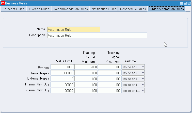

Warehouse notifications are used for warehouse replenishment. The functionality which includes visibility to excess inventories and defectives for repair is found in the Notifications tab of the Planner's Desktop.
Automating warehouse notifications is beneficial when planners have a large number of warehouse notifications to execute and when the cycles need to be processed frequently to insure timely replenishment. These rules are set up to automate notifications that have a low notification value combined with a good forecast reliability. You can create automation rules for these new-buy notification types:
Internal Order: This represents transfer orders between warehouses.
WIP Order: This is used when manufacturing is required.
Requisition: This is used when purchasing is required.
In each of the above cases, you can enter Excess Value, Repair Value, Notification Value, and Min-Max Values for Tracking Signals.
Excess value: This is the value of excess inventory that can be used to satisfy the notification.
Note: This should be set low so that automation would not occur when a significant amount of excess is available to utilize.

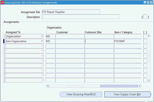

Define Repair Suppliers and Assign to the warehouse. See Defining and Assigning Internal Repair Suppliers.

(Optional) Define Order Automation rules and assign them to a warehouse. See Defining and Assigning Planned Order Release Automation Business Rules.
Set up Other Warehouse Planning Parameters for the warehouse. See Setting Up Other Warehouse Planning Parameters.

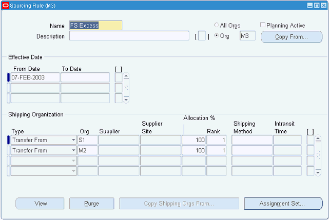

This section covers creating the Sourcing Rule and Assignment Set and linking the Assignment Set to the warehouse that is being planned in WRP.
Use this procedure to set up excess warehouses for usable excess parts:
Prerequisites

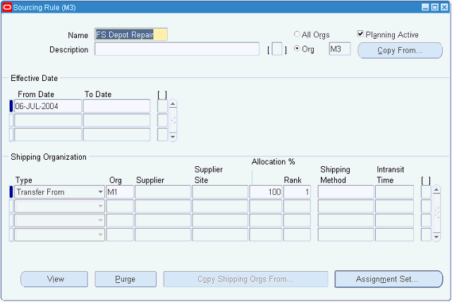

To Create A Sourcing Rule
Navigate to the Sourcing Rule window.
The Sourcing Rule window appears.
Note: You would create the Sourcing Rule for the organization representing the warehouse that is being planned.
Enter a Sourcing Rule name.
(Optional) Enter a Description.
In the Shipping Organization region enter Transfer From as the Type. Enter the organization representing the excess warehouse where excess inventory will be utilized in the Org field.
See Defining Sourcing Rules, in the Oracle Purchasing User's Guide
Save your work.
In this example organizations S1 and M2 have been defined in the Sourcing Rule as excess warehouses that will be used in the replenishment planning for another warehouse.

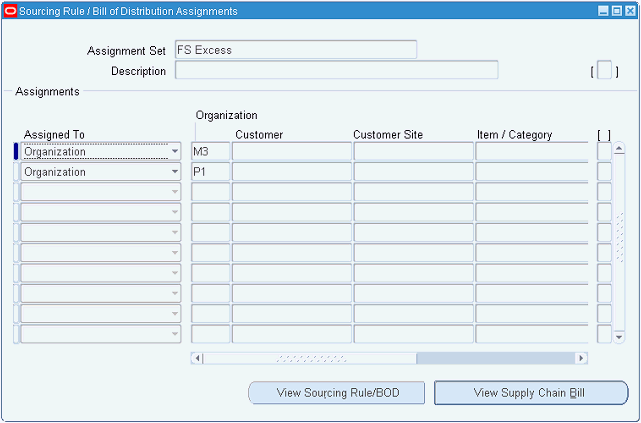

To Create an Assignment Set and Assign the Sourcing Rule to the Primary Warehouse Being Planned
Navigate to the Sourcing Rule / Bill of Distribution Assignments window.
The Sourcing Rule / Bill of Distribution Assignments window appears.
The Assignment Set is the link between the Sourcing Rule that defines the excess warehouses and the warehouse being planned.
Enter the Assignment Set name and Description.
Enter Organization in the Assigned To field from the list of values.
Enter the organization (warehouse being planned) in the Organization field.
Enter Sourcing Rule in the Type field and the name of the Sourcing Rule in the Sourcing Rule/BOD field.
See Assigning Sourcing Rules and Bills of Distribution, Oracle Purchasing User's Guide.

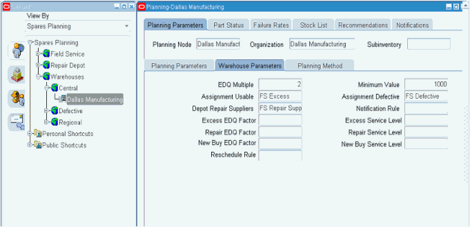

The Planner's Desktop window appears displaying the Planning Parameters tab, and Planning Parameters sub tab.
In the Spares Planning tree of the Planner's Desktop select the warehouse being planned.

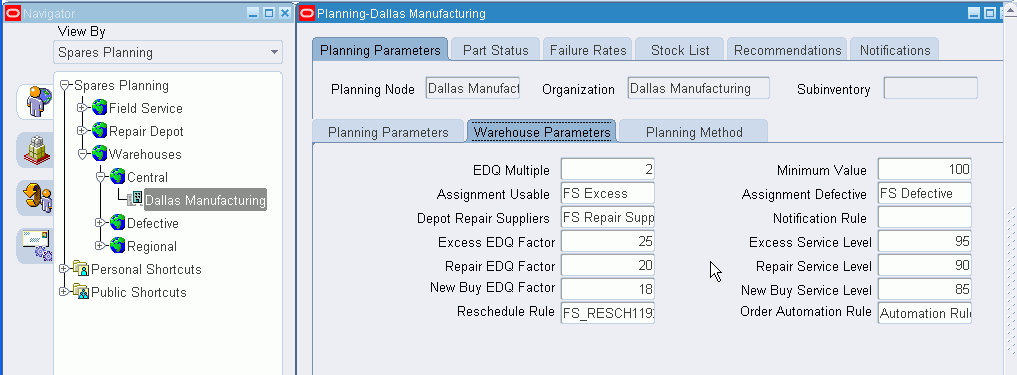

Select the Warehouse Parameters sub tab within the Planning Parameters tab of the Planning window.
The Warehouse Parameters sub tab appears.
Enter the Assignment Set for the excess warehouses in the Assignment Usable field of the Warehouse Parameters tab.
Save your work.
In this example through the use of Sourcing Rules and Assignment Sets two organizations, S1 and M2, have been designated as warehouses where excess will be utilized in the planning and replenishment of organization Dallas Manufacturing.
In WRP this enables the excess warehouses defined in the Sourcing Rule to be incorporated into the warehouse planning.
In the Notifications tab of the Planner's Desktop this also enables excess inventories from the excess warehouses defined in the Sourcing Rule to be visible in the warehouse replenishment notification.
In the Spares Planning tree of the Planner's Desktop, select the warehouse being planned.
Enter the Assignment Set for the defective warehouses in the Assignment Defective field of the Warehouse Parameters tab.
Save your work.
In this example through the use of Sourcing Rules and Assignment Sets two organizations, DWH and M6, have been designated as warehouses where defective parts will be utilized in the planning and replenishment of organization M3.
In WRP this enables the defective warehouses defined in the Sourcing Rule to be incorporated into the warehouse planning.
In the Notifications tab of the Planner's Desktop this also enables excess inventories from the defective warehouses defined in the Sourcing Rule to be visible in the warehouse replenishment notification.

Use this procedure to set up internal depot repair suppliers:
Prerequisites
To Create a Sourcing Rule
Note: You would create the Sourcing Rule for the organization representing the warehouse being planned.
Enter a Sourcing Rule Name.
In the Shipping Organization region enter Transfer From as the Type. Enter the organization representing the internal repair depot where defective inventory will be repaired and used as replenishment in the Org field.
In this example organization M1 has been defined in the Sourcing Rule as an internal repair supplier that will be used in the replenishment planning for the warehouse M3.
The Assignment Set is the link between the Sourcing Rule that defines the internal repair suppliers and the warehouse being planned.
Note: You can use the same Assignment Set for other Sourcing rules that define sourcing for external repair. For information on external repair, see Setting Up External Repair Execution.
In this example the Sourcing Rule has been assigned to the organization M3 and also specifically to the item FS18947 at M3.
In the Planner's Desktop, select the warehouse being planned in the Planning Tree.
Click the Warehouse Parameters sub tab within the Planning Parameters tab of the Planning window.
Enter the Assignment Set for the repair sourcing in the Depot Repair Suppliers field of the Warehouse Parameters tab.
Save your work.
In this example organization M1 has been defined in the Sourcing Rule as an internal repair supplier that will be used to repair defective parts in the replenishment planning for the warehouse M3.
In WRP this enables the Repair Suppliers defined in the Sourcing Rule to be incorporated into the warehouse planning.
In the Notifications tab of the Planner's Desktop this also enables execution automation for internal repair suppliers.

Navigate to the Order Automation Rules window.
The Business Rules window appears displaying the Forecast Rules tab.
Select the Order Automation Rules tab.
The Business Rules window appears displaying the Order Automation Rules tab.
Enter a rule name in the Name field.
(Optional) Enter a description in the Description field.
(Optional) Enter the Internal and External Value Limit for the Repair and New-Buy supply types, and the Value Limit for the Excess supply type.
Excess External Value Limit is not applicable.
The Value Limit must be a whole positive number and can be up to 12 characters long.
(Optional) Enter the Minimum and Maximum Tracking Signal values for the Excess, Repair, and New-Buy supply types.
The Minimum Tracking Signal value must be a negative number and can be up to 8 characters long.
The Maximum Tracking Signal value must be a positive number and can be up to 8 characters long.
(Optional) Select the lead time parameter for the Excess, Repair, and New-Buy supply types. Values are Inside, Outside, or Inside and Outside.
Save your work.

Use this procedure to set up other warehouse planning parameters:
Steps
The Planner's Desktop window appears.
From the Spares Planning Tree, select the warehouse organization.
The adjacent Planning Parameters and Warehouse Parameters windows provide details of the planning tree node (warehouse) that you selected.
Select the Warehouse Parameters sub tab.
The Warehouse Parameters tab displays fields for the EDQ Multiple and Minimum Value for excess on order. Also included are Service Level, and EDQ Factor by Supply Type.
EDQ Multiple: This value is used to define the Excess Limit in the excess on-order recommendation in WRP and the Notifications Tab in the Planner's Desktop. The Excess On-Order Limit is equal to the Reorder Point (ROP) plus the EDQ Multiple times the EDQ.
Minimum Value: Excess on-order recommendations are created when on-hand plus on-order quantities exceed the excess on-order limit, and the value of the excess on-order is in excess of the Minimum Value which is expressed in the currency value.
The Minimum Value is used in WRP and the Notifications tab of the Planner's Desktop.
Service Level by Supply Type: Expressed as a percentage, the service level is used along with the EDQ to calculate the safety stock quantity. The service level defines on a planned basis the desired percent of demand filled when needed.
Service Level by supply type is only used in WRP.
EDQ Factor by Supply Type: This factor is used in calculating the EDQ. The EDQ Factor combines both ordering costs and carrying costs in the EDQ calculation to determine the delivery quantity.
EDQ Factor by supply type is only used in WRP.
EDQ varies directly with the EDQ Factor. Increasing the EDQ Factor produces a larger calculated EDQ and vice versa.
To change any of these values, enter a different number in the appropriate field for the supply type.
Save your work.

Select the Planning Parameters sub tab and enter Forecast Rule, Recommendation Rule, Service Level, and EDQ Factor.
See Setting Up Other Warehouse Planning Parameters for an understanding of Service Level and EDQ.
See Defining Forecast Rules for a better understanding of forecasting.

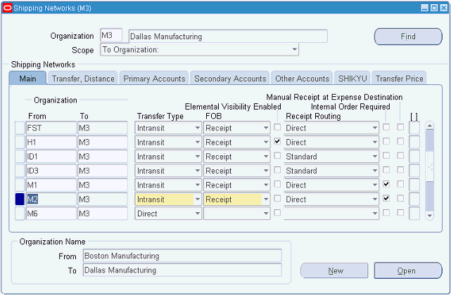

Lead Time is the period of time between recognizing that an order needs to be created and receiving the order at the warehouse being replenished. Warehouse Replenishment Planning (WRP) uses different lead times to plan each of the three supply types: Excess, Repair, and New-Buy.
You define lead times for the Excess supply type using the Intransit Time column for the Shipment Methods listed in the Inter-Org Shipping Network window.
Navigate to the Shipping Networks window.
The Shipping Network is defined by the organization representing the Excess Warehouse as the Ship From and the organization representing the warehouse being planned as the Ship To.
Select a row for an Organization from-to combination.
Navigate to the Inter-Org Shipping Networks window.
The Inter-Org Shipping Networks window appears.
Enter the Intransit Time (lead time) expressed in days for the Shipping Method.
Note: Make sure one of the Shipping Methods is designated as the default. WRP uses the lead time from the default Shipping Method to define the lead time for Excess planning.
In this example the lead time from the excess warehouse or M2 to the warehouse being replenished or M3 is 14 days.

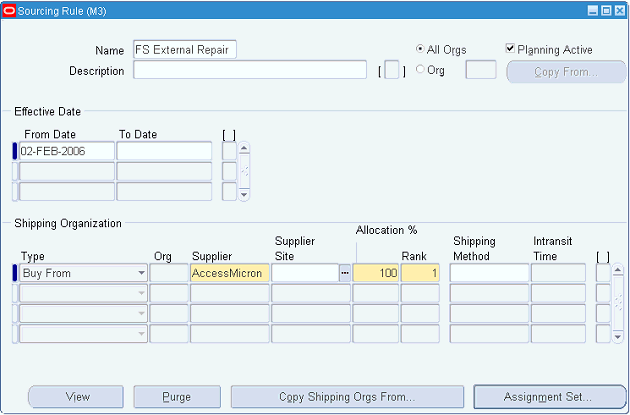

Repair suppliers in the field service supply chain can be both internal and external. External Repair Execution (ERE) is integrated into Warehouse Replenishment Planning (WRP) and provides automated functionality to execute repair at an external repair supplier and replenish the field service warehouse with repaired parts based on need.
You define the specific external repair suppliers using Sourcing Rules and then link them to the warehouse being planned in WRP in Assignment Sets.
This section covers creating the Sourcing Rule and Assignment Set and linking the Assignment Set to the warehouse being planned in WRP.
In External Repair Execution each repair supplier needs to be modeled as an inventory organization in Inventory and a Supplier in Purchasing. The supplier is assigned to the organization in Oracle Inventory.
To set up inventory organizations and assign the supplier to the organization, see the Inventory Structure chapter in the Oracle Inventory User's Guide.
To set up suppliers in purchasing, see the Supply Base Management chapter in the Oracle Purchasing User's Guide.
Create a Sourcing Rule for organizations where external repair suppliers will be used for the replenishment of the warehouse being planned.
Navigate to the Sourcing Rule window for the organization used for the warehouse being planned by WRP.
See Defining Sourcing Rules, Oracle Purchasing User's Guide.
Note: Use the same Assignment Set used for Sourcing Rules that define sourcing for internal repair.

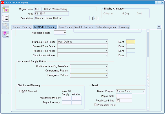

Repair parameters for a particular item appear on the MPS/MRP Planning tab of the Inventory Organization Item window. The parameters define the repair program name, the repair yield percentage, the repair lead time in days, and indicate whether an inventory of defective parts is pre-positioned at the repair supplier to reduce in-transit time.
See Setting Up Repair Parameters.
The values set in the CSP: Repair Supplier Organization's Defective Subinventory profile option and the CSP: Repair Supplier Organization's Usable Subinventory profile option define the names used for those subinventories.
See Setting Profile Options for External Repair Execution.
See also the Profile Options Appendix in the Oracle Field Service Implementation Guide.
Use this procedure to set up repair parameters for the inventory item:
Prerequisites
Steps
Navigate to the Organization Item window.
The Organizations window appears.
In the Organizations window, select the repair supplier organization. Click OK.
The Find Organization Items <Org> window appears.
Select the item in the Find Organization Items window.
The Organization Item <Org> window appears.
Select the MPS/MRP Planning tab.
The MPS/MRP Planning tab appears. Scroll down to the Repair region.
In the Repair region:
Select the Repair Program from the list of values.
The repair program will appear on the repair purchase requisition. The repair program will determine the process used to execute the repair activity at the repair supplier.
For example: Repair and Return, Exchange, or Advance Exchange.
Enter the Repair Yield. This is the average percentage of defectives sent to the repair supplier that can actually be repaired.
Specify the Repair Lead Time, in days.
This lead time represents the internal processing time at the repair supplier. This lead time, along with the in-transit time to the repair supplier and the in-transit time from the repair supplier determines the total repair lead time for planning purposes. Repair lead time is used to determine the release date for the planned repair order.
For information on setting up repair lead times, see Setting Up Lead Times for Warehouse Replenishment Planning.
Optionally, select the Preposition Point check box to indicate whether the defective parts will be pre-positioned in inventory at the repair supplier.
Save your work.
