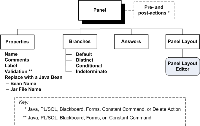

Panels, groups, and blocks are processing units that tell the script what to do. These objects must be connected with branches to direct the flow of the script at runtime.
A graphical script can consist of one or more graphs. Each Script Author graph must have one start node, with a default branch leading to the first script object, and at least one termination node.
Panels display information (such as text, an image, a hyperlink, a variable, or question UI controls) to the script user at runtime, and provide a method to accept information (answers) from the script end user.

The panel is the only Script Author object that is visible at runtime. The composition of each panel is determined by script developers and script requirements. Panels may contain panel text, images, embedded values, hypertext links, customized HTML tables, and any number of questions and their associated question user interface controls.
Panels may include any number of questions (there are no limits other than practicality).
This section consists of the following topics:
A panel contains the information that is displayed in the script at runtime. Answer controls defined in the panel (using the Script Author) are used to accept information from the user at runtime and advance the flow of the script.
The main components of a panel that you define in the Script Author are shown in the following diagram. The attributes and elements in the diagram are the panel properties that you can view and edit.
These panel properties and attributes are accessible in the Script Author by right-clicking a canvas panel and selecting File > Edit Blob Properties, or if you have enabled automatic properties popup when creating a new panel, group, or block.
For more information about actions and branches, see:
For information about properties of questions and answers, see:
For information about the panel contents - the text and answer controls that define what appears in the panel at runtime - see Working with the Panel Layout Editor.
Identifies the panel in the Script Author and the database. Also used to track a panel for footprinting purposes.

Validation
You add a command here to validate the contents of a panel. The validation occurs as you exit the panel.
Replace with a Java Bean
For details, see Substituting a Java Bean for a Panel.
You can view and edit answer properties when you add or edit an answer in the Panel Properties window of a panel.
The main properties of each answer appear in different windows, as follows:
The following diagram shows the answer properties that appear in the Answer Entry Dialog window:
From the Answer Entry Dialog window, more answer properties are available when you click the Edit Data Dictionary button; they appear in the Edit Data Dictionary Window.
The following table lists the answer properties in the Answer Entry Dialog window.

Within each object, the main properties of branches that you can define appear in the diagram following:
For details of the actions, see Defining Actions.
