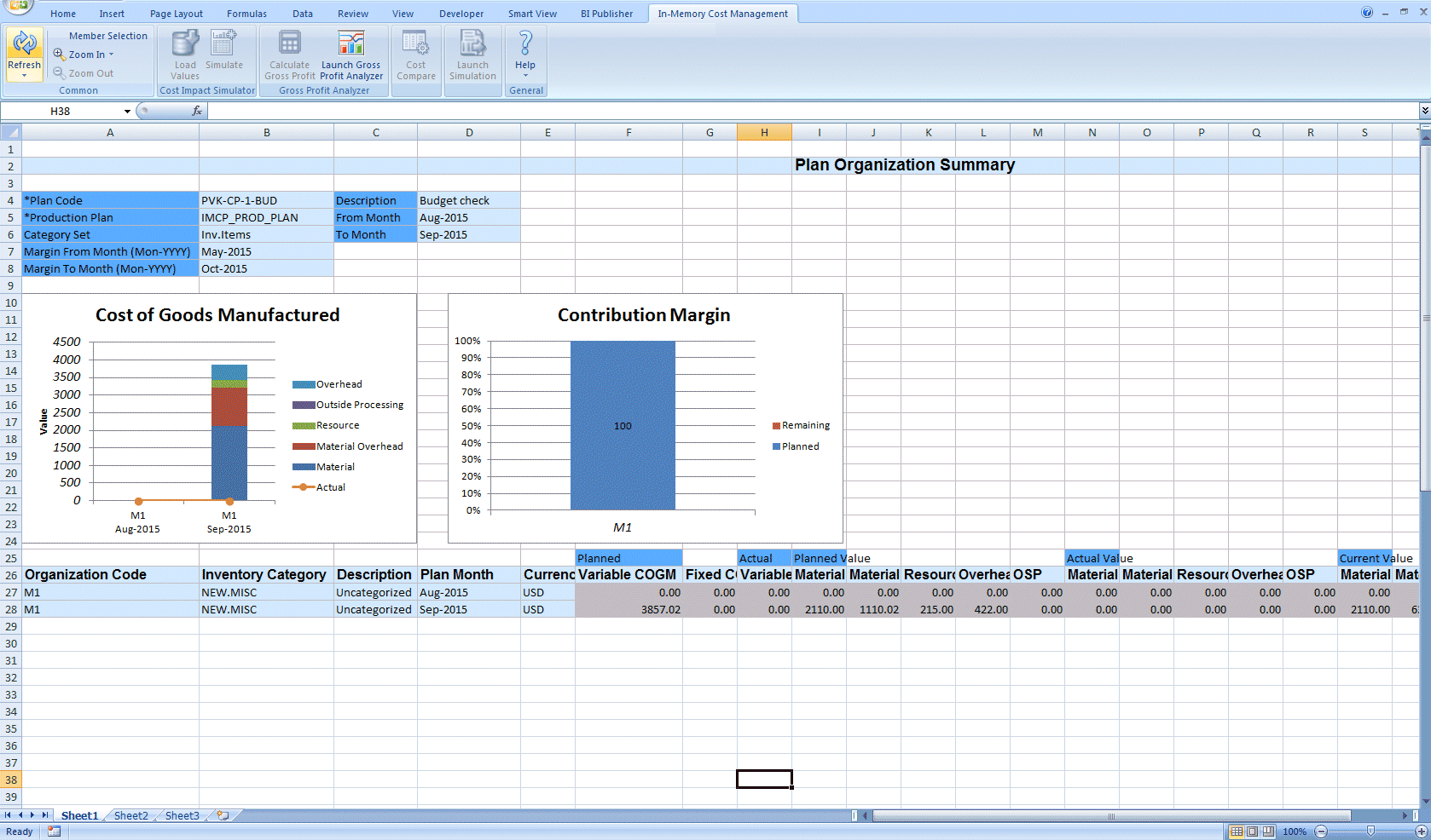

The Plan Organization Summary worksheet enables you to analyze the Cost of Goods Manufactured (COGM) and the contribution margin for all organizations, providing a view of cost saving areas when compared across the organization.
To view plan organization summary information
Navigate to the Plan Organization Summary worksheet for a specific Plan Code and Production Plan.
The following values appear for the Plan Code and Production Plan combination:
Description
From and To Month
Category Set
Margin From and To Month
The graphs display the following data:
The Cost of Goods Manufactured shows the costs per month for the organization.
The Contribution Margin shows the percentage of cost contribution per unit, representing the portion of sales revenue that contributes to the coverage of fixed costs.
In the section following the graphs, details for each organization and for the plan month display planned and actual costs in the following rows:
Organization Code
Inventory Category
Description
Plan Month
Currency
Planned Variable COGM: Cost plan total cost multiplied by planned production volume.
Planned Fixed COGM: Cost plan total fixed cost.
Actual Variable COGM: Actual costs incurred to produce the item.
Planned Value–For Material, Material Overhead, Resource, Overhead, Outside Processing:
Planned cost multiplied by planned production.
Actual Value–For Material, Material Overhead, Resource, Overhead, Outside Processing:
Actual cost incurred in production.
Current Value–For Material, Material Overhead, Resource, Overhead, Outside Processing:
Current cost multiplied by planned production.
Select an organization and double-click to navigate to the Item Summary worksheet. See: Viewing Plan Item Summaries and Details
Select Launch Gross Profit Analyzer to display the dashboard. See: Overview of the Gross Profit Analyzer
You can navigate to the Organization Summary worksheet and Zoom In to a single item's cost summary. This enables you to review details for each item in a plan month for planned, actual and current costs. The Cost of Manufactured Goods chart shows the value for planned and actual costs.

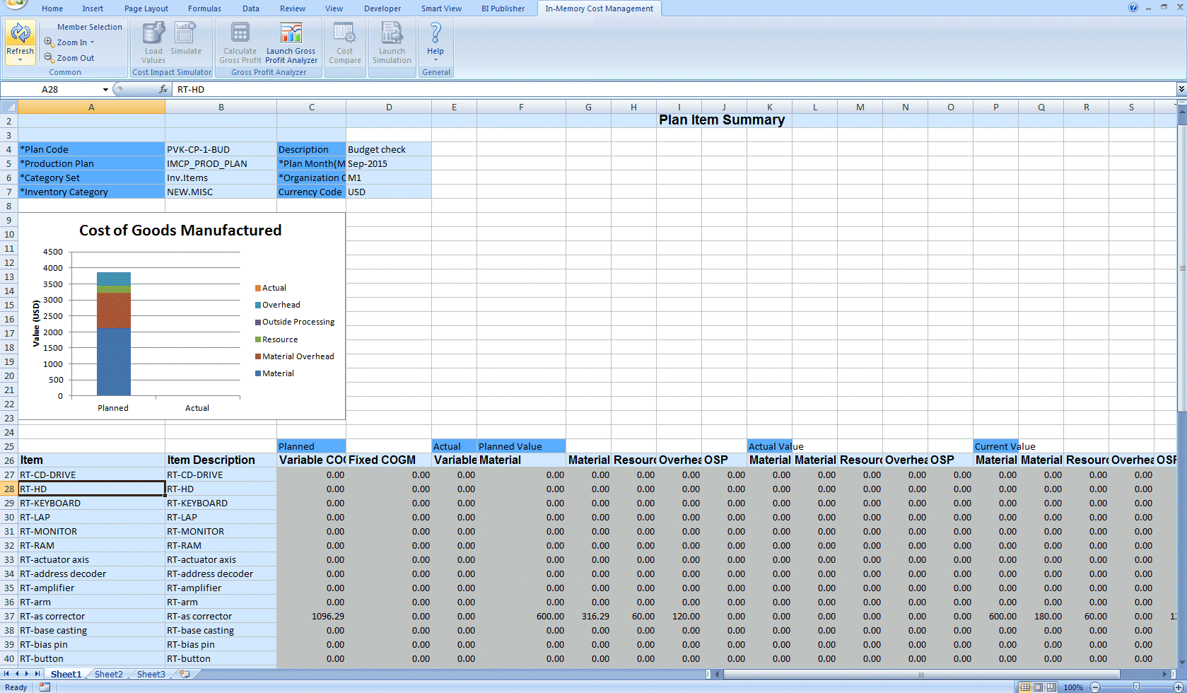

To view plan item summary information
Navigate to the Plan Item Summary worksheet for a particular item.
The header displays the following information:
Plan Code
Description
Production Plan
Plan Month
Category Set
Organization
Inventory Category
Currency Code
In the Item listing, you can review the following information for each Item record:
Planned Variable COGM: total cost multiplied by planned production volume.
Planned Fixed COGM: total fixed cost.
Actual Variable COGM: cost incurred to produce the item in production.
The calculation comes from work orders, material, and resources charged for the time period.
Planned Value–For Material, Material Overhead, Resource, Overhead, Outside Processing: planned cost multiplied by planned production.
Actual Value–For Material, Material Overhead, Resource, Overhead, Outside Processing: actual cost incurred in production.
Current Value–For Material, Material Overhead, Resource, Overhead, Outside Processing: current cost multiplied by planned production.
Select an item and Zoom In to the Plan Item Cost Details worksheet.

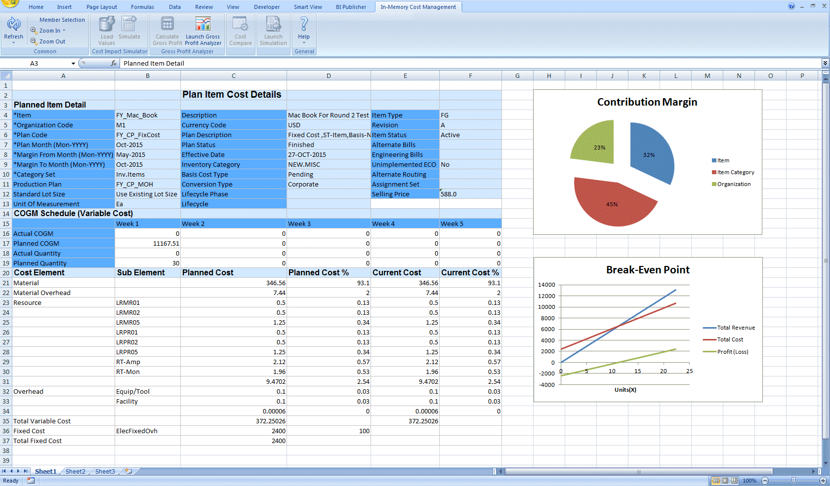

To view plan item cost details information
Navigate to the Plan Item Cost Detail worksheet:
This worksheet is divided into three regions for a specific item:
Planned Item Detail
Provides the details of the cost plan in the following fields: Item, Description, Item Type, Organization Code, Currency Code, Revision, Plan Code, Plan Description, Item Status, Plan Month, Plan Status, Alternate Bills, Margin From and To Months, Effective Date, Engineering Bills, Inventory Category, Unimplemented ECO, Category Set, Basis Cost Type, Alternate Routing, Production Plan, Conversion Type, Assignment Set, Standard Lot Size, Lifecycle Phase, Selling Price, Unit of Measure, and Lifecycle.
COGM Schedule
Shows the weekly Actual and Planned Cost of Goods Manufactured and quantities.
Cost Element
Provides a view of the detailed cost structure of the product for both planned and current costs. The columns in this region are: Cost Element, Sub Element, Planned Cost, Planned Cost Percentage, Current Cost, and Current Cost Percentage.
The Contribution Margin graph shows the fixed COGM allocated to the product which is used for analyzing this product in relationship to the organization and category of items.
The Break-Even Point graph is used to analyze the production point of balance between making either a profit or a loss. The break-even point is achieved when the generated profits match the total costs accumulated.
Select the item and use the Zoom In tool (or double-click left mouse button) to access the Plan Cost Structure Details worksheet. See: Viewing Plan Cost Structure Details
Select Launch Gross Profit Analyzer to display the dashboard. See: Viewing an Overview of Gross Profits

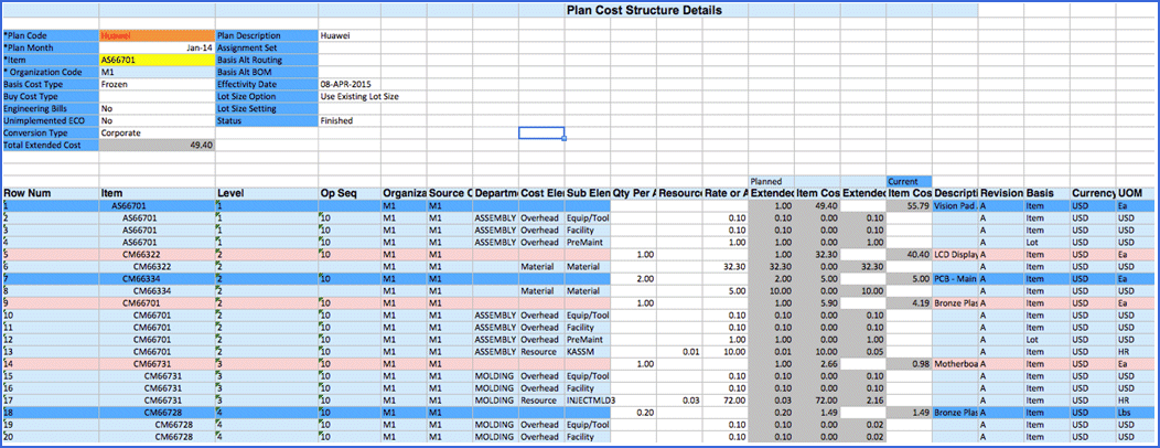

You can query a cost plan and review the cost element details of the plan, including the entire bill of materials and routing.
To view plan cost structure details
Navigate to the Plan Cost Structure Details worksheet.
The header section of the worksheet displays the manufacturing details of the cost plan in the following fields: Plan Code, Plan Description, Plan Month, Assignment Set, Item, Basis, Alternate Routing, Organization Code, Basis Alternate Bill of Material, Basis Cost Type, Effectivity Date, Buy Cost Type, Lot Size Option, Engineering Bills, Lot Size Setting, Unimplemented ECO, Status, and Conversion Type.
The Total Extended Cost for the assembly in the cost structure details appears for these manufacturing options.
You can review the entire bill of material and routing of this product, including all details of the costs. This data shows in the following fields: Item, Level, Operation Sequence, Organization, Source, Department, Cost Element, Cost Sub Element, Quantity Per, Resource, Rate, Planned Extended item cost, Current Extended Item Cost, Description, Revision, Basis, Currency, Unit of Measure.
Select Create Simulation to navigate to the Create Simulation worksheet. See: Creating Cost Simulations

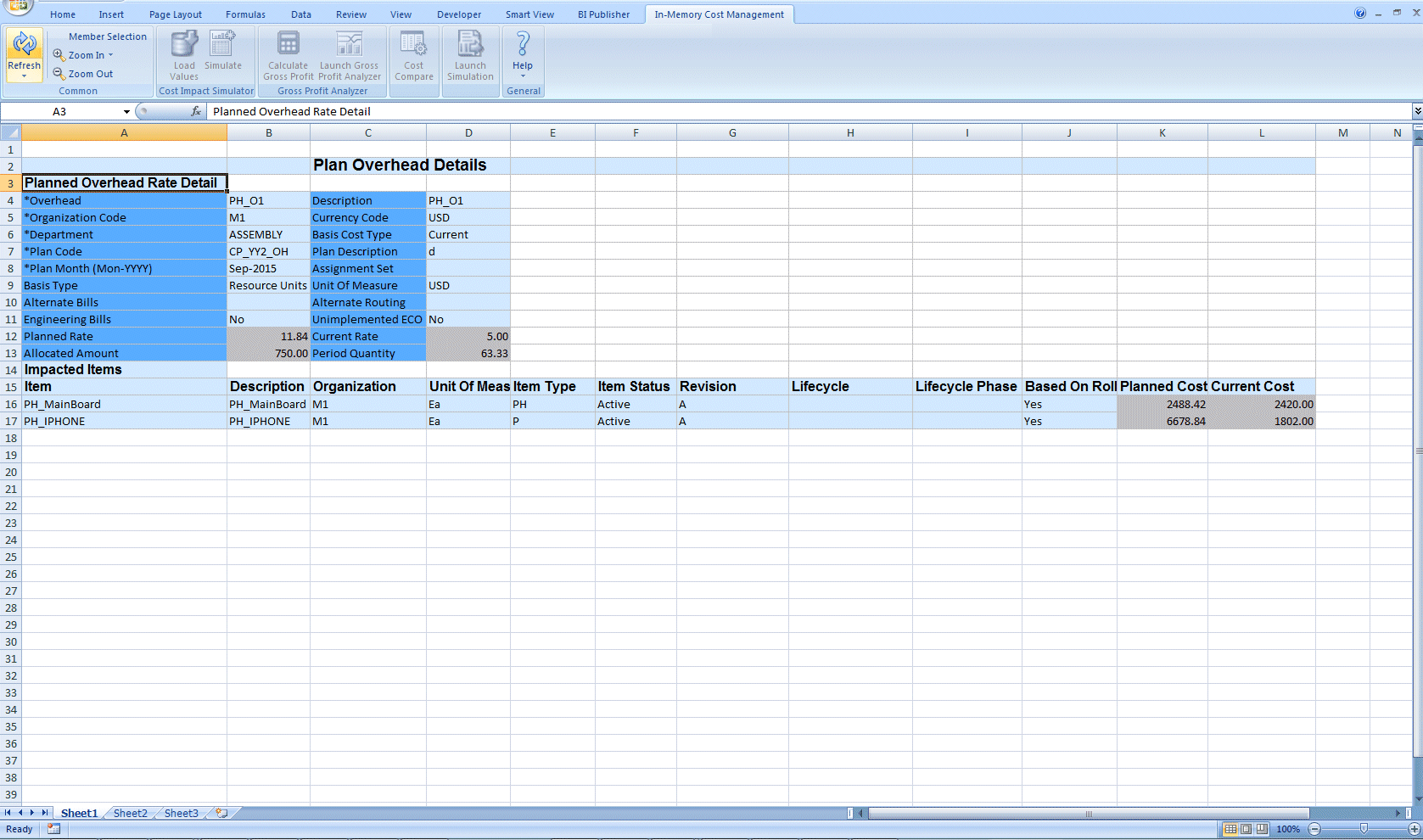

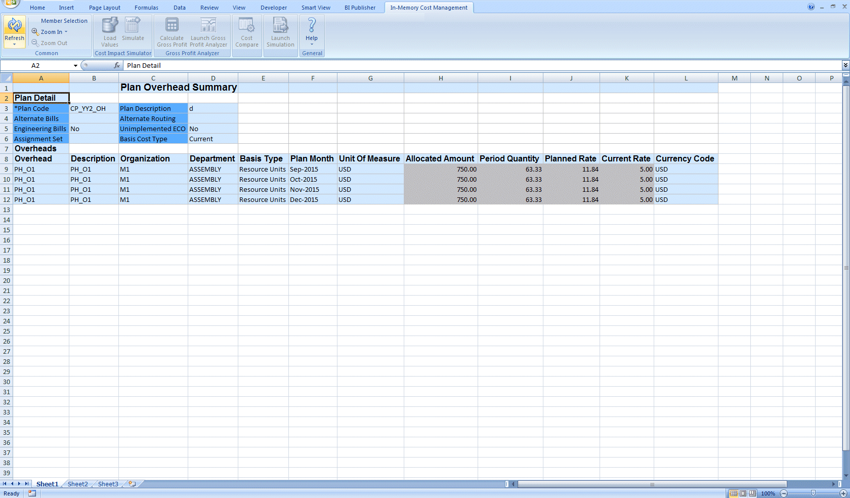

You can model overheads and review granular views on the costs, and see what portion of the overheads are attributed to a particular cost center. The overheads are captured and maintained as part of various expense management and budgetary control systems–and recorded as a General Ledger expense. Overheads are incurred at various levels of organization (corporate, facility, batch, item). ou can identify overheads based on Organization, Cost Type, Overhead, WIP Accounting Class, and Department.
General overhead costs (manufacturing facility rent, energy, and salaries) are usually estimated based on an analysis of prior period expenses.
The projected fiscal period cost of each overhead is allocated to individual products by calculating an overhead burden rate for each product, adding this rate to the product's standard cost structure.
To view overhead summaries
Navigate to the Plan Overhead Summary worksheet.
Summary information on the overhead costs displays in the Plan Detail section in the following fields: Plan Code, Plan Description, Alternate Bills, Alternate Routing, Engineering Bills, Unimplemented ECO, Assignment Set, and Basis Cost Type.
In the Overheads region of the worksheet, the summary information on individual overheads display in the following fields: Overhead, Description, Organization, Department, Basis Type, Plan Month, Unit of Measure, Allocated Amount, Period Quantity, Planned Rate, Current Rate, Currency Code.
Select an overhead record and Zoom In to navigate to the Plan Overhead Details worksheet.
This worksheet is divided into two sections:
Planned Overhead Rate Detail section contains information in the following fields:
Overhead, Description, Organization Code, Currency Code, Department, Basis Cost Type, Plan Code, Plan Description, Plan Month, Assignment Set, Basis Type, Unit of Measure, Alternate Bills, Alternate Routing, Engineering Bills, Unimplemented ECO, Planned Rate, Current Rate Allocated Amount, and Period Quantity.
Impacted Items section shows the items impacted by the overhead in the following fields: Item, Description, Organization, Item Type, Item Status, Revision, Lifecycle, Lifecycle Phase, and Based on Rollup.
The extended Planned Cost and Current Cost appear for each item on the worksheet.

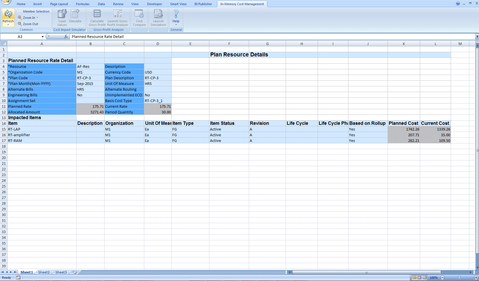

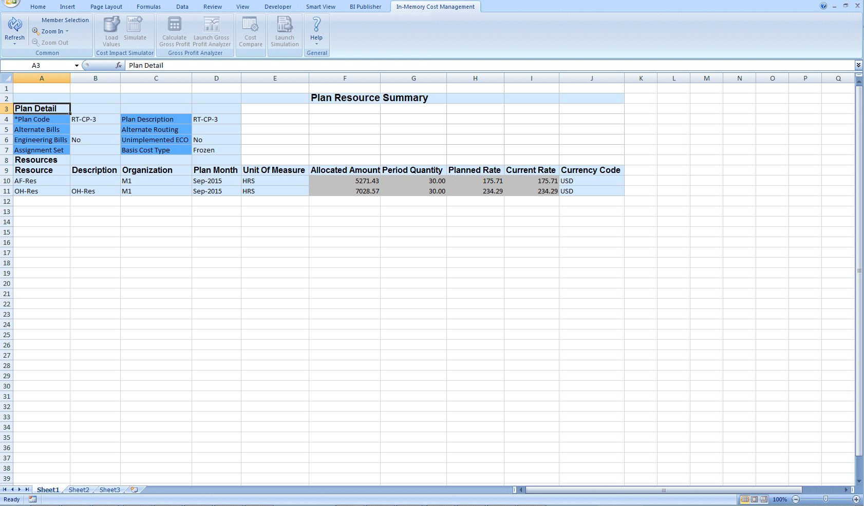

In-Memory Cost Planning provides features to consolidate all the related resource rates. You can model resources and review granular views on the costs, and see what portion of the resources are attributed to a particular cost center. Resources are incurred at various levels based on Organization, Cost Type, Overhead, WIP Accounting Class, and Department.
To view plan resource summary information
Navigate to the Plan Resource Summary worksheet.
The worksheet is divided into two sections:
Plan Detail section contains information in the following fields: Plan Code, Plan Description, Alternate Bills, Alternate Routing, Engineering Bills, Unimplemented ECO, Assignment Set, and Basis Cost Type.
Resources section is a listing of the resources for this plan code and shows information in the following fields: Resource, Description, Organization, Plan Month, Unit of Measure, Allocated Amount, Period Quantity, Planned Rate, Current Rate, and Currency Code.
Select a resource record and Zoom In to navigate to the Plan Resource Details worksheet.
Planned Resource Rate Detail section contains information in the following fields: Resource, Description, Organization Code, Currency Code, Plan Code, Plan Description, Plan Month, Unit of Measure, Alternate Bills, Alternate Routing, Engineering Bills, Unimplemented ECO, Assignment Set, Basis Cost Type, Planned Rate, Current Rate Allocated Amount, and Period Quantity.
Impacted Items section shows the items impacted by the resource in the following fields: Item, Description, Organization, Item Type, Item Status, Revision, Lifecycle, Lifecycle Phase, and Based on Rollup.
The extended Planned Cost and Current Cost appears for each item on the worksheet.
