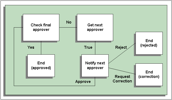

All approvals mechanisms used in SSHR follow a basic approval loop. The logic checks whether the current approver is the final approver in the hierarchy. If the current approver is not the final approver, the application fetches the next approver who then receives the approval notification. The next approver can either reject the transaction, approve the transaction, reassign the transaction, or send the transaction for correction to anyone in the approvals chain. The approver may also be able to update the transaction, depending on the system configuration.
The Basic Approvals Loop Using the Approval Chain

If necessary, you can review the logic in the check_final_approver and get_next_approver functions and modify them as required. These functions are within the HR_APPROVAL_CUSTOM package.
Make sure that your returned values are of the correct data type.
The following code shows the logic for the approval functions. If required, you can customize the code to use different approvals routings or to stop at a different grade level.
??-- -Check_final_approver

end check_final_approver; ()
- -Get_next_approver

end get_next_approver; ()
