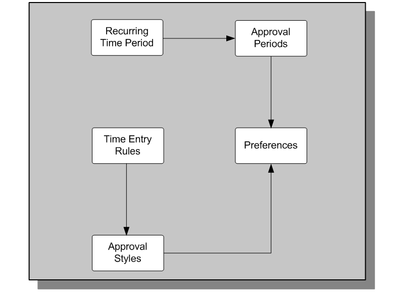

You can define various time entry validation rules and approval processes for time and labor data entered within Oracle Time & Labor.
Validation of the employee's time entry happens from any or all of the following:
Time Entry rules
Oracle Projects transaction controls and constraints
Oracle Human Resources eligibility criteria on element links
You associate an approval style with each employee using preferences. The approval style defines who approves the employee's timecards for each recipient application. The approver could be a named individual, the employee's supervisor, or more than one person in a workflow, or any other rules you define using a formula.
The approval style also defines which data needs to be approved for each application, and which data changes require resubmission.

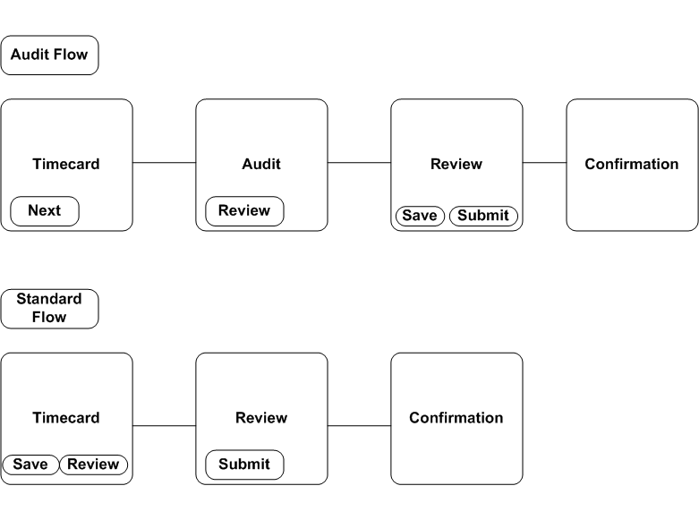

You can use the Change and Late Audit (CLA) feature in Oracle Time and Labor. This feature enables you to use time entry rules to determine which time entries you require for auditing purposes. You can also define additional validation rules to ensure workers enter a reason for the change or late time entry.

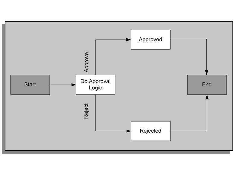

When a person submits their timecard for a period, Oracle Time & Labor check the person's approval style. The approval style includes time entry rules for each application. These rules define what data entry or changes require approval for that application.
For example, you could define that all information used by Oracle Payroll must be approved when it is entered or updated, whereas Oracle Projects data only needs to be approved if it exceeds limits that you specify in a formula.

Submission is when the completed timecards for the entire approval period are submitted for the first time.
Resubmission is when timecards have been approved and the employee makes changes to any of the time or labor data field.
Submission/Resubmission indicates approval is required on initial submission of the timecard and on resubmission when the employee changes the time or labor data after approval.
Save indicates approval is required when the worker selects the Save button on the timecard page.

Approval formulas use a separate formula type of OTL Approvals. Approval formulas have one mandatory return value called: TO_APPROVE with the value Y (to initiate the approval process) or N (indicating that approval is not required, which allows the timecard to Auto Approve).
OTL uses the approval formulas in the approval process by associating them to a time entry rule. You can select this time entry rule in the Approval Rules region of the Approval Style window.
If you do not specify any rules in the Approval Rules region, then the approval process uses the information in the Approval Styles Components region to execute the components. Additional rules in the Approval region provide a mechanism to choose between an auto approve process or an approval process you define.
If an approval rule returns TO_APPROVE equal to N, then OTL auto approves the timecard. If it returns TO_APPROVE equal to Y, then OTL uses the approval process in the Approval Style Components region.

You can define recurring time periods to determine the frequency of timecard entry and approval. In the Recurring Time Period window, you can select any of the predefined payroll period types (such as Weekly, bi-weekly, monthly) or you can create your own period by using the Duration in Days (such as 3 days, 7 days, 12 days). You can define as many recurring time periods as you require.
There is one predefined recurring, which is Weekly - Starts Sunday.
All the Recurring time periods you define are available for you to use in the two ways:
You can select them as timecard entry periods in the Preferences window.
You can associate them with an application to define approval periods in the Approval Periods window.
In some implementations, timecards are submitted for approval to an application at the end of the application's time period (such as the end of the payroll period). However, you might want timecards to be approved more frequently. For example, if the payroll period is monthly, you might define a weekly approval period for Oracle Payroll.
If you want to use different approval periods for different groups of employees, you can define more than one set of approval periods. Each set defines approval periods for some or all of the applications you use. You assign a set of approval periods to groups of employees using preferences.

There are various steps involved in setting up approvals. The diagram below illustrates how the approval definitions relate to each other. You can assign the definitions to a person or a group of people via preferences.
Setting Up Approvals
You can define approval styles and associate these styles to a person or a group of people using preferences. The two parts to an approval style are:
Time entry rules, which determine if a timecard requires approval when submitted or resubmitted.
Approval style components - determine the approval method to use for each application.

The item type has two attributes: PARENT_ITEM_TYPE and PARENT_ITEM_KEY. The Do Approval Logic function has a return type of Approval.
OTL delivers a server side package called HXC_SEEDED APPROVAL_WF (in files hxcseedaw.pkh and hxcseedaw.pkb, in $HXC_TOP/patch/115/sql), which contains the following procedures: do_approval_logic, approved and rejected. The corresponding nodes in the process call each of these procedures. The do_approval_logic procedure currently just returns an approval status of REJECTED. You can copy it and modify the copy to do more complicated processing.
This is how Oracle Time & Labor handles an approval workflow:
The process Find and Notify Approvers, which is part of the item type HXCEMP, sets the PARENT_ITEM_TYPE attribute to HXCEMP and the PARENT_ITEM_TYPE attribute to the item key of the workflow process in progress.
It then launches a new workflow process for the item type and process specified in the Approval Styles window, with a new item key (generated from a sequence). In the case of the predefined workflow, the item type is HXCEMP and the process is OTL_APPROVAL_SEEDED_WF.
The process is executed. It calls the do-approval-logic procedure, which returns APPROVED or REJECTED (the predefined example returns REJECTED). This result determines which procedure is executed next.
The procedure Rejected sets up the attribute WF_APPROVAL_RESULT (which is an attribute of the parent item type HXCEMP) to be REJECTED. It also sets up the attribute APR_REJ_REASON with a comment ('Rejected by Seeded Workflow'). The procedure Approved does the same thing for APPROVED.
The HXCEMP workflow is now finished and control is returned to the HXCEMP workflow, in the Find and Notify Approvers process. This process reads the approval result in the WF_APPROVAL_RESULT attribute and finishes approval processing.

Process Flow - control the page flow in self-service. If set to audit, the flow of the self-service timecard differs from the standard flow.
Rule Group - determines your time entry rule group that you can assign to a person or a group of people.
The process flow for change and late audit timecards varies from the standard flow of timecards. The following example displays the differences for change and late audit.
Process Flow
