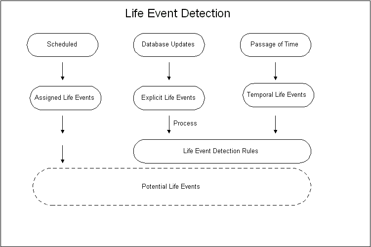

Advanced Benefits enables administration based on life events that occur to participants. You can generate enrollment actions, activity rate changes, and communications based on seeded life events or events you define.
You also use Advanced Benefits to design benefit programs that are based on flex credit accrual.
In addition to the core features available with Standard Benefits, Advanced Benefits comprises several distinct features:
Life Events: The system lets you trigger enrollments, activity rate changes, and communications based on the occurrence of a life event to a primary participant or dependent.
Life Event Reasons: These are the changes to a person's HR record that you define as valid reasons for an enrollment action. Life events can be external, such as the birth of a dependent, or internal, such as a work location change or the start of an open enrollment period.

You define a life event reason as a database change to a person's HR record. This change may require or enable an enrollment action. An enrollment action is an enrollment, de-enrollment, change in election, or change in contribution rate that is implemented either automatically, by default, or at the explicit request of the participant.
You link life events to scheduled enrollment periods, benefit plans, and communications. When a life event occurs to a participant, the system evaluates the life event to determine benefits eligibility and electable enrollment choices.
For example, if an employee's work location changes, you might want to evaluate this change to see if there is a corresponding change in benefits eligibility or contribution rates. If an employee's status changes from active to terminated, you may need to generate a continuing benefits action (such as for COBRA in the US).

You define a life event reason as any change to a person that impacts benefits participation. The system creates a life event when it detects a change in a person's HR record that you have defined as a life event reason.
You can define these types of life event reason:
Compensation--Use this type to set up one life event reason for each Compensation Workbench plan
Absence--Use this type to set up three life event reasons (Absence Started, Absence Ended, and Absence Deleted) to detect creation of, and changes to, absence records.
Checklist--Use this type to assign an HR administrator a series of tasks based on a common event, such as a new hire or termination.
If you use iRecruitment, use the iRecruitment type to set up one life event reason to process compensation plans for applicants.
In Advanced Benefits, assignment changes, an anniversary of employment, a marriage, or the occurrence of an open enrollment, are all examples of life events (in addition to the Compensation and Absence life event reasons). You can define life event reasons to determine key benefits processes, including:

Life events can be explicit, temporal, or scheduled.
Explicit life events are changes to a person's HR record, such as a job change.
Temporal life events occur with the passage of time, such as the six month anniversary of employment.
Scheduled life events are assigned life events, such as an open enrollment period.
Because life event detection can be complex, and because the accurate determination of qualifying life events is important to benefits administration, detected life events are initially given a status of potential so that they do not generate enrollment actions.
You can review potential life events for a person and then process the life event using the Participation batch process. Potential life events become active life events if they meet your plan design requirements. Active life events can trigger enrollment opportunities.
Life events are a cornerstone of benefits processing; understanding some basic terminology before you define any qualifying life event reason is important. The table below outlines the basic life event terminology:
