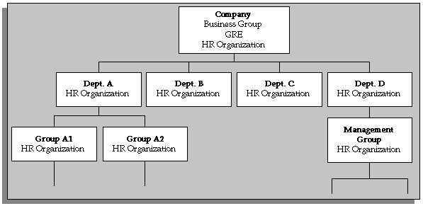

Organization classifications define the purpose of an organization and its functionality within Oracle HRMS. The classifications you assign to an organization control the additional information you can set up at the organization level. The Configuration Workbench automatically assigns the appropriate classifications to the organizations it creates.
For more information on the key organization structures you use to represent your enterprise, see: Key Concepts for Representing Enterprises
You can define one organization with multiple classifications or you can define separate organizations to represent different types of entity. For example, you can classify an organization as a legal entity as well as an HR organization if it's the same organization. If they are different, then you create two organizations.

Business Group: Use this classification to group, manage, and control access to data in accordance with the rules and reporting requirements of a country.

HR Organization: Use this classification for all organizations to which you want to assign employees and contingent workers.

Small and medium sized enterprises, owned by individuals are not issued a Corporate Registration Number. In such cases, the enterprise uses the registration number of the owner as the corporate registration number.
Enterprises with only one corporate registration number need only one GRE in which to place all employees. In Oracle HRMS, the business group and the GRE are the same organization. Appearing below is an example organization chart for a business group with one GRE.
Single Company Business Group/GRE
In a company like this, some employees can have assignments to the business group organization itself, if it also has the classification HR Organization. Most have an assignment to one of the various HR Organizations subordinate to the business group. All employees belong to the same GRE, which pays them, withholds their taxes, and provides reports on various matters concerning them to government agencies.
In other large enterprises, the GREs responsible for paying groups of employees are not the same as the companies within the business group, which may be organized, for example, according to the particular types of work or projects they undertake. The figure above reflects the structure of companies in this type of enterprise. The figure below represents the employing organizations that pay employees, and have a separate structure that is independent of the companies.
In this type of enterprise, employees assigned to a particular GRE may have a work assignment to any company, constituting the enterprise, and a particular company can include employees assigned to several different GREs.
In enterprises like this, employees are clear about which company they are working in, but may be unaware of their membership in a separate GRE. As the functions of GREs relate to payroll administration and governmental reporting, they have little direct impact on employees' daily lives at work.
