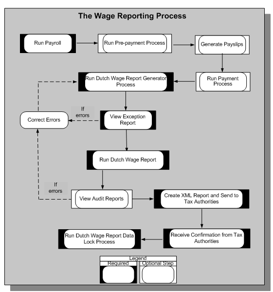

Wage reporting is a multistep process that employers follow to submit the wage report to the tax authorities for every payroll period. The wage report contains information about the employer, the personal and assignment information of all employees, and corresponding payroll-related information. Oracle HRMS enables you to process the wage report as shown here:
Oracle HRMS uses this process to validate the social insurance and tax information available for wage reporting so that the report information complies with the legislative requirements. When you run the generator process, the application archives the relevant report information required for the wage report.
The Dutch Wage Report Generator process validates the wage report information and, if information is incorrect or missing, generates an exception report. After correcting any errors, you run the generator process again until you have no errors.
See: Running the Wage Report Generator Process
Once the generator process has run without error, you can run the Dutch Wage Report process, which generates two types of reports:
Audit reports, which are in PDF format so that you can easily verify the report contents
XML Report, which you send to the tax authorities
See: Running the Dutch Wage Report
You run the Dutch Wage Report Data Lock Process after the tax authorities have confirmed that your wage report is valid. This process prevents you from accidentally rolling back the generator process, which is the source of the wage report you submit to the tax authorities.
See: Running the Dutch Wage Report Data Lock process

Before you run the Dutch Wage Report:
Set up tax and social insurance deductions.
If required, use the Legal Employer classification to record additional reporting employers for the wage report. You can record information, such as tax reference number, reporting name, and the HR organization. This task enables you to have multiple wage reports per employer.
Record additional organization information as follows:
Use the Wage Report Information window to record the wage report information.
Record the risk group and sector information using the Dutch UWV Organization window.
See: Dutch UWV Organization: Entering Dutch SI Provider Information
Record additional assignment information using the Assignment window:
Use the Dutch Temp Labour Information window to record the Temp Labour Code.
Use the Dutch Influence Information window to record Influence Code.
Use the Dutch Labour Relation Information window to record Labour Relation Code.
Use the Further Collective Agreement Details descriptive flexfield in the Collective Agreements window to record the collective agreement code.
Note: The application reports this collective agreement code only if you use the global collective agreement functionality.
Link the legal employer to a payroll using the Further Payroll Information window. This task enables you easily to identify all employees and assignments belonging to a specific employer for the wage report.
Link predefined elements, such as Holiday Coupons, Incidental Income Decrease, Additional Allowance, and New Wage Report Override. These element entries indicate whether an employee is eligible for employee benefits, such as holiday coupons and additional allowance over the UWV payments.
To report a RetroPay calculation as a correction in the wage report, you must create an element entry for the New Wage Report Override element. The application then reports the entry under the Correction section in the wage report. This is only applicable using the old retropay. Using the adjustment retropay, all adjustments will be reported in the current period and all corrections will be reported in the correction section of the wage report.
You can use the element-link criteria to control eligibility for these elements based on your business requirements.
When you process retropay for the previous year, ensure that you run it as an adjustment.
Set up appropriate feeds for the following balances:
Wage Tax Subsidy Arbo Non Profit
Wage Tax Subsidy Ses Going EES
Wage Tax Subsidy Research
Reservation Holiday Allowance
Additional Period Wage
Reservation Additional Period Wage
Overtime
WWB Allowance Paid Alimony
Directly Paid Alimony
Hours Worked
Note: You need to feed these balances manually using user-defined elements, as the application does not feed these balances using a classification or a sub classification.
You can use the global Payroll Event Model functionality to monitor and report the HR data changes to the tax authorities through the wage report. To be able to monitor and report HR data, you must enable the Incident Register for your business group from the time you want to start monitoring changes to avoid getting invalid record in the Wage report you generate first. Use the Functional Area Maintenance window to enable the Incident Register.
For monitoring and reporting payroll changes, use the RetroPay functionality to process retrospective calculations and then use the predefined element New Wage Report Override to manually indicate which retrospective calculation is a changed event either as an adjustment or correction.
You can exclude a complete period previously reported for an employee by selecting Withdrawals as the value for the New Wage Report Override element.
To avoid displaying correction amounts from the previous period in the wage report, use the Adjustment component as the RetroPay type.
Use the Application Utilities Lookups window to add sector codes to the NL_SECTOR lookup.
Use the shared type NL_NATIONALITY in the User Types and Statuses window to map the nationality codes to NEN1888 Norm.
See: Creating User Types and Statuses, Oracle HRMS Configuring, Reporting, and System Administration Guide
Use the NL_EMPLOYMENT_CATEGORY shared type in the User Types and Statuses window to map employment category to code contract.
You are now ready to run the Dutch Wage Report Process.
See: Dutch Wage Reporting
You run the Dutch Wage Report Generator before running the Dutch Wage Report. The Dutch Wage Report generator validates and archives the required reporting information for the Dutch Wage Report.
Use the Submit Requests window to run the Dutch Wage Report Generator.
To run the Dutch Wage Report Generator
In the Name field, select Dutch Wage Report Generator. The Parameters window opens
Enter the effective start and end dates.
Select the legal employer.
Select the payroll type, such as calendar month or weekly.
Enter the sequence number.
Correction Report – Select Yes if this is a correction.

The Dutch Wage Report includes the total wages paid to employees, social insurance and tax contribution details, and various tax amounts to be paid to the tax authorities.
Use the Submit Requests window to run the Dutch Wage Report.
In the Name field, select Dutch Wage Report. The Parameters window opens.
Select the wage-report-generator request ID you want to report on. The application generates this ID when you run the Dutch Wage Report Generator process.
Select the report type.
Audit Reports, which you can run for some or all wage-report information, enable you to identify and correct errors before generating the XML report.
XML Report generates the complete report you send to the tax authorities.
To include information for specific employees only, select an assignment set.
Specify the order of the report information.
Click OK.
Click Submit.
You run the data lock process to ensure you do not accidentally roll back the Dutch Wage Report Generator process after submitting the wage report to the tax authorities. The data lock process locks all the actions performed on employee assignments since you run the wage report generator process. You use the Submit Requests window to run the data lock process.
