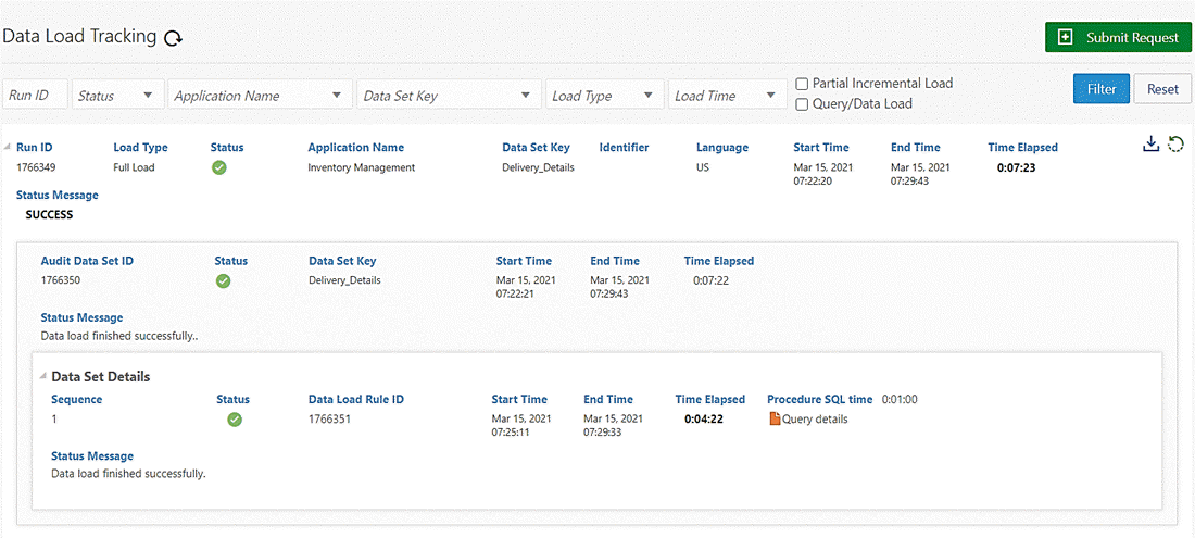

The data load tracking page provides details regarding the time elapsed at various stages of data load processing. This serves as a robust assessment of performance allowing the administrator to take initiatives related to performance improvement.
The Data Load Tracking page lists data loads, along with a search feature. For a given load, you can access the run ID, load type, status, application name, data set key, language(s), and time of load. For more information, see: Data Load Tracking.
Example of Data Load Tracking

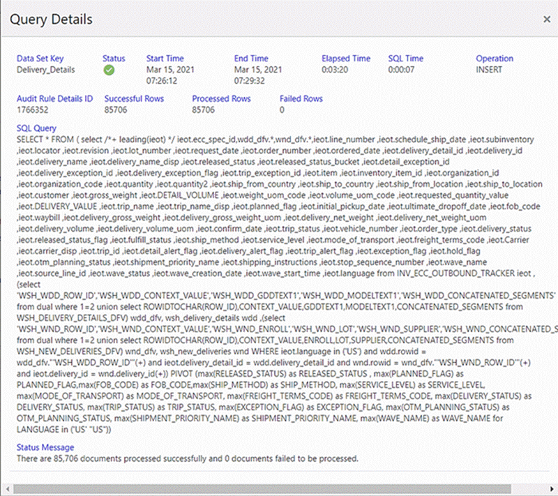

You can expand the Data Set Details region for a link to the Query Details page. This page includes SQL query run, the time it was run, and the number of rows processed, and other information.
Example of a Query Details Page

The data load tracking page also details the SQL query that has been run during the data load operation for each data set, the number of records processed, and the number of records ingested. These details allow administrators to determine if there are any data- or query-related issues so that they can take corrective actions in the proper direction.
