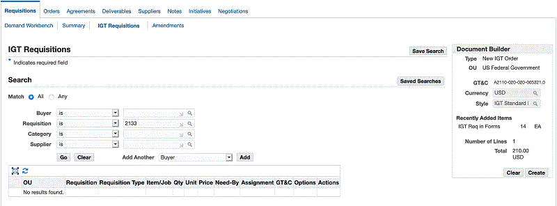

You can create IGT requisitions in Oracle iProcurement using the web interface, or in Oracle Purchasing using the Oracle Forms user interface. You can also create Military Interdepartmental Purchase Requests (MIPRs) using intergovernmental requests in Oracle CLM with iProcurement.
When a requisition is approved, funds are committed and then you can add the requisition to an IGT order. When the order is approved, the funds move from commitment to obligation.
Departments and agencies within the Department of Defense (DoD or non-DoD) use MIPRs to create requests for goods and services provided by other departments. MIPRs provide funds details and descriptions of goods and services. Requesting agencies create and transfer MIPRs to servicing agencies. When a servicing agency accepts an MIPR, the requesting agency records the acceptance and adds the MIPR to intragovernmental orders. In EBS, you can create an MIPRs on the Intragovernmental Requests page and then add the requisitions to IGT orders.
In Oracle iProcurement you can create IGT requests and commit funds if you have access to the Intragovernmental Request subtab in the Shop tab. Contact your administrator if this subtab is not available to you.
This subtab is available if your responsibility or user has the role ICX: Intragovernmental Request Access Role.

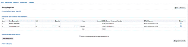

Click the shopping cart to save it or to check out.
For each item, the shopping cart displays the item description, unit, quantity, price, amount, source document number, and GT&C number.

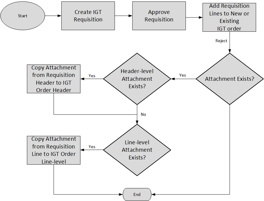

Oracle Purchasing supports creating intragovernmental (IGT) requisitions for G-Invoicing.
The Intragovernmental option is included in the Requisitions window.
Note: To display and use the Intragovernmental option, set the FV: Federal Enabled profile option to Yes at the responsibility or user level.
When you select the Intragovernmental option, you create an IGT requisition. Once approved, it is available in Buyer Work Center so that it can be placed on an IGT order.

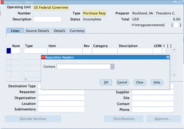

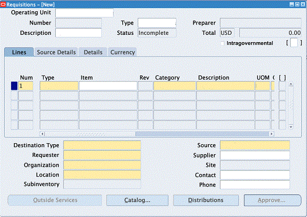

To enter IGT requisition lines, perform the following steps:
Choose the Purchasing, US Federal responsibility.
Select Requisitions and then Requisitions.
The Requisitions window appears as shown below:
Requisitions in the Forms User Interface
Select the Intragovernmental option.
When this option is selected, Oracle Purchasing displays only IGT-related attributes in the list of values.

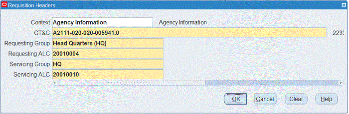

Click the DFF next to the Intragovernmental option.
The Requisition Header dialog box appears:
Requisitions
In the Requisition Header dialog box, enter "Agency Information" in the Context field. The remaining fields appear after you select the context, as shown below:
Requisition Header
Select a GT&C.
Select the requesting group.
Select the requesting ALC. The ALC assigned to the requesting group appears.
Select a servicing group.
Select the Servicing ALC from the LOV. The ALC assigned to the servicing group appears.
Click OK.

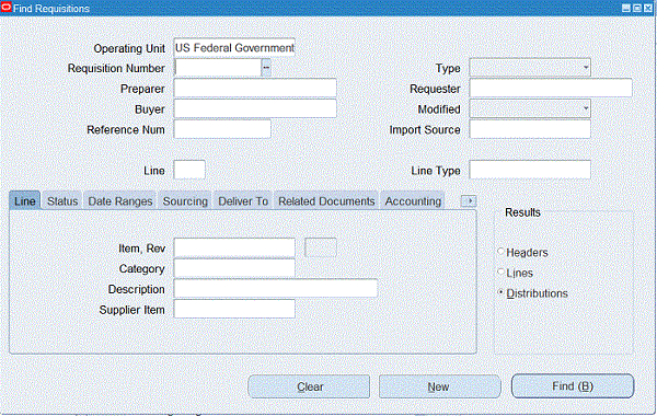

You can view the recently created requisition details using the following methods:
Using the Requisition Summary
To view the requisition details, perform the following:
From the Home page, select the Purchasing, US Federal responsibility.

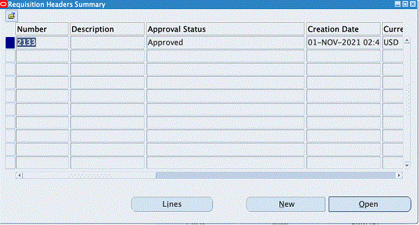

Click Requisitions and then Requisition Summary.
The Find Requisitions window appears as shown below:
Find Requisitions Window
Enter a requisition number.
In the Results region, select a summary level:
Header: View the requisition header summary.
Lines: View the requisition lines summary.
Distributions: View the distribution details.
Requisition Headers Summary Window

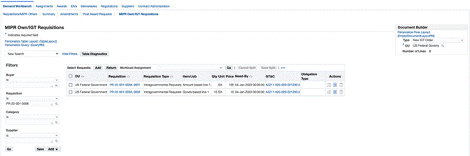

Using the Demand Workbench in Buyer Work Center
When the requisition is approved in the Oracle Forms interface, the requisition lines become available in Demand Workbench for addition to IGT orders.
Changes to Searching Requisitions in the Demand workbench of Buyer Work Center
In the Requisition Summary Page, agencies can filter records by GT&C number specific to a GT&C. The GT&C along with contract are added in the results table.
In the IGT Requisition page on the Demand Workbench of Buyer Work Center page, the Requesting ALC and Requesting Group have been added as additional search criteria.
Document Builder on the IGT Requisitions Page
Perform the following steps to add the requisition to an IGT order:
Set the type to New IGT Order or Add to IGT Order.
Enter the OU.
Select requisition lines and click Add.
The selected requisition lines are added to document builder.
Click Create.
An IGT order is created, and the Update IGT Order page appears.

To modify a requisition, perform the following steps:
In EBS, click the Purchasing, US Federal, Standard (Forms based Requisitions), Federal iProcurement, Standard (Purchasing) or CLM iProcurement, Standard (CLM) responsibility.
In forms-based requisitions, query for the requisition and click Tools and then Change. If you are using iProcurement, then from the My Requisition region, click the Change icon, if it is enabled.
Or, click the Requisitions tab, and then select a requisition to modify, then click Change option. The Change Requisitions page appears.

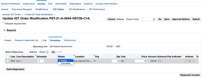

Click Create. The order modification is created that you can view in the IGT Modifications page.
Click Orders tab and then IGT Modifications subtab.
Select the order that was modified, click Update and then Go. The Update Standard Purchase Order Modification page appears.
Click Schedules and verify the updated requisition changes reflected in the order line schedules. In the cases where the original requisition and the order are not the same, the system does not update the order line schedules automatically in the modification and the agency receives a message notification that the changes are not propagated automatically. The agency must add these changes manually. For information on the values that need to be updated, check the requisition change history.
Click Submit. From this point on, the order modification follows the existing order modification approvals lifecycle.

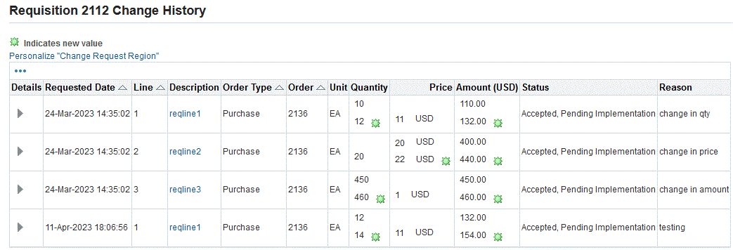

From the IGT requisitions page you can view the change history of a requisition. To view the change history for a requisition, perform the following steps:
In EBS, click the Purchasing US Federal Super User responsibility.
Click Buyer Work Center and then Requisition. The Demand Workbench page appears.
From the Requisitions tab, click the IGT Requisition subtab. You can filter requisitions by changed IGT requisitions as shown:
View Change History
From the Actions filed, click the View Change History icon. The Requisition Change History page appears.
The status displays Accepted, Pending Implementation before implementing the change to IGT order. Once the change is implemented, the status changes to Accepted Implemented.

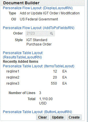

You can select requisition lines and add them to a new IGT order or to an existing IGT order. If the group by default is selected then when you specify the Order Number, the system verifies if the requisition lines have similar data as in the existing orders. If they are identical, then the system adds the requisitions to the same order (does not create a new order line) but creates multiple order line schedules for each of the requisition lines. This grouping is applicable to new IGT order, existing incomplete IGT Order, new modification, and draft modifications. To group requisition lines, perform the following steps:
In EBS, click the Purchasing US Federal responsibility.
From the Requisitions tab, click the IGT Requisition subtab. You can filter requisitions by choosing the My IGT requests or use search criteria to filter requisition lines.
Select the requisitions that are not placed in an IGT order.
In the Document Builder in the sidebar, click and select New IGT Order.
Click Add in the Select Request and then Go.
The selected requisition lines are added to the document builder as shown in the image:
Requisition Lines in Document Builder for Grouping
Document Builder in Demand Workbench
If the selected requisition lines have similar data, then the system groups them and creates one order line for the grouped requisitions and maintains the multiple order line schedules to match the requisition lines. For example, if the agency selects 10 requisition lines, out of which 4 have similar data, 3 others have similar data and 3 others have similar data. In this case, the system groups these requisitions into three groups and creates three order lines. The requisition lines are grouped by default.
If the agency decides to override the default requisition lines grouping, then they can set the PO: Default Requisition Grouping to Requisition. The system does not group the requisition lines. If you have set the profile option to Default, you decide not to group the requisition lines, then you can override the setting by choosing Requisition in the Update Document Builder page.
To view the grouping details, Update in the Document Builder in the sidebar.
Click Apply. The system navigates you to the Document Builder page.
Click Create. The system proceeds with order creation.

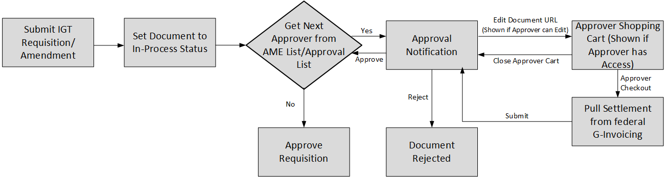

This functionality enables approvers, PMO office, with the editing privilege to edit an IGT requisition or an IGT order when approving. The updated requisition or an order is shared with the next approver in the approval process to approve or reject them.
The following diagram illustrates the flow of editing an IGT requisition from iProcurement in Oracle EBS:
Process Flow of Editing IGT Requisition During an Approval Process
The process flow is as follows:
The requesting agency submits an IGT requisition for approval.
The requisition status is set to in-process.
The approver gets an approval notification.
If the approver has the editing privilege, then the Edit Requisition option is enabled. Clicking the edit requisition, the update requisition page appears.
The approver can edit the fields.
The agency can apply the changes and submit the revised requisition for the next approval in the chain of approvers.
If the document passes all submission checks, then the changes are saved after editing the document through notification. After the changes are saved, if the approver rejects the document, then the changes are not automatically reverted. In such a case, the agency must reverse the changes manually.
After all the approvers have completed approvals, the signer can perform the final approval.
The following diagram illustrates the flow of editing an IGT requisition from Forms in Oracle EBS:
Process Flow of Editing an IGT requisition from Forms
The approver can edit the fields. Apply the changes and submit it for the next approval in the chain of approvers.
The approver at every stage has the option to either approve or reject the updated requisition.
Each approver can either approve, edit, or reject the requisition. If the approver has the editing privilege, then they can update the requisition and then approve it.
After all the approvers complete the approval process, the signer can perform the final sign off and submit.

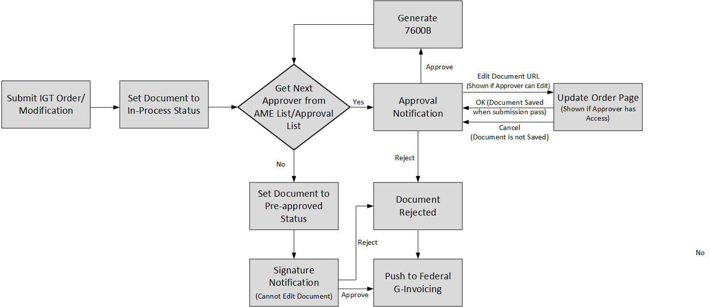

The following diagram illustrates the flow of editing an IGT requisition from orders from CLM Purchasing in Oracle EBS:
Process Flow of Editing an IGT Order During an Approval Process
The requesting agency submits an IGT order or order modification for approval.
The order status is set to in-process.
If the approver has the editing privilege, then the Edit Document option is enabled. Clicking the edit document, the update IGT purchase order page appears.
The approver at every stage has the option to either approve or reject the updated order.
Each approver can either approve, edit, or reject the IGT order. If the approver has the editing privilege, then they can update the order and then approve it.

The Update IGT Purchase Order Approval page appears.
Click Submit for approval.
Click Continue to complete the approval process.
You can notice the modified changes are reflected in the order line details.
Click Approve or Approve and Forward to either approve or approve and then forward the requisition the next approver in the line of approvers.
Note: When the approver edits the order and approves it, the 7600B is generated reflecting the changes and is added as an attachment to the document.
This functionality enables the requesting agency to add an attachment when creating an intragovernmental requisition. A new attachment category, Requesting Agency, is added on the Attachments page. The agency can add an attachment at the requisition header and requisition line levels. When the requisition containing the attachment is added to a new or an existing IGT order, these attachments are copied over to the header and the line regions of the IGT order.
Only the attachment at the order header-level with the Requesting Agency category file type is pushed to federal G-invoicing. If requisition lines from one requisition are placed on different IGT orders, then the requisition header-level attachment is copied to the order header in both the orders.
If the requisition line is added to an IGT order modification, then the attachment is copied to the order modification as well. After the order modification is approved, attachments are copied to the order header.
The following diagram illustrates the flow of adding attachments from an IGT Requisition into an IGT Order in Oracle EBS:
Automatic Creation of IGT Orders and Modification from IGT Requisition Lines
The process flow of adding attachments from requisitions to IGT orders is as follows:
The agency creates an IGT requisition and sends the request for approval.
The agency then selects the attachment category type, Requesting Agency.
The agency then adds attachments at the header and requisition line levels.
The agency adds the requisition lines to create a new or an existing IGT order.
If the requisition contains attachments at the header and the line levels, then they are copied to the corresponding IGT header and order line levels.
Once the order is saved, the header level attachments are pushed to federal G-Invoicing.
Perform the following steps to add attachments to IGT requisition:
From the Home page, click the iProcurement Federal or CLM Purchasing Federal responsibility.
Click iProcurement Home Page.
Create an intragovernmental request or select an IGT request.
Click Add to Cart and Next.
Click View Cart and Checkout.
The Shopping Cart page appears.
Click Checkout.
The Checkout: Requisition Information page appears.
Click Edit Lines.
The Requisition Information: Edit Lines page appears.
Click the Attachments tab.
The Requisition Attachments page appears.
In the Requisition Attachment region, click + to add an attachment.
The Add Attachment page appears.
For Category, select Requesting Agency.
Browse and attach a file.
Click Apply.
The cursor returns to the Add Attachment page.
In the Requisition Line Attachment region, click Add Attachment.

Perform the following steps to add IGT requisition lines to create an IGT order or order modification:
From the Home page, click CLM Purchasing Federal.
Click Buyer Work Center and Requisitions.
Click IGT Requisitions.
The IGT Requisitions page appears.
Select the requisition to add to a new or an existing order.
Click Add.
In the Document Builder on the right, click Create.

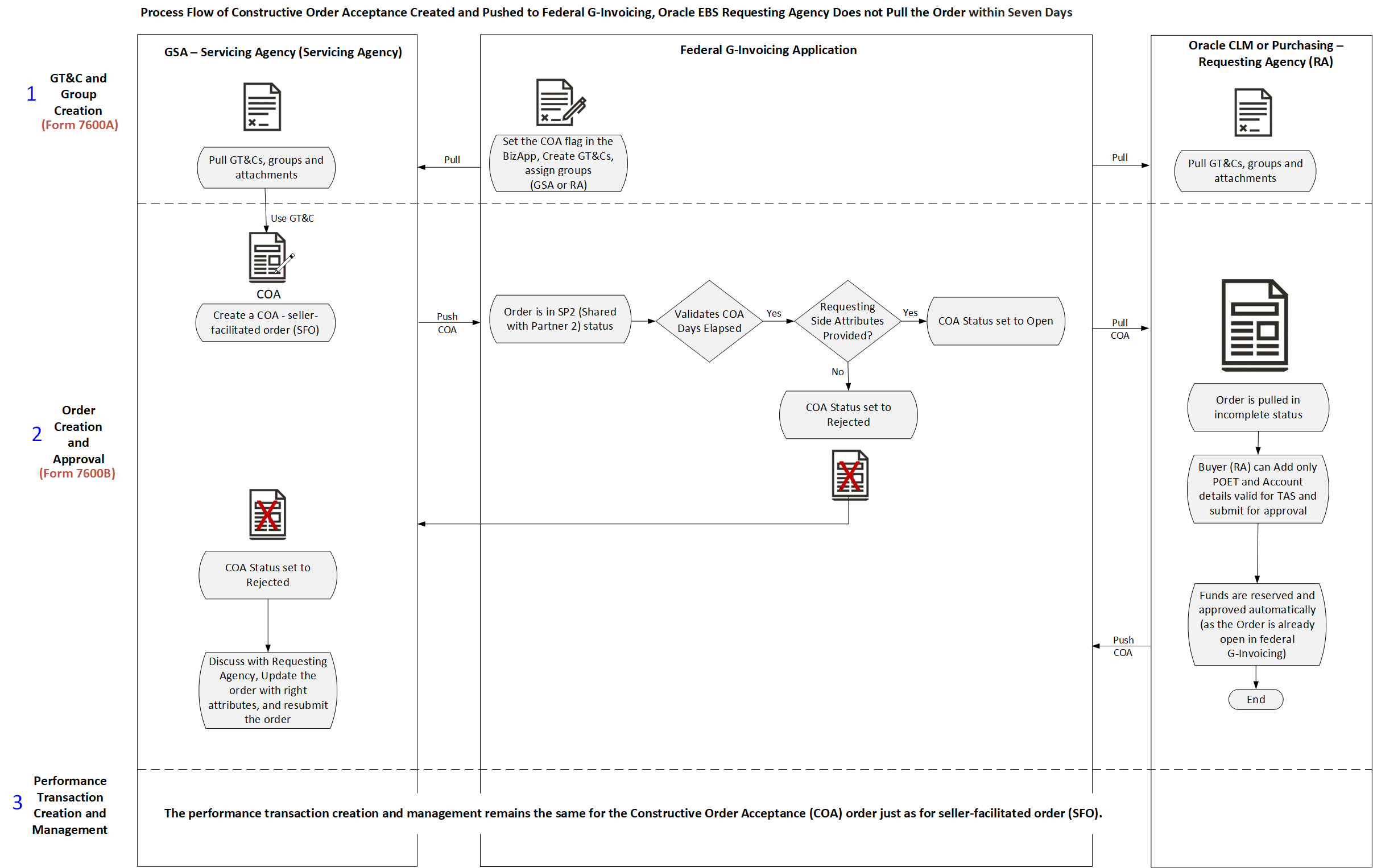

When a buyer-initiated order (BIO) is accepted by the servicing agency, the when the order is received by and the order status in the Actions History displays Acceptance received from Servicing Agency.
After this step, the funds are reserved and obligated. The order status changes to Approved, Reserved and the G-Invoicing status remains at Open.
When a seller-facilitated order (SFO) is outright rejected, the order status in the Action history displays who and when the order was rejected with the status, Rejected by Requesting Agency.

To add requisitions to an IGT order, perform the following steps:
Select the CLM Purchasing Super User responsibility.
Click Buyer Work Center, and then Requisitions.
Click the IGT Requisition subtab from the Requisitions tab.
Search for IGT requisitions.
The results table displays the OU, requisition (request number with line ID), GT&C, group, ALC, item, quantity, unit, price, need by date, and actions.
Set the type to New IGT Order or Add to IGT Order/Modification and enter the operating unit. The default is New IGT Order.
Select the requisition and click Add.
Note: Selected requisition lines must have the same GT&C number, group, ALC, and agency identifier.
The requisition line is added to the document builder.
If you selected New IGT Order, document builder creates a new IGT order with the requisition and line referenced in the Distribution page.

Order lines with requisitions can be modified to change the quantity or price until they are added to an order. You can change the price and quantity at the order level. Funds are calculated based on the following scenarios:
When the quantity or price is reduced: The funds for the reduced value are moved from obligation to the budget pool (not to the requisition).
When the quantity or price is increased: The funds for the increased value are moved from the budget pool to obligation.
Note: In these scenarios, increasing funds during an order modification is not supported in Oracle CLM.
When the requisition line is added to an order or modification, if the requisition line amount is greater than the order line or schedule, the excess funds in the requisition are liquidated and sent back to funds available or to the budget pool. If the requisition line amount is less than the order line or schedule, then funds in the amount of the requisition line are moved from commitment to obligation. Excess funds are moved from the budget pool to create obligation. This applies to both new orders and order modifications.

You cannot select an operating unit in the Create IGT Order page when the Buyer-Initiated Order field is set to G-Invoicing for the operating unit in G-Invoicing options.
Also, you cannot add requisition lines to Document Builder to create an IGT order if you select an operating unit for which the Buyer-Initiated Order field is set to G-Invoicing in the G-Invoicing Options page.

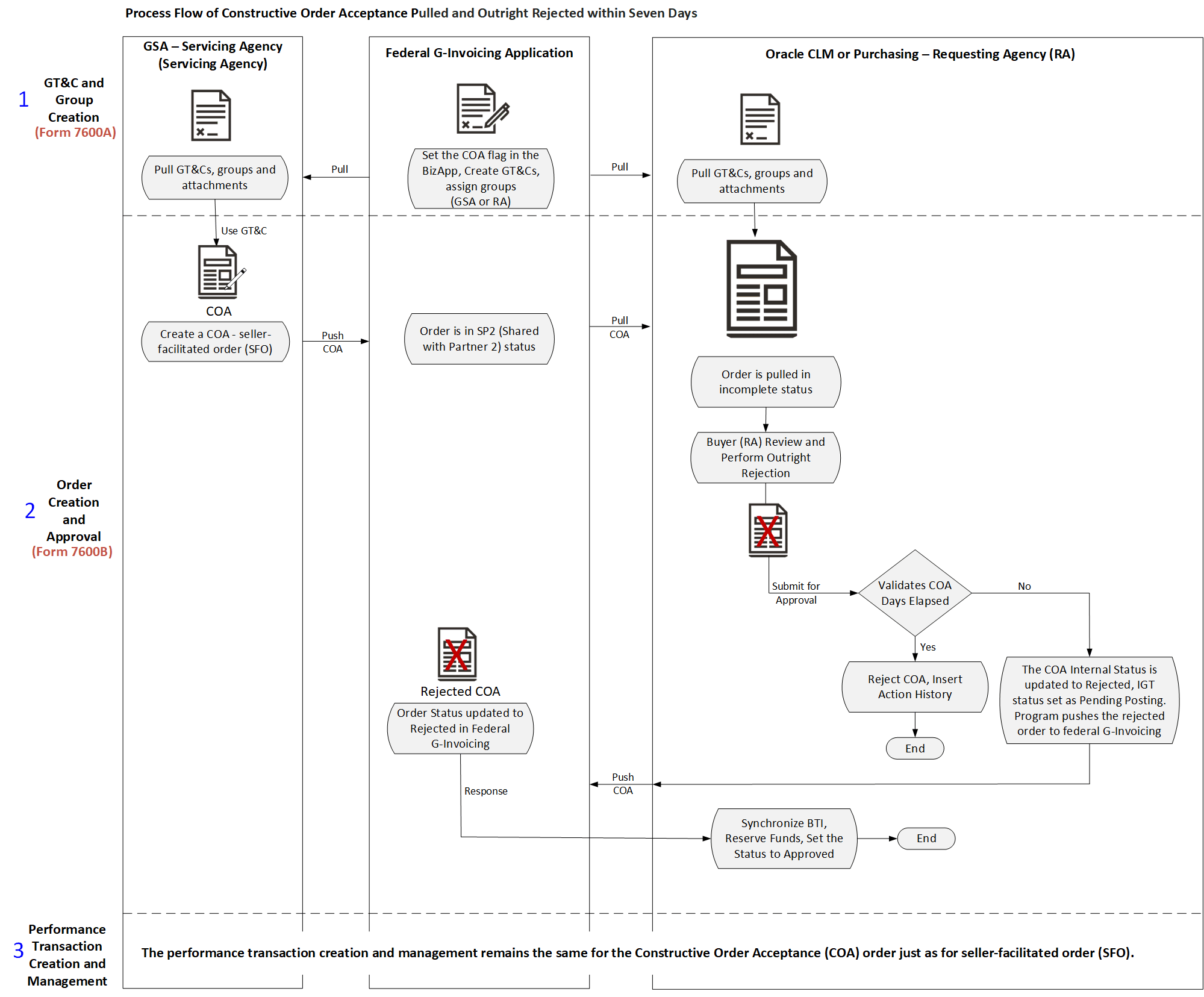

When the requesting agency rejects an order, the request XML program pushes the rejection details to G-Invoicing. The servicing agency corrects errors or makes other changes and then sends the order to the requesting agency again for approval.
When an order is rejected, the G-Invoicing status and the order status display as Rejected.
Note: All setup requirements for the EBS G-Invoicing solution are necessary for seller-facilitated orders.

When the requesting agency rejects an order modification, it is pushed back to G-Invoicing with the status Rejected. The servicing agency corrects errors or makes other changes and then sends the modification back to the requesting agency once more for approval.
Note: Admin changes from the servicing agency are updated in the requesting agency system along with the regular modifications.

The 7600B document is a printed version of the agreement between two federal program agencies for a reimbursable intragovernmental order. Some agencies might need this document in order to get approval for their orders. The 7600B document is generated and sent to the approver in a notification every time the order is submitted for approval. The approver can print it and have it signed by the program and funding officials, and then scan and attach the signed document to the approved IGT order.
The 7600B document is supported for the following G-Invoicing features in EBS:
Buyer-initiated orders (BIOs) created in Oracle CLM or Oracle Purchasing
Seller-facilitated orders (SFOs) updated in Oracle CLM or Oracle Purchasing
BIOs or SFOs created in G-Invoicing and pulled into Oracle CLM or Oracle Purchasing (when EBS is used as the financial system)
You can download the 7600B document at multiple points in the IGT order creation, modification, and approval lifecycle, from the following pages:
IGT Orders Summary
IGT Order Modifications Summary
IGT Order Approval Notification
To view the 7600B document from the IGT Order Summary page or the IGT Order Modification page, perform the following steps:
From the Home page, select the CLM Purchasing Super User or Purchasing US Federal responsibility.
Click Buyer Work Center and then click Orders.
In the Orders tab, click the IGT Orders subtab or, for a modification, click the IGT Modifications subtab.
Search for and select the order for which you want to view the 7600B document.
From the Select Order or the Select Modification list, select View 7600B.
Click Go. The system generates the 7600B document as a PDF file, which you can print.
To download the 7600B document from an approval notification, perform the following steps:
Log in as the order approver.
Select the IGT order notification.
Click the order to approve.
Click the Attachment icon to view and download the attachment.
Save and print the attachment.
The IGT Order Summary page includes an Add Attachments option in the Actions menu. This action is enabled only for approved orders. When you add an attachment to an approved order, select Requesting Agency as the category to post the attachment to G-Invoicing.
To attach the scanned 7600B document to the order, perform the following steps:
To add the signed copy of the 7600B document, select Add.
Select Requesting Agency to share the document with the federal G-Invoicing application.
Select Internal to Purchase Order to save the document in EBS and not share with the federal application.
Click Apply.

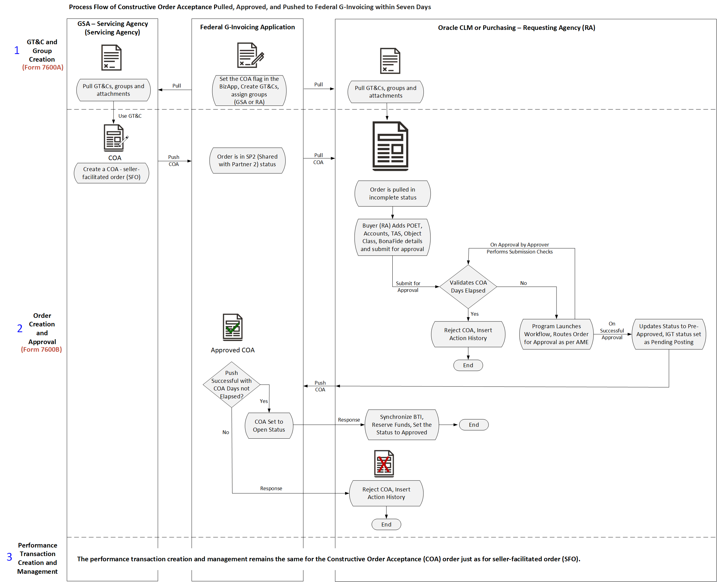

The Oracle E-Business Suite G-Invoicing solution provides support to accommodate General Services Administration (GSA) rent by offering Constructive Order Acceptance (COA). The agencies can accomplish the following:
Seller (in this case, GSA) to provide all required order data.
Buyer (requesting side - Oracle EBS) can either approve, dispute, reject, or close COA.
Support other business applications with a similar use case.
The GSA negotiates the terms and conditions with their trading partners and provides the following data when creating GT&C in federal G-Invoicing:
Business Application must be set to Constructive Order Acceptance.
BizApp Rule COA Days set to 7 days.
Order Originating Partner Indicator (on GT&C) is set to Servicing Agency and it cannot be changed.
Assisted Acquisition Indicator (on GT&C) is set to No, and it cannot be changed.
When GSA creates an order from the COA-enabled GT&C, they must provide the following details:
Provide all the servicing and requesting agency details.
Set the FOB Point to Source and the Assisted Acquisition Indicator is set to No by default.
Servicing Agency can enter the Bona Fide Need, Requesting Cost Center, Business Unit and Department ID, Object Class Code, TAS, and BETC (can be modified).
The order is shared with the requesting agency in the SP2 (Shared with Partner 2) status. The requesting agency pulls COA, and the approval notifiers must take action within the stipulated 7 days from the day of COA order creation. The requesting agency can enter the details, push it back with approval to federal G-Invoicing. If the approval and push is completed within the 7 days, then the status in federal G-Invoicing changes.
If the requesting agency does not take action within the 7 days, and COA acceptance date elapses, then the COA in the federal agency is approved automatically with the details entered by GSA. When the subsequent Intragovernmental Order pull is run, the status is updated in Oracle EBS, and any changes done by the requesting agency in Oracle EBS will be lost. In the case, when the requesting agency outright rejects the COA, the order is pushed to federal G-Invoicing. GSA corrects details in the order and resubmits. The COA acceptance days are reset to 7 days from this point in time.
Note: Constructive Order Acceptance (COA) is supported only in the JSON REST services format.
If an agency submits an approved Order with an outdated business transaction identifier (BTI), then the request results in an error.
The COA accepted orders have the following characteristics:
Status is set to REC (open).
Missing approval date is set to the current date.
Missing approver name is set to System.
Missing approver title is set to Constructive Order Acceptance.
Missing approver Email address is set to Do not Reply.
Missing approver phone is set to Do not Call.
The performance handling stays the same and there are no changes.
For rent, GSA submits Delivered or Performed performance once the COA order is approved. In this case:
The performance quantity equals the schedule quantity.
The performance quantity represents the summarized amount.
GSA posts detail charges on Rent on their website
The requesting agency creates a received or accepted performance. This includes:
Confirms the settled amount and quantity.
Different quantity to dispute the amount settled.
Adjustments can occur, possibly years later:
Orders must be reopened by GSA with an order modification.
Adjustments must be charged to an open accounting period.
COA is supported with the JSON REST services.
Subsequent sections describe the process flows of Constructive Order Acceptance (COA) in various conditions.
Following changes are implemented in the user-interface to accommodate COA functionality:
New search filters are added to the Intragovernmental Orders page that lets you narrow your search with BIZapp as COA.
In the IGT Order and Order Modification pages, the Constructive Order Acceptance flag is displayed to differentiate an SFO from the COA-enabled orders. It also displays COA Days Remaining.

The following topic covers the COA pulled and approved and pushed to federal G-Invoicing within the 7 days:
Process Flow of Constructive Order Acceptance Pulled, Approved, and Pushed to Federal G-Invoicing within Seven Days
The process flow of constructive order acceptance scenario one is as follows:
The US General Services Administration (GSA) creates the general terms and conditions with the business application COA flag enabled.
The originating partner indicator is set to Servicing Agency by default and the Assisted Acquisition Indicator (on GT&C) is set to No.
GSA creates the COA-enabled seller-facilitated order using the GT&C in federal G-Invoicing and the order is shared with the partner in the SP2 status.
The requesting agency pulls the COA into Oracle EBS.
The requesting agency reviews and enters required attributes such as TAS, Object class, Bonafide need, point-of-contact details.
Enter the POET and CCID valid for the specified TAS and BETC.
The COA is submitted for approval.
The approver in Oracle EBS gets the notification, approves the COA. The system sets the internal status to Pre-approved and the IGT status is set to Pending posting.
The Intragovermental Order Push program pushes the approved COA to federal G-Invoicing. On successful posting of the COA, the order status is changed to Open.
The response is pulled into Oracle EBS that synchronizes the business transaction indicator (BTI), reserves funds, and the order status is changed to Approved.
GSA can now submit performance for the COA.
Performance creation and management remains unchanged.
The following topic covers the COA outright rejected and pushed within the 7 days:
Process Flow of Constructive Order Acceptance Pulled and Outright Rejected within Seven Days
The requesting agency reviews and rejects the COA immediately.
When the order is rejected, the application validates if the COA 7 Days have elapsed.
If the COA days have elapsed, then the internal status is set to Rejected and the action history is captured.
If the COA days have not elapsed, then the internal status is set to Rejected and the IGT status is set to Pending posting.
After the order is rejected successfully in federal G-Invoicing the response is pulled into Oracle EBS.
The following topic covers the COA created and pushed to federal G-Invoicing but not pulled into Oracle EBS by the requesting agency within the 7 days:
Process Flow of Constructive Order Acceptance Created and Pushed to Federal G-Invoicing, Oracle EBS Requesting Agency Does not Pull the Order within Seven Days
The requesting agency does not pull the COA into Oracle EBS within 7 days.
In federal G-Invoicing, the system checks if the COA 7 Days have elapsed.
If the COA days have elapsed, then the system checks if the requesting agency attributes are available. If the attributes are available, then COA order is approved and the status changes to Open.
If the requesting agency attributes are not available, then the COA order is rejected.
When the order is pulled into Oracle EBS, if the order status is rejected, and the order does not exist in Oracle EBS, then the order is not created.
If the order is in open status, then the order or modification is created with incomplete status.\
The requesting agency can only update the POET and account details that are valid for the TAS.
The order is approved, and funds are reserved and the status changes to approved automatically.
The COA order will not be pushed to federal G-Invoicing since it is already in an open status in federal G-Invoicing.
The following topic covers the COA pulled by the requesting agency but does not push it back to federal G-Invoicing within the 7 days:
The requesting agency reviews and updates the attributes but does not push the order within the 7 days.
If the requesting agency mandatory attributes are not available, then the COA order is rejected.
When the order is pulled into Oracle EBS, it is compared with the COA order in federal G-Invoicing.
If the order status is rejected, and checks if the order exists and then updates the status to rejected.
If the order is in open status, then the order or modification is created with an incomplete status. The attributes are synchronized.
If there are open actionable notifications, then they are closed.
A notification is sent to agency with the status change and other details. All active workflows are stopped.
If the status is incomplete, then the requesting agency can update the POET and account details. The funds are reserved and approved.

After you submit a modification for approval, the sequence of events and statuses is as follows:
The application routes the document for approval according to the Oracle Approval Management (AME) setup.
After approval, the program and funding official signatures are required.
After signing, the EBS status of the modification changes to Pre-Approved.
You (the buyer) perform the Share with Servicing Agency action.
Your administrator runs the Intragovernmental Order Interface Program to push the modification document to the federal G-Invoicing application.
The federal application responds with the IGT order number and the G-Invoicing status, which are automatically updated in the IGT modification in EBS.
Note: If there are errors while pushing the modification, then your administrator is notified with the details. Your agency must correct the errors and try again.

Cancelling Lines/Schedules in a Buyer-Initiated Order
To cancel an order line or order line schedule for a buyer-initiated order, perform the following steps:
From the Home page, click Purchasing Super User responsibility.
Click IGT Modifications.
Select the order to modify.
Select the order to modify, click Select Update and click Go.
On the Update Standard Purchase Order Modification page, click Lines or Schedules tab.
From the Lines region, select the order line to cancel and choose Cancelled from the drop-down list to cancel the selected order line.
Notice that all the order line schedules associated with the order line is also cancelled.
OR
From the Schedules region, select the order line schedules to cancel and choose Cancelled from the drop-down list to cancel the order line schedule.
You can cancel all order line schedules of an IGT order line so long as there is no outstanding performance against it.
Click Save and then click Submit for approval.
If you initiate a change for an order line schedule or an order line, then you cannot cancel that line until both the agencies approve the change. After the change approval, you can cancel the order line if needed.
When you cancel an order line from the Lines region, the order line schedules associated to that IGT order are also cancelled.

To cancel an order line schedule, perform the following steps:
Select the order to modify, click Create Modification and click Go.
On the Update Standard Purchase Order Modification page, click Schedules tab.
Select the schedule to cancel and in the Active/Cancel field select cancelled to can the line.
Click Save.
Notice the schedule summary updates the amount deducting the cancelled scheduled amount. The new total amount appears in the Distribution and Lines summary levels as well.
The Approval Notification page also displays the corrected amount and the changed amount which is the cancelled amount in negative value.

To close an IGT order:
From the Home page, select the CLM Purchasing Super User responsibility.
Click Buyer Work Center.
Click the Awards tab, and then the IGT Orders subtab.
The IGT Orders Summary page appears.
Select an order with the Open status in G-Invoicing and the Approved status in EBS.
Select Close from the Action menu.
Click Go.
Enter the reason for closing the order.
Click Apply.

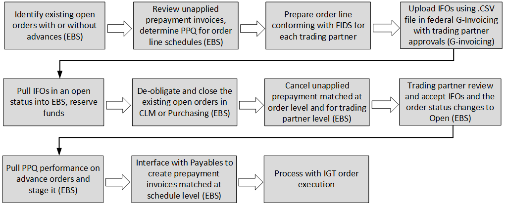

In-Flight Orders (IFO) or In-Process orders are existing intragovernmental orders that were created in the legacy systems before the agencies moved to G-Invoicing solution. These orders are not yet fulfilled or not completely delivered or performed by the agencies. The recommendation from treasury is to enter In-Flight Orders as replacement orders in G-Invoicing system.
The following diagram illustrates the process flow for nuyer-initiated orders maintained in both Oracle E-Business Suite and Federal G-Invoicing maintained orders:
Process Flow for E-Business and G-Invoicing Maintained (New Order)
Identify and compile the list of orders from the legacy system to move to the federal G-Invoicing application. After discussions with the requesting agency, the PMO office prepares and enters GT&C, order details including order lines, order line schedules, and associated PPQs for each in-flight order in the .CSV file (Treasury’s approved .CSV file standard). Refer to Treasury G-Invoicing User Guide for more details on the .CVS file standards.
You can upload in-flight orders to federal G-Invoicing using one of these methods:
Compiling .CSV bulk upload file
The trading partners divide open orders between advance-enabled and non-advance order categories.
Determine the PPQ (prepaid quantity) associated with each in-flight order by the unapplied prepayment amount.
Examine the quantity delivered, the quantity billed, and the quantity paid to determine the outstanding quantity at the order schedule level.
For current IFOs, determine and specify the FOB point using 2- or 3-way matching.
Uploading Orders Using the .CSV File Format
The order originating partner indicator determines if an order is a buyer-initiated order (requesting agency) or a seller facilitated order (servicing agency). The bulk in-flight orders are uploaded into the G-Invoicing system by the requesting or service agency as replacement orders for undelivered quantities. (Navigation: In federal G-Invoicing, click Requesting Agency or Servicing Agency tab and then choose Order Upload).
The agency does the following after successfully compiling the list of intragovernmental orders with undelivered quantity and necessary details into the .CSV file:
For BIO:
If the order originating partner is set to requesting agency, then the requesting agency may initiate and uploads the .CSV bulk in-flight orders to federal G-Invoicing (Navigation: In federal G-Invoicing, select Requesting Agency and click Upload). Browse, select a file, and click upload.
Once in-flight orders are uploaded successfully to federal G-Invoicing and approved, the requesting agency shares the file with the servicing agency for approval.
The servicing agency receives an email notification with the .CSV file link.
The servicing agency enters required parameters and uploads the completed file to federal G-Invoicing. (Navigation: In federal G-Invoicing, select Servicing Agency and click Order Upload).
After the file is successfully uploads, the IFO order status changes to Open.
The requesting agency can pull the order into Oracle EBS. The order interface and approval processes remain unchanged.
For SFO:

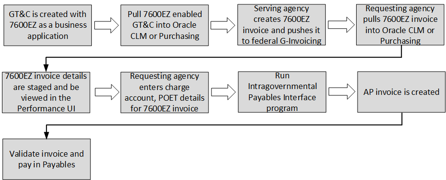

7600EZ Invoice Process Flow
The following is a summary flow of EZ invoicing support in EBS:
In federal G-Invoicing, set the business application (BizApp) feature flags to enable 7600EZ invoicing.
Pull the BizApps and BizApp features into Oracle CLM or Purchasing using the concurrent program, Intragovernmental BizApps and Features Interface Program.
Create a GT&C with the Business Application value of 7600EZ (under $ 10,000) in federal G-Invoicing and both the trading partners approve the GT&C.
The requesting agency pulls the created GT&C into Oracle CLM and Purchasing.
The servicing agency creates the EZ invoices and pushes it to federal G-Invoicing.
The requesting agency pulls these EZ invoices.
The system stages the EZ invoice details into the performance history table and appear in the IGT performance page with performance type as EZ Invoice.
The requesting agency enters the charge account, POET details for the EZ invoices.
The requesting agency runs the intragovernmental payables interface program to interface the 7600EZ invoices to Oracle Payables.
The Payables invoice is created and the EZ Invoice is settled.
The invoice is validated, accounted for and paid.
