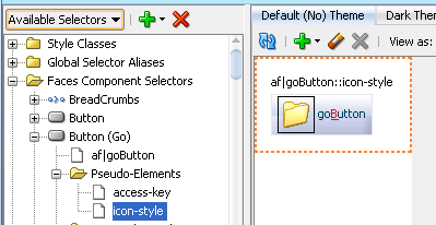

Figure 5-2 goButton Component Default Appearance with Fusion ADF Skin
Button (Go) Component Default Appearance with Fusion Skin
Figure 5-3 shows the appearance of the component after you set values for the following pseudo-elements on the component's selector:
Figure 5-3 goButton Component with Modified Selectors
Button (Go) Component with Modified Selectors
Reference information about the selectors that ADF Faces components expose can be found in the Oracle Fusion Middleware Tag Reference for Oracle ADF Faces Skin Selectors (for the release that pertains to the application you are skinning).

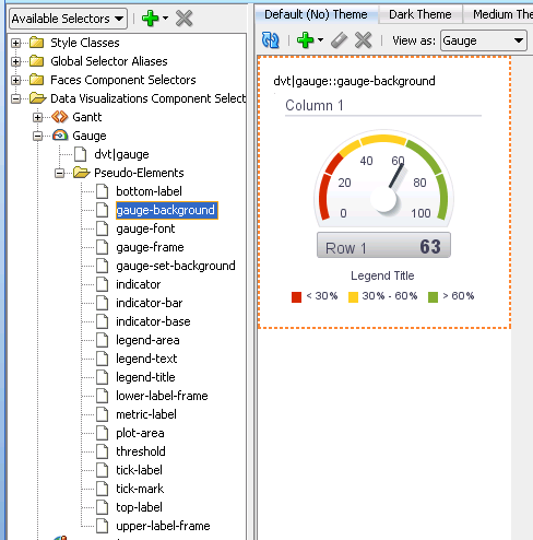

The ADF Data Visualization components are a set of components that provide functionality to represent data in graphical and tabular formats. Examples of the ADF Data Visualization components include the following: graph, gantt, pivot table, and hierarchy viewer. For more information about ADF Data Visualization components and the functionality that they provide, see the Oracle Fusion Middleware Web User Interface Developer's Guide for Oracle Application Development Framework (for the release that pertains to the application you are skinning).
You can change the runtime appearance of ADF Data Visualization components by editing the properties that each ADF Data Visualization component selector exposes. The number of selectors exposed by an ADF Data Visualization component varies by component.
Figure 5-4 shows an ADF skin with the nodes expanded to show the selectors that you can customize for the ADF Data Visualization gauge component.
Figure 5-4 ADF Data Visualization Component Selectors
ADF Data Visualization Component Skinning Keys

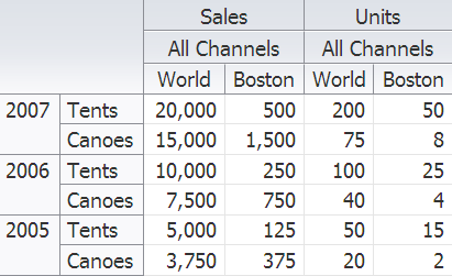

You customize the appearance of ADF Data Visualization components by defining style properties for the selectors that each ADF Data Visualization component exposes. Using the tools provided by JDeveloper's visual editor for ADF skins or the ADF Skin Editor, you customize the appearance of the ADF Data Visualization components. For more information, see Chapter 3, "Working with the Oracle ADF Skin Editor."
To achieve the appearance you want, you need to become familiar with the selectors that the ADF Data Visualization component exposes, the global selector aliases that the component may reference and which are defined in the ADF skin that you extend when you create an ADF skin. You also need to become familiar with the component itself and how it relates to other components. For example, customizing the appearance of the ADF Data Visualization pivotTable component shown in Figure 5-5 requires you to define style properties for this selector's pseudo-elements. You may also need to modify the style properties for one or more of the global selector aliases that the ADF skin you extend defines.
Figure 5-5 ADF Data Visualization pivotTable Component
Skinning Keys for pivotTable Component

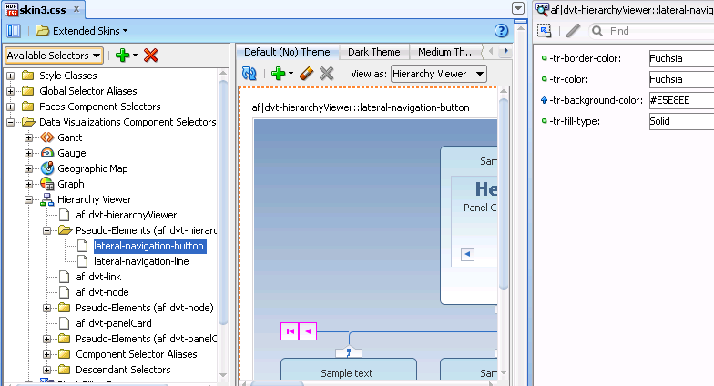

Many ADF Data Visualization component selectors, such as the selectors for the graph and hierarchyViewer components, expose pseudo-elements for which you configure ADF skin properties. These ADF skin properties modify the appearance of the area specified by the pseudo-element. The characters -tr- preface the names of ADF skin properties. For example, Figure 5-6 shows the properties of the hierarchy viewer's lateral-navigation-button selector, all of which are prefaced by -tr-.
Figure 5-6 Properties for the hierarchyViewer Component lateral-navigation-button Pseudo-Element
Hierarchy Component's lateral-navigation-button Properties

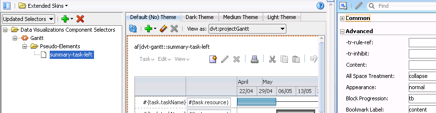

In contrast, the gantt component's summary-task-left selector, shown in Figure 5-7, exposes only two ADF skin properties (-tr-rule-ref and -tr-inhibit-) as the majority of the properties that you configure for this selector are CSS properties.
For more information about ADF skin properties, see Section 2.3, "Properties in the ADF Skinning Framework."
Figure 5-7 Properties for the gantt Component summary-task-left Pseudo-Element
Gantt Component's Skinning Key Properties

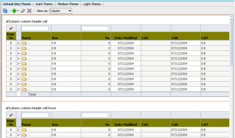

The visual editor displays the changes that you make to the selector after you click the Refresh icon in the Preview Pane. If you add a pseudo-class to the selector, the Preview Pane also displays an entry for the selector with the added pseudo-class. For example, Figure 5-10 shows an entry for a selector with the :hover pseudo-class added.
The Preview Pane for the af|document selector only displays one entry even if you add a pseudo-class to this selector.
Figure 5-10 Preview Pane with a Component Specific Selector and a Pseudo-Class
Preview Pane with a Selector and a Pseudo-Class

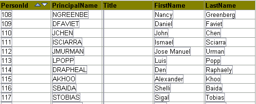

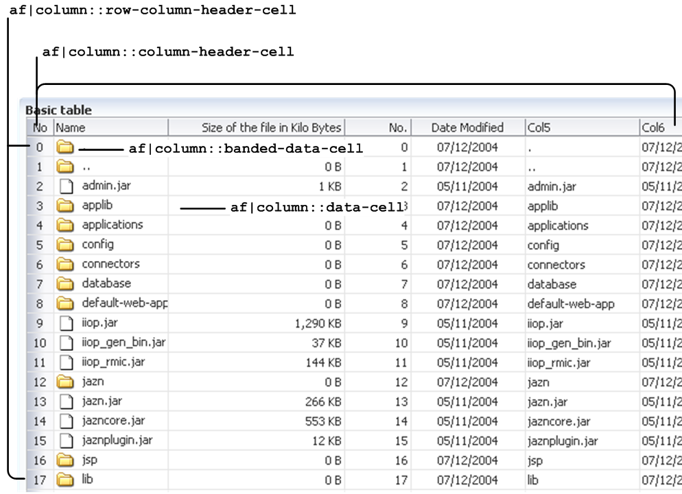

The visual editor also writes the values that you specify for the selectors in the Property Inspector to the source file for the ADF skin. Example 5-1 shows the changes that appear in the source file after making some of the changes described in Section 5.4.1, "How to Change a Component-Specific Selector."
Example 5-1 Selector Values to Skin the Header Row in a Column
af|column::column-header-cell
  color: Black;
  background-color: Olive;
  font-weight: bold;
When a web application uses an ADF skin that contains the values shown in Example 5-1, header rows in the columns of a table rendered by the ADF Faces table component appear as illustrated by Figure 5-11 where the table uses a skin that extends the simple skin.
Figure 5-11 ADF Faces table with a Header Row Skinned

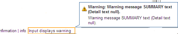

Figure 5-12 shows an inputText component rendered using the simple ADF skin. In Figure 5-12, the simple ADF skin defines style values for the :warning message property to apply to the inputText component when an end user enters values that generate a warning.
Figure 5-12 inputText Component Displaying Style for :warning Message Property
Input Text Component Displaying Style for Message Property

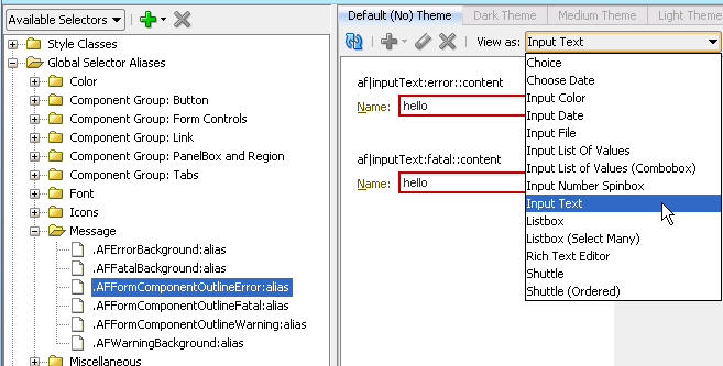

The ADF skinning framework defines a number of global selector aliases that define style properties to apply to messages. Figure 5-14 shows a list of global selector aliases under the Message node in the Selector Tree. The Preview Pane, on the right of Figure 5-14, shows how the style properties defined for the global selector alias currently selected in the Selector Tree render the component selected from the View as list.
Figure 5-14 Global Selector Aliases for Messages
You can customize the global selector aliases that the ADF skinning framework provides for messages by defining style properties in your ADF skin. The style properties that you define for the global selector alias affect all ADF Faces components that reference the global selector alias. For example, if you change the border color for the global selector alias shown in Figure 5-14 to green, all the ADF Faces components shown in the View as list render with a border that is green. For more information about global selector aliases, see Chapter 8, "Working With Global Selector Aliases."

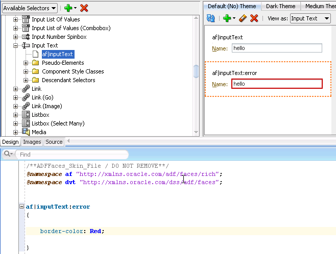

The visual editor writes the values that you specify for the selector's pseudo-class in the Property Inspector to the source file for the ADF skin. For example, assume that you set the value of the Border Color property to Red for the af|inputText selector's error pseudo-class. Figure 5-15 shows the change that appears in the source file and in the Preview Pane of the ADF skin.
Figure 5-15 Style Properties for an inputText Component's Error Message
Style Property for an Input Text Component's Error Message
If you want to define style properties to appear when the component displays an error message, use the error pseudo class. For example, set the content pseudo element's background color property for the af:inputText component's to Red when an error occurs as follows:
af|inputText::content:error
  background-color:Red

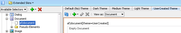

You can also create your own theme by entering syntax similar to the following in the source file of an ADF skin:
af|document[theme=UserCreated] {}

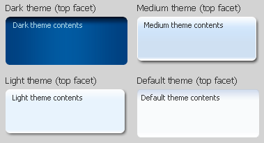

Figure 5-16 shows how the visual editor renders tabs where you can configure style properties for each theme provided by the Fusion ADF skins in addition to a user-created theme.
Figure 5-16 Tabs in the Visual Editor for Themes
Visual Editor Theme Tabs
Figure 5-17 shows how the different themes contrast to each other.
Figure 5-17 Default Appearance of Themes

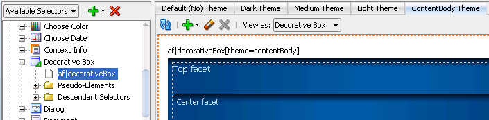

In addition to the themes listed previously, there is one other theme (contentBody) that the af|decorativeBox selector uses, as shown in Figure 5-18. The af:decorativeBox component is the only component that ever renders using the style properties defined for this theme.
Figure 5-18 Themes for the decorativeBox Selector

    Example 5-3 shows the entry that appears in the source file of an ADF skin if you set the background-color property of the af:panelTabbed component's dark theme to Red.
    Example 5-3 Defining a Theme for a Component in an ADF Skin
    af|panelTabbed[theme="dark"] {
        background-color: Red;
5.6.3 How to Prevent a Component Inheriting a Theme from a Parent Component
If you do not want a child component to inherit modifications made to a parent component in a JSF page, set a value for the -tr-children-theme property in the source file of the ADF skin. For example, you do not want the af:panelTabbed child component to inherit the dark theme defined for the af:document parent component in the JSF page. Set the -tr-children-theme property in the source file for the ADF skin as shown in Example 5-4.
Note that if you do not want a component to inherit modifications for a specific theme, you must specify the themed version. In Example 5-4, this is the dark theme. If you wanted to prevent the inheritance of modifications for the medium theme, you also set the -tr-children-theme property in the source file for the medium theme.
Example 5-4 Child Component Preventing Inheritance of a Theme from a Parent Component
    -tr-children-theme: default;
