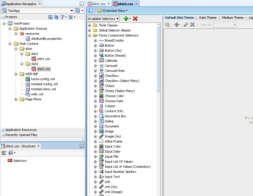

4.4.3 What Happens When You Create an ADF Skin
If you accepted the default value proposed for the Directory field, a file with the extension .css is generated in a subdirectory of the skins directory in your project. This file is opened in the visual editor for the ADF skin, as illustrated in Figure 4-1.
Figure 4-1 Newly-Created ADF Skin
ADF Skin File in JDeveloper
The trinidad-skins.xml file is modified to include metadata for the ADF skin that you create, as illustrated in Example 4-1.
Example 4-1 trinidad-skins.xml File

4.7.2 What Happens When You Import an ADF Skin from an ADF Library JAR
The ADF skin(s) that you import from the JAR file appear in the Extends list when you create a new ADF skin, as described in Section 4.4, "Creating an ADF Skin File." After you create a new ADF skin by extending an ADF skin that you imported from a JAR file, the Extended Skins list in the Preview Pane displays the name of the ADF skin that you imported. For example, in Figure 4-2 the skin2.css ADF skin has been created by extending the ADF skin, jarredskin.css, that was imported into the project from a JAR file.
Figure 4-2 Imported ADF Skin in the Extended Skins List
Properties that have been defined in the ADF skin that you imported appear with a blue upward pointing arrow in the Property Inspector. An information tip about the inheritance relationship displays when you hover the mouse over the property, as illustrated in Figure 4-3.
Figure 4-3 Property Inherited from an Imported ADF Skin
