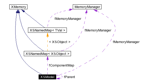

XSModel Class ReferenceInheritance diagram for XSModel:
[legend]Collaboration diagram for XSModel:
[legend]List of all members.
