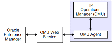

Figure 2-1 shows the communication between the various components of the OMU Connector.

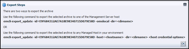

Click on the OMU connector to select it, then select Export from the Actions list.
A pop-up window, like the example shown in Figure 2-2, appears with the command required to export the file.
Open a command window on the Operations Manager host system and navigate to a temporary directory where you can copy the file.
Log into EM CLI using the following command. You will be asked to provide the password information for the sysman account.
emcli login -username=sysman
EM CLI must be executed from the OMS server system. See the Oracle Enterprise Manager Command Line Interface for information about setting up EM CLI.
Run the EM CLI export_update command from your system, changing <dirname> to the full path of the temporary directory.

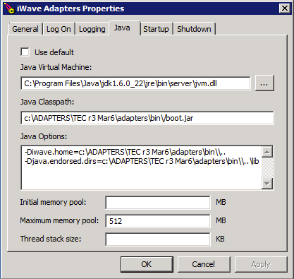

If the web service will be run using a 64-bit JRE, perform the following substeps to configure the service to use the 64-bit JRE:
In the adapters\bin
directory, double click the iWaveAdaptersw.exe
file. This will cause the iWave Adapters Properties window to be displayed.
Click the Java tab. The Java tab will be displayed that shows the JVM settings as shown in Figure 2-3.
Uncheck the Use default check box if it is checked.
Click to open the Select Java Virtual Machine DLL window.
Navigate to the jvm.dll
file in the 64 bit JRE installation directory and click Open.
Click OK.
The web service framework is now installed and ready to start.
