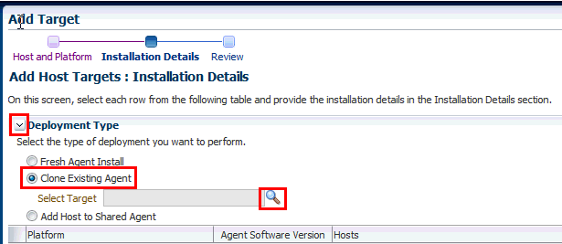

  • In graphical mode, you use the Add Host Targets Wizard that is accessible from within the Enterprise Manager Cloud Control console. The wizard enables you to select a source Management Agent, which you want to clone, and identify one or more remote hosts on which you want to clone it.
    The wizard first copies the source Management Agent image to the host on which Oracle Management Service (OMS) is running, and then, it transfers that copied image to the destination hosts. Although the wizard can be used for remotely cloning one, single Management Agent, it is best suited for mass-deployment of Management Agents, particularly while mass-deploying Management Agents of different releases on hosts of different platforms.

  • (Only for Graphical Mode) The Add Host Targets Wizard converts an unmanaged host to a managed host in the Enterprise Manager system by cloning an existing Oracle Management Agent.

  • (Only for Graphical Mode) Using the Add Host Targets Wizard, you can clone only when the source host (from where you are cloning the Management Agent) and the destination host are running on the same operating system. Therefore, if you have hosts running on different platforms, then you must have one deployment session per platform.

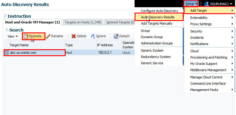

  1. In Cloud Control, do one of the following:
    • From the Setup menu, select Add Target, and then, click Auto Discovery Results. On the Auto Discovery Results page, select a host you want to monitor in Enterprise Manager Cloud Control, and click Promote.
      Surrounding text describes add_host_wiz_auto_disc_res.jpg.
      Enterprise Manager Cloud Control displays the Add Host Wizard, where you can select the option to clone an existing Management Agent.

  3. On the Installation Details page, do the following:
    1. In the Deployment Type section, select Clone Existing Agent. Then, for Select Target, click the torch icon and select the Management Agent you want to clone.
      • Ensure that you do not use the central agent (that is, the Management Agent installed on the OMS host) as the source Management Agent.
      • If you have multiple hosts sharing a common mounted drive, then install the Management Agents in two different phases:
        1. In the Add Host Targets Wizard, select the deployment type Clone Existing Agent, and clone the Management Agent to the host where the drive is shared.
        2. In the Add Host Targets Wizard, select the deployment type Add Host to Shared Agent, and install a Management Agent on all other hosts that access the shared, mounted drive. (Here, you will select the Management Agent you cloned in the previous step as the master agent or shared agent.)
      Figure 7-2 describes this step.
      Figure 7-2 Cloning a Management Agent
      Description of Figure 7-2 follows
      Description of ''Figure 7-2 Cloning a Management Agent''
    2. From the table, select the first row that indicates the hosts grouped by their common platform name.
      Surrounding text describes add_host_wiz_inst_details_clone.jpg.

7.5 After Cloning a Management Agent
After cloning a Management Agent, follow these steps:
  1. (Only for Graphical Mode) Verify the installation on the Add Host Status page. Review the progress made on each of the phases of the deployment operation — Initialization, Remote Prerequisite Check, and Agent Deployment.
    In the Add Host Targets Wizard, after you click Deploy Agent to install one or more Management Agents, you are automatically taken to the Add Host Status page.
    If you want to view the details or track the progress of all the deployment sessions, then from the Setup menu, select Add Target, and then, click Add Targets Manually. On the Add Targets Manually page, select Add Host Targets and click Add Host Results.
    If a particular phase fails or ends up with a warning, then review the details provided for each phase in the Agent Deployment Details section, and do one of the following:
