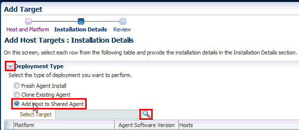

In the Deployment Type section, select Add Host to Shared Agent. Then, for Select Target, click the torch icon and select the Management Agent that is shared and mounted. This location must be visible on all remote hosts.
Figure 8-2 describes this step.

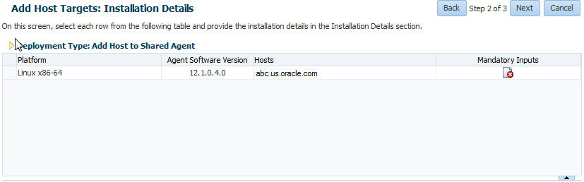

From the table, select the first row that indicates the hosts grouped by their common platform name.

For Privileged Delegation Setting, validate the Privilege Delegation setting to be used for running the root scripts. By default, it is set to the Privilege Delegation setting configured in Enterprise Manager Cloud Control.
For example, you can specify one of the following for the Privileged Delegation Setting field:
/usr/bin/sudo -u %RUNAS% %COMMAND% /usr/bin/sudo -u -S %RUNAS% %COMMAND% (if a pseudo terminal is required for remote command execution via SSH) /usr/bin/sesu - %RUNAS% -c "%COMMAND%" /usr/bin/pbrun %PROFILE% -u %RUNAS% %COMMAND% /usr/bin/su - %RUNAS% -c "%COMMAND%"
If you leave the Privileged Delegation Setting field blank, the root scripts will not be run by the wizard; you will have to run them manually after the installation. For information about running them manually, see Section 8.5.
This setting will also be used for performing the installation as the user set in the Run As attribute of the selected Named Credential if you had set the user while creating that Named Credential.
In the Privilege Delegation setting, the%RUNAS% is honored as the root user for running the root scripts and as the user set in the Run As attribute of the Named Credential for performing the installation.For Port, accept the default port (3872) that is assigned for the Management Agent to communicate, or enter a port of your choice.
The custom port you enter must not be busy. If you are not sure, you can leave it blank. Enterprise Manager Cloud Control automatically assigns the first available free port within the range of 1830 - 1849.
(Optional) In the Optional Details section, enter the absolute path to an accessible location where the preinstallation and postinstallation scripts you want to run are available. Note that only one preinstallation or one postinstallation script can be specified.
If you want to run the script as root, then select Run as Root. If the script is on the host where OMS is running and is not on the host where you want to install the Management Agent, then select Script on OMS. In this case, the script will be copied from the OMS host to the destination hosts, and then run on the destination hosts.
(Optional) For Additional Parameters, enter a whitespace-separate list of additional parameters that you want to pass during the installation. For a complete list of supported additional parameters, see Table 8-2.
For example, if you want to provide the inventory pointer location file, then enter -invPtrLoc followed by the absolute path to the file location. However, this parameter is supported only on UNIX platforms, and not on Microsoft Windows platforms.
Repeat Step 3 (b) to Step 3 (h) for every other row you have in the table.
Click Next.
On the Review page, review the details you have provided and if you are satisfied with the details, then click Deploy Agent to install the Management Agent.
If you want to modify the details, then click Back repeatedly to reach the page where you want to make the changes.
When you click Deploy Agent and submit the deployment session, you are automatically taken to the Add Host Status page that enables you to monitor the progress of the deployment session.
