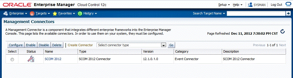

The connector instance shows up as unconfigured in the Connector Setup page. Figure 3-1 shows an unconfigured SCOM 2012 connector instance.

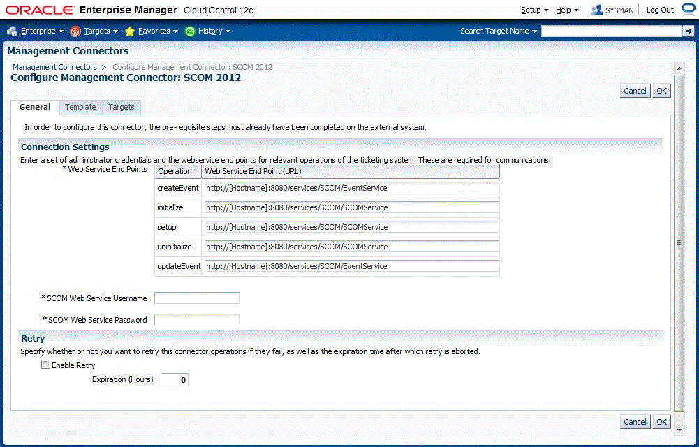

The General tab of the Configure Management Connector page appears, as shown in Figure 3-2.
Provide the required settings. See Providing General Settings for details.

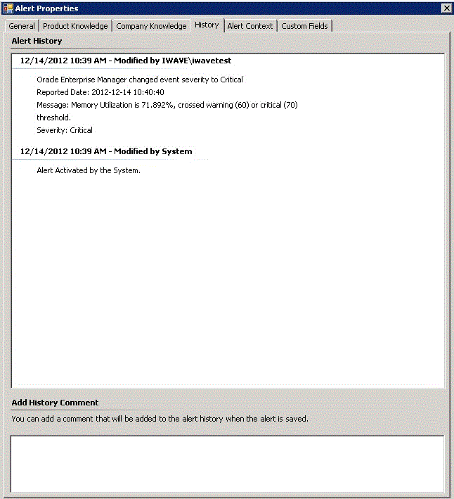

When the connector is operating in the Update-Only mode of operation, it creates a single alert that is updated each time an event severity change occurs in Enterprise Manager. Each time the event severity changes in Enterprise Manager, a new entry is added to the alert history log in SCOM 2012 that contains the updated information. The severity of the alert remains unchanged in SCOM 2012. This is the default mode of operation.

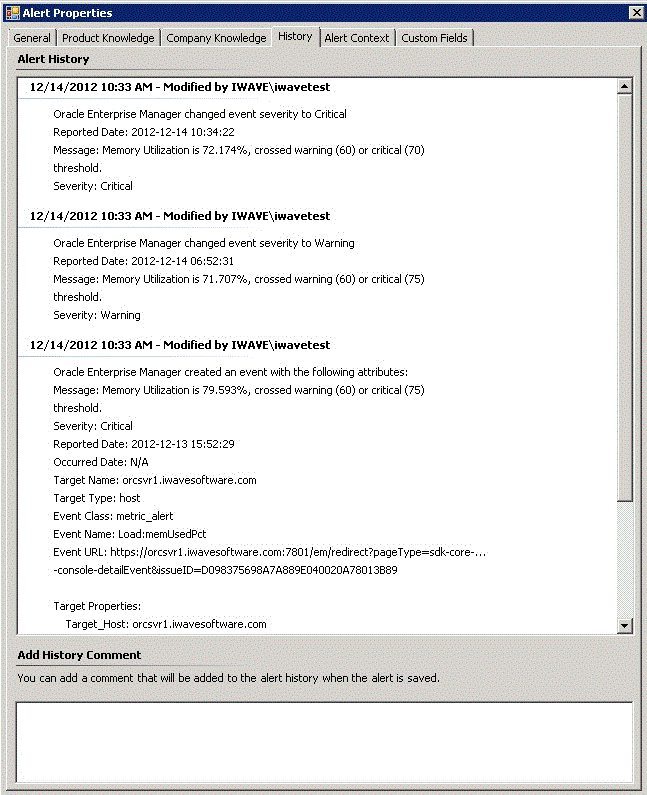

When the connector is operating in the Create-On-Update mode of operation, it creates a new alert in SCOM 2012 whenever a severity change occurs for the associated event in Enterprise Manager. The new alert has the correct severity and has the latest information in the description and title fields. Once the event clears in Enterprise Manager, all of the associated alerts in SCOM 2012 are closed.

There is an alternate template defined in the connector that must be installed for the updateEvent operation to switch from the default Update-Only mode to the Create-On-Update mode. By default, the alternate template will synchronize the history log information when a new event severity is sent from Enterprise Manager. This means that the history log in the new alert will include an entry for the original alert created and an entry for each update that has occurred up to that point in time. Also, the history log of the original alert will include an entry for the original create and one for each update as well. Figure 3-3 shows an example of the history log for the new alert when the default synchronization feature is enabled.
If synchronization of the logs is not desired, the alternate template has a flag that can be changed to disable the synchronization feature. When the feature is disabled, the original alert will just have information about the original create but will not include any update entries. Also any new alerts that are created will just have a single entry for the update associated with that alert. Figure 3-4 shows an example of the history log for the new alert when the synchronization feature has been disabled.

The SCOM connector communicates with Microsoft SCOM through the SCOM adapter installed as described in Installing the Microsoft SCOM Web Service. All fields are mandatory.
Web Service End Points – URL to use when performing event operations that require interaction with the SCOM adapter. The adapter uses two different URLs depending on the operation being performed. One URL is used for the registration of the SCOM Agent with Microsoft SCOM (setup, initialize, and uninitialize operations), and defaults to the following value:
http://[Hostname]:8080/services/SCOM/SCOMService
The other URL is used to create/update alert information in SCOM (createEvent and updateEvent operations), and defaults to the following value:
http://[Hostname]:8080/services/SCOM/EventService
Modify the URL for the operations based on whether the SCOM web service was set up using HTTP or HTTPS.
Replace [Hostname] in the URL with the hostname or IP address of the system where the SCOM adapter was installed.
Change the protocol from http to https.
Change the port number from 8080 to 8443.
If the SCOM web service was installed on a system with a hostname of scomws, the following URLs would be configured for the createEvent and updateEvent operations.
For HTTP:
http://scomws:8080/services/SCOM/EventService
For HTTPS:
https://scomws:8443/services/SCOM/EventService
SCOM Web Service Username - User name that was configured for accessing the SCOM adapter in step 9 of the appropriate web service installation section (Installing the Web Service on Unix and Installing the Web Service on Windows)
SCOM Web Service Password - Password that was configured for accessing the SCOM adapter in step 10 of the appropriate web service installation section (Installing the Web Service on Unix and Installing the Web Service on Windows).
You can enable and disable the Retry option and configure its interval value. The Retry section, available on the connector configuration page, enables you to specify whether failed operations need to be retried within a configurable expiration time.
When you enable the Retry option, you can specify whether you want to resend a Create or Update request if the request fails the first time, and specify the time period (greater than 0) after which you want to abandon the retry. Enterprise Manager retries every five minutes until the request is successful or the retry interval expires.
By default, the Retry is disabled. This setting applies to all events that the SCOM Connector processes. The retry period interval accepts the number of hours as any integer value. For example, 1 or 2.

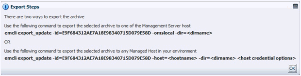

A popup window appears with the command required to export the file. See Figure 3-5 below for an example of the pop-up window.
Open a command window on the Management Server host machine and navigate to a temporary directory where the file can be copied.
Log in to emcli using the following command. You will be asked to provide the password information for the Super Administrator account.
emcli login -username=<Super Administrator>
Run the emcli export_update command from your system, changing <dirname> to the full path of the temporary directory.
A zip file will be created. The file name will be comprised of the id value specified in the export_update command with a .zip extension.
