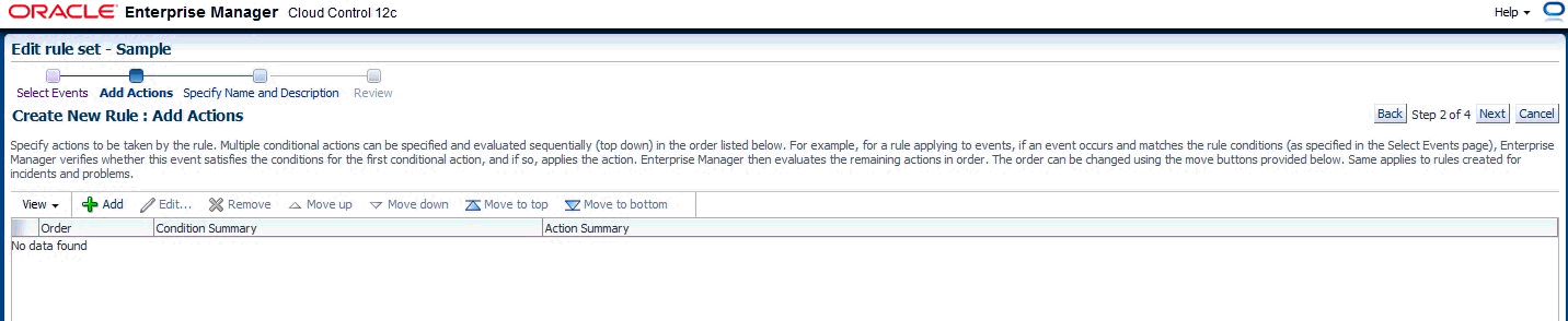

Specify the set of events that you want to forward, then click Next. The Add Actions page is displayed as shown in Figure 4-1.

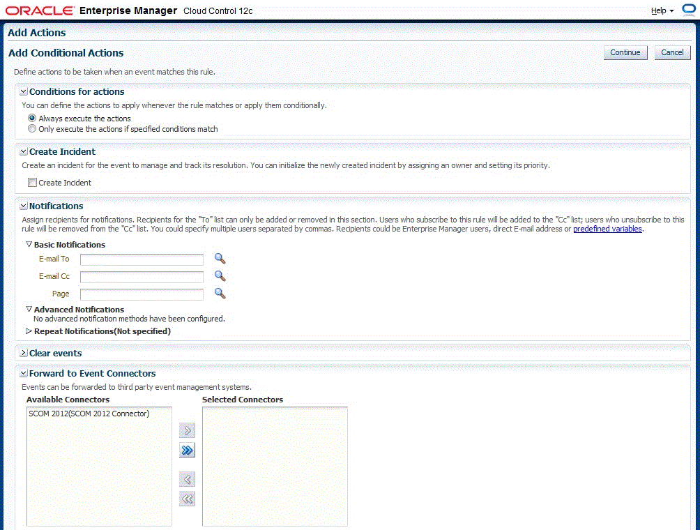

Click Add. The Add Conditional Actions page is displayed as shown in Figure 4-2.
Select the appropriate SCOM connector instance in the Forward to Event Connectors section then click >, then click Continue. The Add Actions page is displayed again with the new action listed.

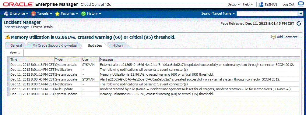

In Enterprise Manager, the event is annotated with a comment on the Updates tab to indicate that an event in SCOM has been created or updated as seen in Figure 4-3.

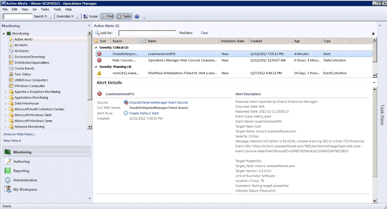

After the event has been sent to SCOM, you can view it in the Microsoft SCOM console, as shown in Figure 4-4. Full details of the event are sent to SCOM including:
Event class and name.
Target type and name.
Message.
Severity.
URL to the Enterprise Manager event details page.
To view the event in Enterprise Manager, copy the URL listed in the event and paste in the address bar of a browser. You will be asked to log in to Oracle Enterprise Manager. After logging in, the Oracle Enterprise Manager event information is displayed.
