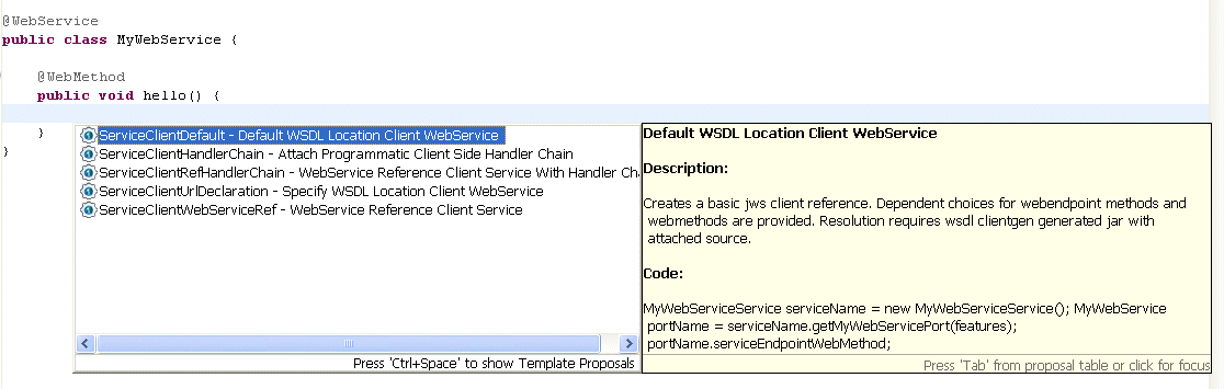

You insert a code snippet as follows:
- Within your Web service project, open a Java file to which you want to add the code.
- Place the cursor at a particular location, and then press Ctrl+Space. This opens a descriptive list of titles of the code snippets available for your code, as Figure 1 shows. To display a detailed description and the snippet itself, select an item from the list.
Figure 1. Adding a Code Snippet
- Double-click the snippet title to insert it in your code.
