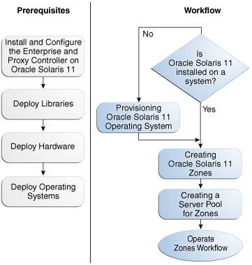

The left side of Figure 1 indicates prerequisite tasks and workflows. Before you begin this workflow, ensure that Oracle Enterprise Manager Ops Center is installed and configured on an Oracle Solaris 11 operating system, that your libraries are deployed and configured, and that your hardware and operating systems are discovered and managed in the software.
The right side of Figure 1 is the workflow for how to deploy Oracle Solaris 11 zones. Zones require an Oracle Solaris operating system. You can use an existing system, or provision an operating system. This workflow includes tasks to create Oracle Solaris 11 zones, and then create a server pool to efficiently manage the zones. The end of the workflow is to view the Oracle Enterprise Manager Ops Center Operate Zones Workflow.
If you plan on provisioning or updating Oracle Solaris 11, the Enterprise Controller and a Proxy Controller must be installed on Oracle Solaris 11. For provisioning, the Proxy Controller must be on the same subnet as the assets being provisioned.Figure 1 Deploy Workflow for Oracle Solaris 11 Zones
