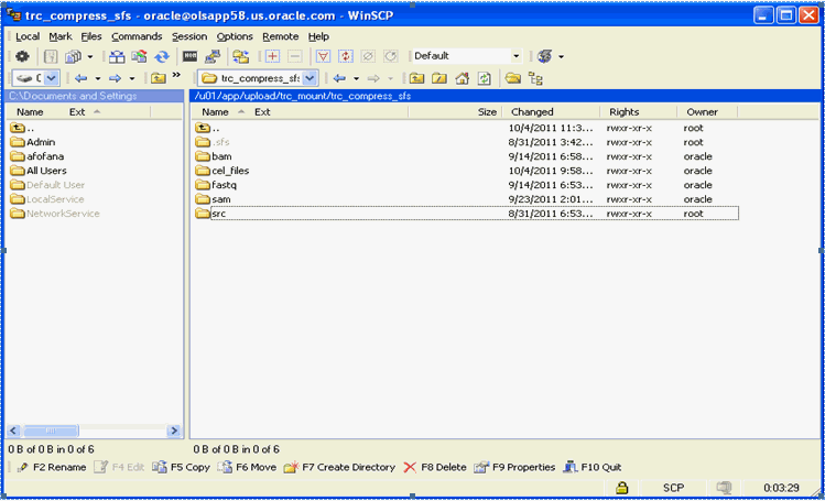

At this point, DBFS is already functioning. You can access the files system by using dbfs_client directory utilities even without mounting the DBFS to the operating system directory.

Using a Graphical Interface to Access the Mounted Secure Directories
You can also use any third party user interface to access the Secure Directory giving the appropriate permeations as you would in an operating system based files system. The following example utilizes WinScp to access the mounted secure mount point (/u01/app/upload/trc_mount/trc_compress_sfs) and its content directories as shown below:
Figure 4 Graphical Interface to Access Directories
You can drag and drop your selected files into the target directory with ease. All relational database capabilities and file management features are automatically applied with no further action on your part.
