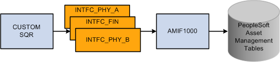

Converting with a Customized SQR
To transfer data from an existing system into PeopleSoft Asset Management loader tables, you can write a custom SQR and use the delivered Asset Management application engines in this way:
Write and run a program that transfers data from the existing system into the Asset Management loader tables.
The following table describes the interim tables in Asset Management:

Run the Transaction Edit program (AMIFEDIT) to perform edit checks on the specified data fields to ensure that the information you load into PeopleSoft Asset Management is correct. The data fields that are edited include ChartFields, business units, and books.
Preview and approve data in the loader tables.
Use the Financials Transactions page, Physical Transactions A page, and Physical Transactions B page to see which data was loaded into the loader tables.
Use the Transaction Loader process (AMIF1000) to transfer information from the loader tables into your Asset Management tables.
This process reads data in the INTFC_FIN, INTFC_PHY_A and INTFC_PHY_B tables and then populates the Asset Management tables with the asset data. This data appears in Asset Management as open transactions.
The AMIF1000 process has two options for populating open transaction accounting and transaction date fields with respect to how costs and accumulated depreciation are loaded. Search for RJS2-34 in AMIF1000 and choose the option that matches your business needs before running the program.
Convert and depreciate the assets.

The following diagram shows the Asset conversion process:
