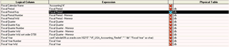

Date-Fiscal Calendar
Date-Fiscal Calendar in physical layer must be mapped to Dim-Date Fiscal Calendar in the logical layer. The mappings of Date-Fiscal Calendar Dimension are show below:
This screen shot displays how the Date-Fiscal Calendar in the logical layer must be mapped to Dim-Date Fiscal Calendar in logical layer.
The Fiscal year attribute must be shown in the Expression column of the preceding figure. Here, VF_USA_Accounting_Flexfied is the name of the cube. In addition, the Fiscal Calendar Name should be determined as explained in section Balance Fact–Modeling and typed in as well.

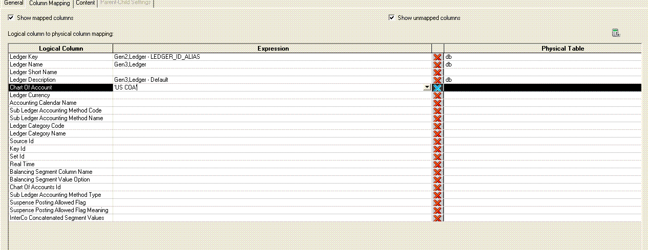

Ledger and Ledger Set
Ledger Dimension attributes are mapped to Dim-Ledger and Dim-Ledger Set in the Business Model and Mapping layer. Ledger dimension mapping is shown below:
This screen shot displays how Ledger Dimension attributes are mapped to Dim - Ledger and Dim - Ledger Set in the Business Model and Mapping layer. Ledger.

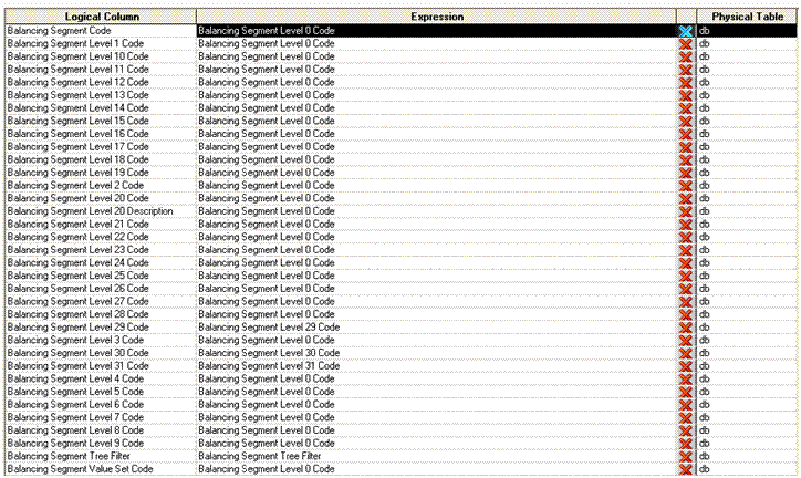

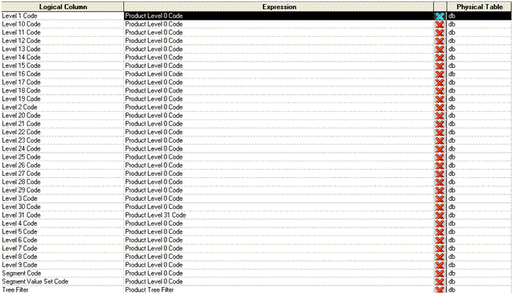

Segment Dimensions
The mapping starts from the top level in the Essbase Dimension hierarchy to the Business Model and Mapping layer. For example, in the Business Model and Mapping layer:
  • XSegment Tree Filter attribute from the Essbase Dimension maps to the XSegment Tree Filter attribute
  • Level X Code attribute of Essbase Dimension maps to Segment Level Xcode
  • Balancing Segment Level 31 Code in Essbase Dimension maps to Balancing Segment Level 31 Code attribute
  • Balancing Segment Level 0 Code in Essbase Dimension maps to Balancing Segment Code attribute
  • XSegment Level 0 Code in Essbase Dimension maps to the Leaf level attribute X Segment Code
Because the Essbase hierarchy does not have 32 levels, and the Logical Dimension has 32 levels, the intermediate levels must be mapped to the Leaf level from Essbase hierarchy. This is true for all the segment Dimensions. For example, if the Essbase Dimension Hierarchy has Level 31 code, Level 30 code, Level 29 Code, and Level 0 Code, then all the Level 0 code of Essbase Dimension must be mapped to all the attributes from Xsegment Level 28 Code until Leaf level as shown in the figure below.

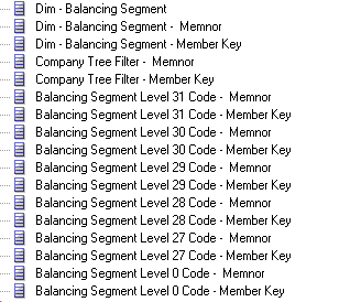

Balancing Segment in the Essbase cube should be mapped to Dim - Balancing Segment in the Business Model and Mapping layer also as shown below:
This screen shot displays how the Balancing Segment in Essbase cube should be mapped to Dim - Balancing Segment in the Business Model and Mapping layer.

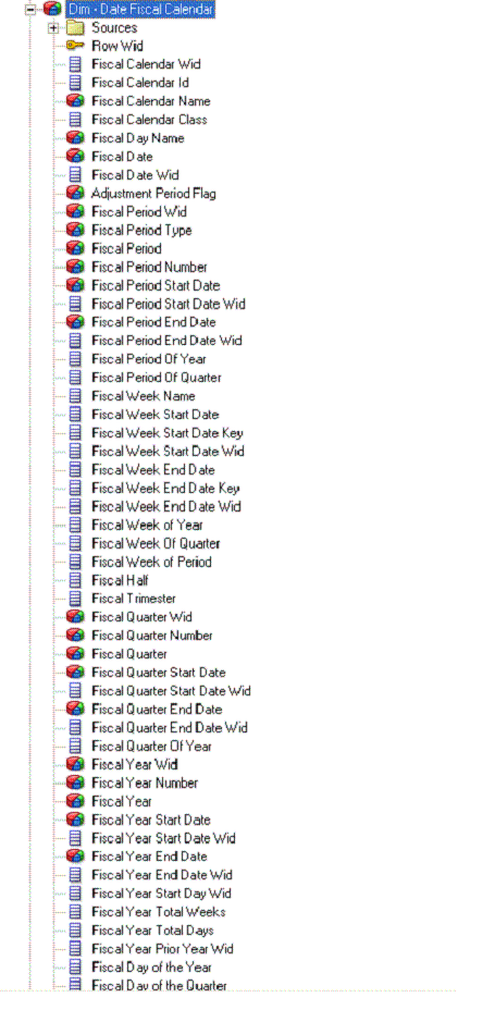

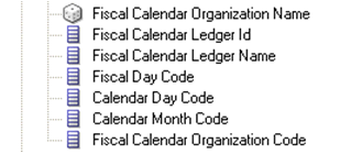

Because of dragging, within each mapped dimension, additional attributes were created. You must delete them as well as the attributes with names similar to Dim-X. XX-member, xx-Member Key should be deleted also.
For example, before dragging, Dim - Date Fiscal Calendar has the following attributes:
This screen shot is an example of a dimension with extra attributes.
This screen shot is a continuation of the example of a dimension with extra attributes.
However, after dragging, the following attributes are created and must be deleted:
This screen shot is an example of extra attributes created.

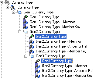

Currency Type Dimension Mapping
Because of dragging, a dimension Currency Type is created in the Business Model and Mapping layer apart from the existing Dim - Currency Type.
This screen shot is an example of New dimension currency type.

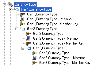

Also, a new hierarchy is created inside the existing Currency Type dimensions hierarchy and must be deleted.
This screen shot is an example of how a new hierarchy is created.
Attributes of Currency Type Dimension must be manually mapped. Gen2, Currency Type and Gen3, Currency Type (attributes) in the physical layer that are highlighted in the figure below must be mapped to Currency Type and Converted Currency Type attributes in Dim - Currency Type in the Business Model and Mapping layer.
Figure 31. Currency Type in Physical Layer
This screen shot is an example of the currency type attribute.
Figure 32. Currency Type in Logical Layer
This screen shot is an example of Currency Type in the logical layer.

Mapping to Chart Of Account Attribute
You must map the Essbase Logical Table Source (LTS) to Chart of Account attribute in Ledger Dimension for redirection in the fact.
To map the Chart of Accounts attribute, in the Column Mapping tab of Essbase LTS, enter <COA name> for the cube. This is the same name used in the Fact’s Fragmentation content. See step 3 under the section Balance Fact–Modeling.
This screen shot is an example of the column Mapping screen, Column Mapping tab, with Chart of Account selected in Logical Column.

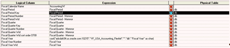

You must create additional mappings that need to be done in Dim - Date Fiscal Calendar for the proper redirection and federation to Essbase cube sources. Similar to the mapping for Chart Of Accounts attributes, you must do a few manual mappings for the Time dimension.
  To perform additional mappings for the time dimension:
  1. In the column mapping, for the Essbase cube LTS, the Calendar Name of the cube must be written directly. To obtain the Calendar Name of the cube, see The Business Model and Mapping Layer Changes.
  2. Drag the Fiscal Year attribute from the physical layer of the cube into the Fiscal Year Number and Fiscal Year Wid. You must enter and map Fiscal Year as shown below.
    This screen shot is an example of Fiscal year mapping.

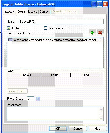

  To disable the BalancePVO source, perform the following steps:
  1. Double-click the BalancePVO LTS of Fact-Fins-Essbase Balance.
    This screen shot is an example of Fact – Fins – Essbase Balance selected.
  2. On the General tab, select Disabled and select OK. Disabled source BalancePVO is displayed as disabled.
    This is a screen shot of the Logical Table Source - BalancePVO window with the General Tab selected.
  3. Repeat previous steps for Dim-Amount Type and Dim-Currency Type to disable BalancePVO LTS as shown below.
