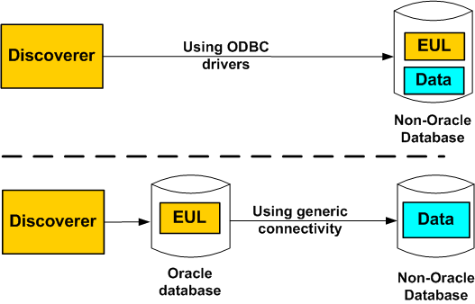

Figure 23-1 EUL location using ODBC drivers versus using generic connectivity
Surrounding text describes Figure 23-1 .
The above diagram illustrates the following:
  • when Discoverer connects to a non-Oracle database using ODBC drivers, both the EUL and the data reside on the non-Oracle database
  • when Discoverer connects to a non-Oracle database using generic connectivity, the data continues to reside on the non-Oracle database but the EUL must be located on the Oracle database
